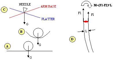

Quesions
Again, koefficient of friction is way lower than in the gimbal bearing, but the mass, i.e. total mass of the arm+slider+counterweight is substantial. As long as the needle is pressed against outer groove, the clockwise moment is produced, due to larger friction force on the outer groove (D), causing cantilever to bend even further. So we have sort of "amplifier" here.
The friction forces within the air gap is proportional to the square of airflow speed and to the contact area. As long the arm stays on place, the air flows evenly around the slider and friction forces are balanced on both sides of the arm. When the slider starts to move, the friction resistance is proportional to the square of air velocity delta, multiplied by the contact area, and may not be completely negligible. I think the strong side of the air bearing, besides its lower friction value, is that the friction force is absolutely smooth and linear, not like metal-to-metal contact of conventional bearing, which inevitably induces certain vibrations.
Have a look at the pictures. Ball (B) is more stable dynamically, than ball (A), so the stylus tip, positioned within the "walley"(C), as I suggested, is more stable on excentric record. Gravitation always forces it back to equilibrum. Note, that the side preload is stll there.I still don't get it
The only force to overcome is the friction between slider and rail.If I remember correctly from my physics class days you do NOT need a force to keep something moving at a CONSTANT speed.
Sorry, but I still don'tI still don't get it
The way I see it your drawings (A,B and C) would apply if the needle were on a grooveless smooth surface. NOT when the needle is in the groove (see pic)
This I really don't understandAs long as the needle is pressed against outer groove, the clockwise moment is produced, due to larger friction force on the outer groove (D), causing cantilever to bend even further. So we have sort of "amplifier" here.
Friction is NOT larger on the outer groove than on the inner.
Friction is INdependent of surface area, speed (except when v = 0), and temperature.
It only depends on the nature of the surfaces in contact and is directly proportional to the normal force. (in this case tracking force)
Just google around a little to see this is true.
So there will not be an inward force resulting from this.
But then what IS happening?

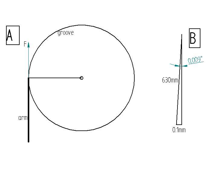

Again I am just thinking aloud here:
1. If the groove were a circle instead of a spiral the arm would not move. The only force on the needle is tangential to this circle (see A)
2. The groove is in fact a spiral, which means that the needle moves inward one groove width per revolution. It also means that the center of the part circle being played doesn’t coincide exactly with the center of the record. And this means you have tracking error.
And as we all know tracking error produces a skating force.
3.What remains is the question how serious this is.
A record does 33.3 rpm. If we assume a record side takes 20 minutes to play you will have had 20*33.3=666 revolutions. (1)
During this time about 70mm of the record surface has been traveled. (2)
Or 70/666= 0.1mm travel per revolution (3)
The length (L) the needle travels in one revolution is equal to the circumference of the groove at a given point on the record.
On the outside this is about 2pi*r = 6.28*150=940mm
On the inside this is about 6.28*70=440mm
Let’s assume we are somewhere in the middle at R=100mm. Then L=630mm. (4)
Now look at picture B (remember it is nowhere near to scale)
It now follows that a resultant skating force (Fs) will be equal to:
Fs= 0.1/630*Ffriction (Ff) or 0.00015Ff. (5)
Ff= u*Fn
Where u is the friction coefficient between needle and record and Fn is the Normal force which in this case is equal to tracking force.
Lets make Fn=0.02N (2gr tracking weight) (6)
I couldn’t find an adequate figure for u. I read somewhere that u for polymers and ceramics vary between 0.04 and 0.5. So lets assume for now that
u= 0.2 (7)
Then Ff= 0.02*0.2= 0.004N (8)
And since we saw that Fs = 0.00015*Ff we now know that
Fs = 0.00015* 0.004= 0.0000006N (9)
Is this something you can compensate?
Remember this is all about a perfectly flat and centric record with an unmodulated groove. Meaning that in real life it is ....
Is there some truth to all this or am I on the wrong track completely? Reactions please.

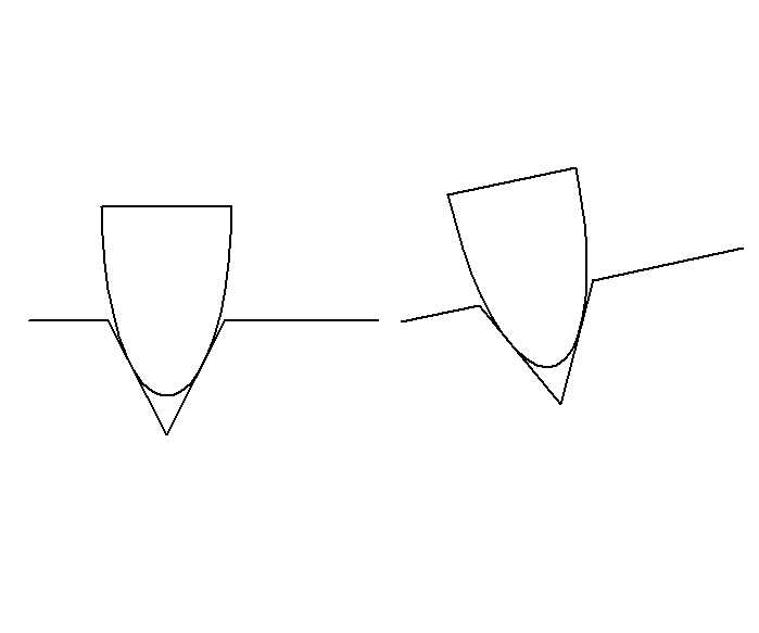

As far as the stylus is concerned it is reading a straight line.
The radius of the groove wall is so small that in real life no error will occur as the record itself was cut in this exact same way anyway.
The reason for using a tangential tonearm is mainly due to the fact that no tracking error can occur as the record is supposedly read as it was cut....
BUT this assumes a perfect LT which in reality is far more tricky to do than it would seem.
To see what happens when the arm can't keep up due to its own inertia just watch the cantilever when you lower the arm onto the lead-in groove.
