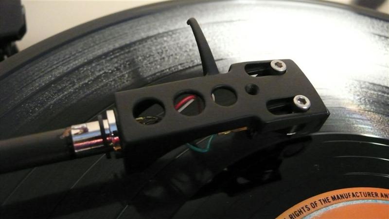

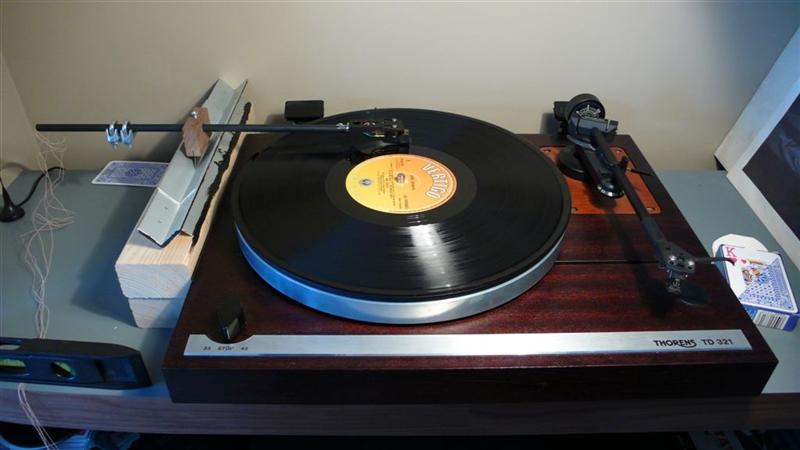

Hi All,
I now have my first prototype arm working! Thanks to Kvap9 for all the advice.
It's just sat next to my TD321 for now, but i have started my own TT based on some leftover walnut for the plinth, the Algar_emi / Mark Kelly dc motor kit and a VPI scout bearing and platter.
First impressions are very good, but i wanted to get some advice on what to try next.
I used some carbon for the tube and a cheap headshell glued to the end, see photo. I soldered the earth wire to the p mount connector on the headshell, but the hum is terrible when connected. What is the correct point to connect earth?
eventually i want to use an arm made from walnut and be one piece.
I was going to use an empty 1ltr plastic bottle for the surge tank, is this ok, or does it need to be very stiff?
Any other advice will be most welcome
Cheers
webby

Any ideas
Hi All,
I have finished the surge tank and this has smoothed the air supply very well.
But now i wanted some ideas on improving the sound quality, the first thing i noticed was a slight reduction in bass weight compared to my linn lvx plus. the prototype has much better channel separation and i love the consistent sound across the whole record.
what should i try first?

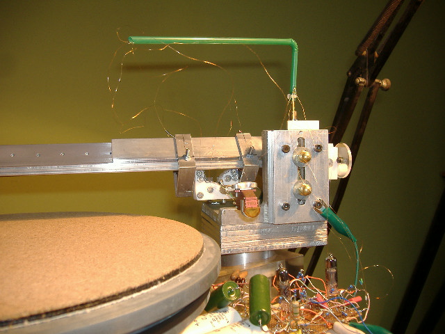

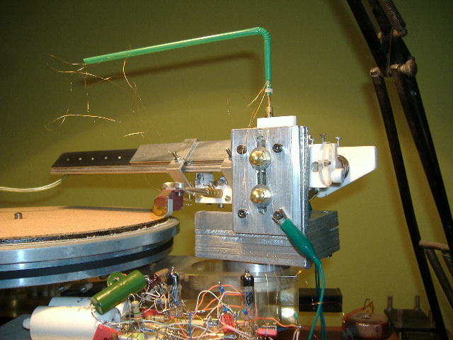

Hello,
Thanks for this thread.
This is my first arm.The most important in construction were cushion and blade rest.Aluminium angles must be mirror polished to get the thinnest air film on them what mean better bass and details.The blade rest must be harder than alu to get better details and 3-D.As allways ,that is my personal experience so check (hear) on your table first but the polish is must for better performance.
I'm interested in the path you've taken...including the phono stage...got a link?

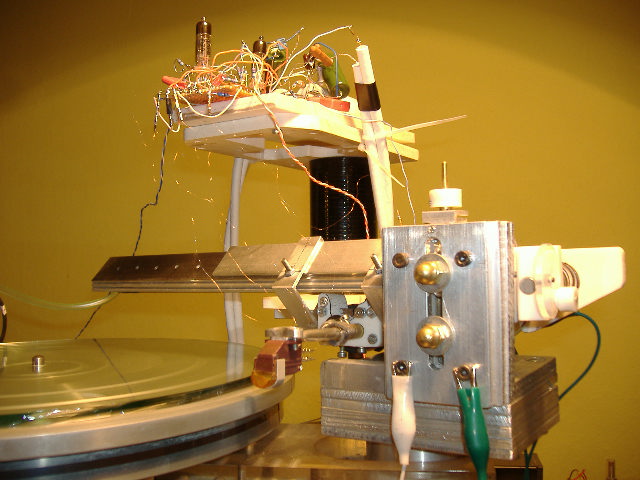

I will take photos of the disassembled arm these days as I am going to finish some fine details that I left unfinished because of listening rush.Everything is made on table drill machine without lathe assistance, only machining improvisation and hand saw.Precision of the on the fly VTA is great.The arm elevation is made by excenter screw on lower front nut.The lift is lateral instead of horizontal type so I could place him from the outside of the arm base because I don't like to mess with lift shaft in proximity of cartridge.Today I have placed blade on the glass tubes.Fantastic - another arm compared to alu rest version.I just brushed two miniature fuses on one end for 60° to be able of putting the blade on the end of the fuse.I was afraid that I will loose geometry precision but that didn't happened since the blades are self adjusted on the bottom of the tube because oh arm pivot gravity ant help of fine cosmetic hair oil. Mass of details came out of the records that I didn't ever heard with Morch dp6 and SME 3009.That part of the arm showed the most important necessity of right material choice.
Phono is 12ax7 based pre but I love subminiature sound and near no microfonic characteristic so I putted two 6n17b-v Russian tubes.
This is a new step,only 18 cm of 0,01 mm copper diameter to phono stage.Imagine the sound with the phono almost on the cartridge .My turntable enemy friend gave him a chance and listened it and hi said that it sound like a mega$ cd-player but without digititis.He sell every turntable after short period of listening.The wires are from an old MM cartridge and the carrier doesn't see them at all ,no more tension problems.As the wire is so thin I have used a RS-232 connector pins for connections.
