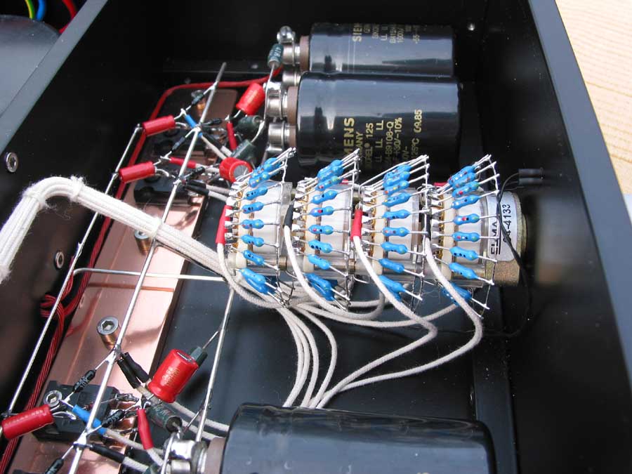

Well no I do not mean a fixed volume. I do not even recommend 12 steps as I think it is too little. What I meant was that the experiment with two resistors soldered in signal path show how important is quality of the switch connectors. I put the switch in with same two resistors and degradation is sound is clearly hearable. That is also why very often passive preamplifiers with stepped attenuator suck. Even if the impedance matching (which is rare for passive) is fine another cable, connectors and solder joints kill the sound.
I do not say there are no good switches. But for example Elma, not talking about it's sonics as I have never had another 4 deck switch to compare it to, did pops and clicks when switching even though it was meant to be make before brake version and was lubricated well. This was only in ladder type wiring obviously as series wiring never brakes ground connection. Another thing is one of my Elmas never used sitting in box parts for 5-6 years got the gold connectors totally oxidated, instead of gold they look like smoked bronze right now. I mention all of this becouse these are not cheap. The price point of around $200 for the 4 deck switch alone needed to wire ladder type for stereo RCA single ended connection I paid few years back is rather high and with good resistors jumps even higher. I have also had a local company custom made so called very high quality metal firm resistors made for me to my values specification to get the perfect ladder type steps. Extremely low tolerances and precision metal film resistors a the end appeard to be sonically quite inferior to cheap Vishay/Dales. That also tells something especially to those who only consider electrical parameters, it's not all about it, or proabably it is measurable but it's not about the simple basic parameters. I attach the photo of Elma with custom made resistors I made few years ago for some preamplifier.
I once had this idea to buy single deck 24 position switch and just make it to drive 48 relays. The relays could be pick out of many for sonics (easy made tests), so the resistors, all could be wired p-2-p with no odd PCB and it's unneeded connection and traces with high quality wiring, realays aligned one next to another soldered directly to signal wire in ladder type configuration where the realy would just switch in to "an open part of cable going to inside connectors" the right value of resistors for given loudness. Simple and no need for expensive switches, also flexible with personal choice of favourite realys and resistors. Never done that though, but I bought single deck 24 position Elma for that purpose at some point.
