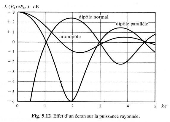

This makes the most sense to me. From the Book AUDIO by Mario Rossi, ISBN 978-2-88074-653-7 (in french) a nice graph illustrating this issues. The graph illustrates the acoustic power radiation into space by three types of acoustic radiators: A monopole (such as a boxed speaker), a dipole normal to the wall, and a dipole parallel to the wall. So dipoles are much more cricital than monopoles at lower frequencies.
It depends strongly on ke if the parallel or the normal dipole is the more powerful one at the distinct frequency. Forget about bass for a normal dipole at ke<=1.
Nota Bene: The terms "Normal" and "Parallel" relate to the radiation pattern of the dipole. So the a dipole speaker screen which is physically placed parallel to a wall results in a "Normal" dipole radiating pattern in relation to the wall.
This graph also explains why it is wise to toe in dipole speakers by 30°... 45° in relation to the surrounding, vertical walls of the room: Toeing in will partially and mutually cancel out the both parallel and normal, antilogic radiation effects.
