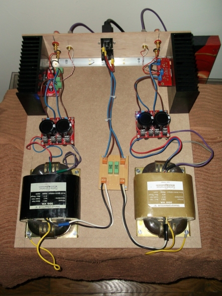

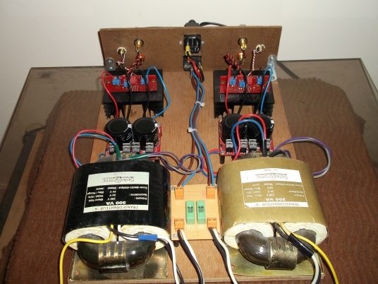

I dig out this thread at the point where I left it 2 years ago:
- I changed the 2x100 µF Panasonic by a single 330 µF "Black Gate", the result was more detailled mids and trebles, but bass had disappeared .....,
- so I tried 2x100µF + 330µF and I finally got the fine sound of the BG and the strong bass of the Panasonics.
I still was not completly satisfied, but the sound was good enough for I decide to build a box for that amplifier.
After the box was built, I stopped working on the amp for a long time.
Four months ago I decided to try other changes. I have made a new PSU, very simple P2P, with 2x15000 µF on each rails.
After a few Hours (20) of operation, I just could not believe my ear: a fantastic overall upgrade ! Open sound, Mid, Bass, soundstage, everything was significantly better. I am discovering all my Cds...
The most important points of that built were (8 ohm speakers):
- double mono Brian GT kit with :
- 300 VA tranfo 2x24 V AC,
-2 x 15000 µF / rail (first try with 10000 µF /rail),
- 2x530 µF / rail on board (first try with 100µF / rail),
- 1°/W heatsink.
Some photos are available here:
http://www.diyaudio.com/forums/chip-amps/79303-chip-amp-photo-gallery-237.html#post3371038
Bye.
