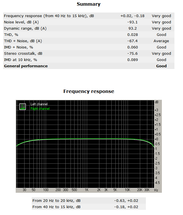

My chipamp is based on the BrianGT schematic and has the optional 47uF feedback capacitor fitted. Attached is the RMAA test of the frequency response. I'd have to look up the datasheet to see what the calc is for determining the -3db frequency (due to the feedback cap) is, but as can be seen the FR is down around 0.6db at 20Hz. Whether this is enough to be noticeable or not I don't know.
When I did power tests I did get quite significant droop in the PS at frequencies below 30Hz. I'm running a single 300VA dual 20V toroid, giving around 28V rails unloaded.
edit: ok for 680 ohm Ri and 47uF ci forumla is fc = 1/(2πRi Ci) which works out at about 5Hz. Increasing the size of Ci will lower the -3db point.
