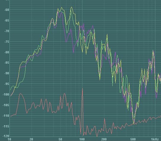

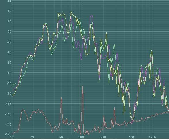

didnt you say you EQed the response? How about a 70hz crossover point? How are you going flat to 10hz?
Yes I did eq the curve. The 80Hz dip is a proper null though - I tried adding 15dB gain at 80Hz and it didn't change the dip.
If you look at the 'in room' plots of the labs before eq (page 2 of this thread) then the purple line shows the dip, the other 2 don't.
The measurements were taken in 3 places across my 2 seater couch - left seat, centre, and right seat. I then took the measurements again 1 foot in front as the couch moves back and forwards a bit day to day. Thing is, if I sit in the seat with the 80Hz dip and listen to music the sound doesn't noticably change if I move 18" left to the place without a dip.🙂

As you know, below a certain frequency the room goes to 'pressure mode' In my case this is at ~30Hz. As room gain this low gives me approx 12dB/oct boost, and my subs roll off at 12dB / oct they cancel each other out and give me a pretty flat response below 30Hz (down to 15Hz at least - then they drop at 6dB/oct according to the plot). I've attatched a plot of my 3 tempests in room, no eq to show you where the pressure mode kicks in. Also note no room modes below that point .
At the moment I'm using 2 tempests, but am waiting on 1 to be delivered so I'll be using 4 below 30Hz eventually. I've estimated my room to give me a free 10dB at 15Hz, which can't be bad.
I'm using a dcx2496 crossover to eq the labs and the tempests. Just eq the tempests flat then add a 24dB lowpass at 30Hz,. The labs only need a 12dB high pass as they roll off naturally at 12dB/oct in room anyway.

Hi Rob
Your 80Hz notch is (most likely) a floor to ceiling mode, it cannot be eq’d away as the more energy you put in, the greater the cancellation energy is also.
With an RTA (which is very limited resolution) it is often possible to seemingly “fix” nulls with EQ, however, this only appears to be as a result of the limited resolution.
What’s worse, attempting to fix a notch with EQ totally screws with the phase while being unable to actually fix the problem.
Peaks on the other hand or the speakers low frequency response can be fixed with EQ and in so doing, one also fixes the speaker’s phase.
Eq has an equal capacity to fix or mess up, depending what you try to do with it. Minimum phase things can be fixed in both amplitude and phase, time related issues (such as a reflected wave at 80Hz) cannot.
Given you probably have “enough” horse power with a pair of Labs, you could try changing the orientation to see if the mode can be driven less severely.
If the horns are in the corners now, try them mid wall with the mouths facing up, in other words experiment.
One I have found to be very useful and see no problem with is that you can also use a thing called reciprocity to your advantage.
Take your lab sub (or better /easier a smaller sub with flat response) and place it in the main listening position.
Then, take your measurement mic (much easier to move around than a woofer) and measure the response in the various positions you could put the sub.
Do to the transfer functions being identical (or very nearly) going either direction, one can directly snoop around for a “best spot” for the woofer, with a microphone.
One last thought, when a horn is too small, its length has a direct and powerful effect on the low corner F. Since you have these indoors and can do what ever you want, you realize it is then that adding to the path length with an external horn will lower the corner F.
An additional 2 feet of path should lower it to where the expansion takes over being the limit (this should be around 25-28Hz).
An experiment you could try would be to place one lab, against a wall and pointed into a corner. If you place the mouth about 16 - 18 inches from the corner (facing into the corner), the external shape of that air path is close enough to load the horn for a foot and a half or more. This also makes the effective mouth larger so you may get a better response shape too.
Anyway, its cool to hear about your adventures with Lab’s indoors.
