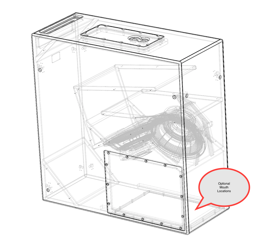

A fold pattern similar to the TH-212 could be expanded in one dimension to 42", reduced in the other to 31", depth increased to 17", and then use those Radian Neo 15" you have your heart set on .
1)Did you just work that up yourself?
2)To be clear, that's a dual 15" TH in P-P format, 42 x 17 x 31" ?
3) Is there a way to "easily" guess at the LF extension of this design?
4) Safe to say t would be close to the TH212?
5) So I guess I should have titled the thread, simply "Danley TH212 Clone?"
1) Yes, just yesterday. Here's the math: 36x36=1296/42=31(30.85714286)
2) Yes.
3) Since the path length could be the same as the 36" x 36" x 15" DSL TH-212, the LF extension would be the same.
4) The LF extension should be similar, the shape of the response determined by the drivers chosen.
5) Yes, since that is what you are looking for, and the FLH 45x45x22.5 LABhorn (using a driver specifically designed for that horn near the turn of the century, named after the ProSoundWeb's Live Audio Board) is far to big to fit in your pickup.
