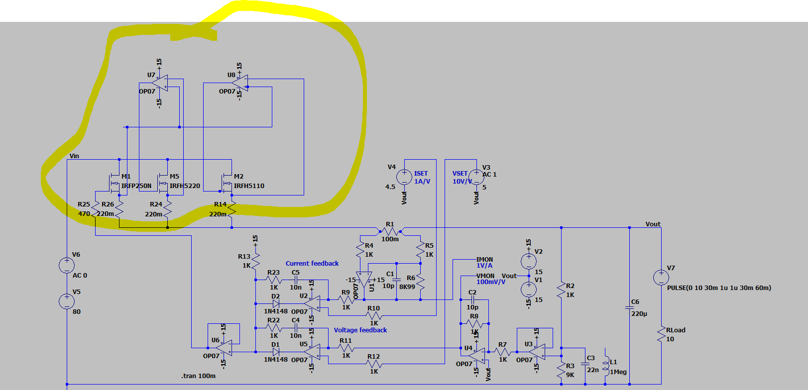

Considering I have more than an handfull of older (90ies) standard vertical mosfets, with SOA-DC specified I decided to do something with that. So here is my model variety with a local feedback around each mosfet. Yes, a lot of OPs are required. They are kind of obsolete when it comes to switching applications in some cases too...
Still requres some tinkering, as the models are not the same as for my mosfets (STW38NA50 in SOT-227 or STW50NB20 in TO-247) but as a general proof I guess it works. Might be a bit unstable due to the loop-in-loop stuff unless properly compensated...
The original setup works fine with multiple BJTs replacing the mosfets if using a predriver in a BJT darlington config, NPN/NPN or sizklai style. . I still might have a fistful of MJE21194/5s self-desoldered from an PA-amp where the main transformer accidently was feed 230VAC on 115VAC setting, which not only led to magic smoke release but real smoke too. And some cleaning up afterwards.
