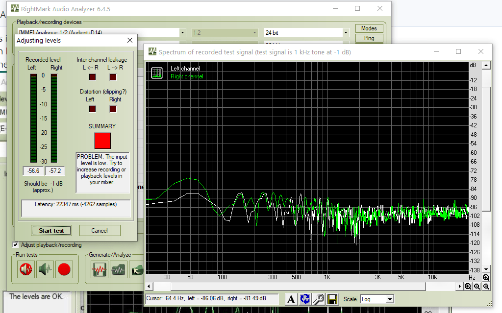

you have some mains signal (50 Hz + harmonics) in there.
make sure you have enough distance from any transformer and PSU circuit and check your ground connections (particularly for ground loops).
also, what is your 0 dB referenced to?
The sound card is on the top of my pc ... maybe not the best place
And that can be some ground loops I understand now that my approach has been too not careful
Lab instruments need a lab Not a living room or a bed room
I am working on it I am looking for some quiet place to set up a little lab The only way it could work
0db= 0.707V
Hi thank you for the very valuable advice I can listen only to max 14k ... for me there is no need to go beyond that at my age
It is more about checking out the amplifier's state and capabilties than the actual level we can hear up to 😉
And I was obviously mistaken above - the Uphoria can probably go higher than 20kHz - I was thinking about earlier versions of 202.
Your practical problem is to find loopback noise and distortion wise the optimum combo of card output and input gain/volume regulators and windows mixer level settings - both output and "mic" input. The results may vary greatly.

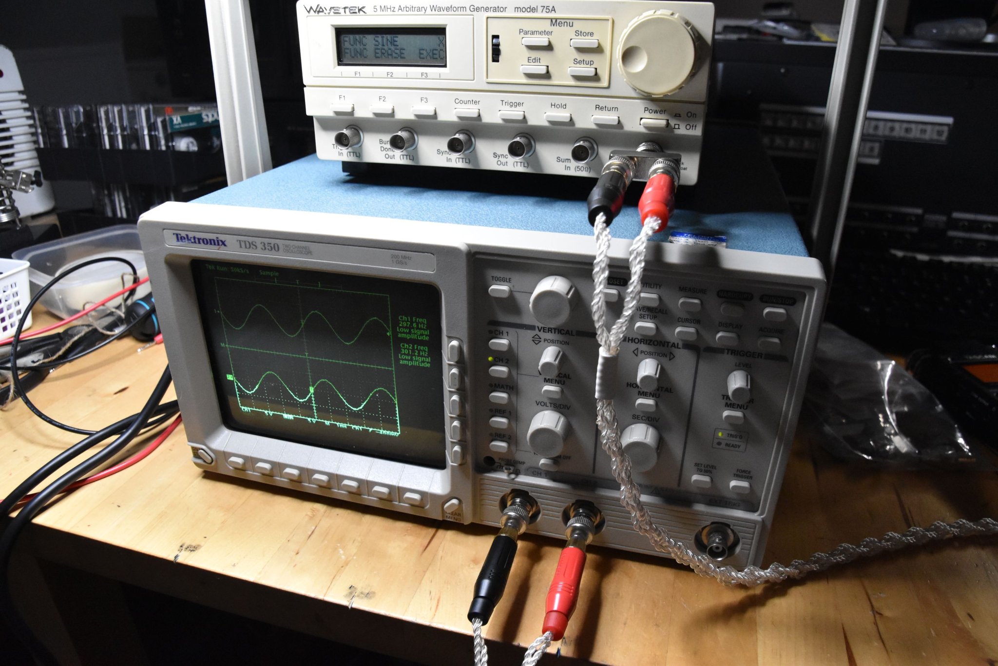

There's a place for both types of scope imo but for signal generators used with audio it has to be digital for accuracy. There's no point using an old analogue signal generator if it's out of calibration and how would you know it is in-spec to begin with?
Analogue scopes can fail and go out of calibration too wheras even though digital scopes can have less resolution they usually have start-up calibration routines.
Swings and roundabouts.

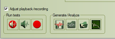

Please sorry to bother you but i am slow to understand
Lets say that i want to see the THD spectrum of a 1kHz sine generated by the sound card
I have connected card outs with card ins
Then i open RMAA and what i have to do ?
On the bottom left corner i see the buttons here below
and i am lost at this point
