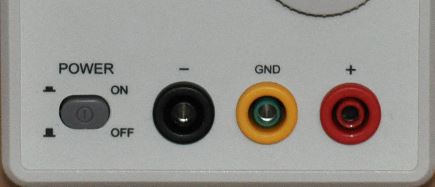

I see on a power supply i have 3 outs: -, GND, +.
I have a unit needing +12VDC, just two wires.
I guess the positive must be connected to + terminal.
But the other ? to the - or GND terminal ?
I would say GND ... maybe ?
Does this mean that is a dual power supply maybe ?
Thanks a lot indeed, gino

The owner's manual for my lab grade power supply tells me to connect "-" to "GND".
Then connect the load between "+" and "-".
Maybe the owner's manual for your power supply, discusses this

- + and GND is ambiguous. It could be a dual polarity supply. It could be a single supply, but isolated.

Set output voltage = 5 volts
Connect 1K resistor from "-" to "GND".
Measure voltage across 1K resistor.
If measured voltage = 5V then it's a dual output "bipolar" power supply.
If measured voltage = 0V then it's a single ended, isolated, "floating" power supply.

It would be best if you post a photo of the entire front panel, including the model number.
The odds are that the +/- are the supply terminals, and the ground terminal is the chassis.
Most dual supplies have two output terminals per voltage, plus the chassis ground

The GND terminal will be connected to ground. It may enable you to ground one side of the DC output.
When there are only - and + outputs the - may be connected to ground internally, or may not, or there may be a switch or internal wire link to make or break this connection.

Usually in lab supplies the voltage output terminals are all floating wrt ground.
Also there is usually an optional chassis ground socket available,
which is permanently connected to the mains ground.
If you wish to ground one end of the voltage supply, a jumper is connected to it.

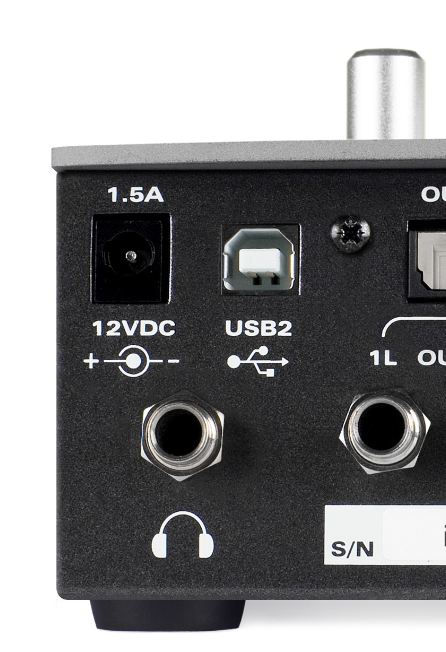

Hi ! i am attaching a picture of the dc socket, the 12VDC/1.5 A input on the left side of the picture.
It has only two contacts + and - . But this is quite standard for this kind of interfaces, when they are not powered from usb directly.
They usually need 12VDC power supply and usually a wall power adapter comes with them. The idea is to try something more serious.
It could very well be that even a better ps will have no effect.
However i will feed the interface with 12VDC coming from these lab grade power supplies and see for the noise level.
This is the issue.
Kind regards, gino

The ground is a connection to the case / chassis of the power supply. Regardless of whether the input is AC or DC it is often required that the case of all devices including whatever you power with this supply be 'grounded' to the same potential.
This will almost always be the same potential as the mains ground and in most cases but not all the B- will be connected to the same potential.
To power a device use B+ and B- only. If it is a device with a metal, grounded case, use the ground terminal to ground it as long as there is a connection from the power supply ground to mains ground otherwise it's irrelevant.

OK. I thought we were talking about the output DC arrangements from two different PSUs. Now we are talking about the input DC arrangements of the load. It is easy to confuse me!
So we have two supplies, which may or may not be grounded or floating, single or dual polarity. We have a load, which may or may not ground one side of its supply.
You do realise that the cables may pick up more noise/interference than the supplies put out? Hence the final stage of filtering, when necessary, has to be at the device end not the PSU end. If a device needs a very clean supply then it should arrange this itself, not rely on something else to do it.
