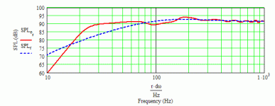

FWIW, I looked at this driver in a MLTL awhile back, though it's somewhat larger than 6 ft^3 and tuned lower, but scaling it back a bit and raising tuning to around 22 Hz still seems a viable option and since it's a bit larger than Bjorno's, it's a couple of dBs more efficient down low in a sim.
It's long at 81.75" i.d., so needs at least one fold, but only as wide, deep as required to physically install the driver and vent [~126.83"^2 i.d. to = 6 ft^3 gross or about 5.49 ft^3 net], but being end loaded for both the driver and vent to get max floor boundary gain, this shouldn't be a problem.
The vent would be a 6" i.d. dia. pipe ~8.5" long if laying right on the cab 'floor' or ~12" long if not, so would exit out the side relative to the driver baffle. Might be best to try different lengths in room though since the amount of boundary gain is an unknown.
Sim is minimally damped since the TL action is plenty strong enough to damp the driver, vent, i.e. top, back one side lined with just enough damping to quell any 'hollow' sound and with a typical 80 Hz XO for HT, you can ignore any 'ripple' above this frequency.

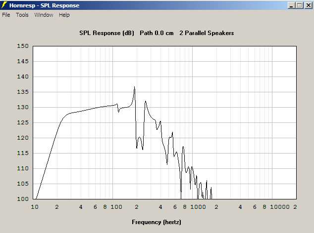

Two of bjorno's MLTL's in parallel into 1pi space (Eg=60), scary stuff 🙂 :
Can you post the same with 1 MLTL into 2pi space? Just to compare some designs at Data-Bass

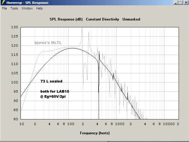

See bjorno's Post #7 for the single MLTL into 2pi simulation. The fold I drew up in Post #9 was a general suggestion, the aspect ratio of the duct is 5.64:1 (15.5"/2.75"). I went straight of bjorno's data, and did not enter any end corrections; for any box like this I would suggest a trials box to get a better idea of the stuffing location and density, and so on. If you take this design into AkAbak you can also fiddle with the design some more.
Ok. I calculated in my head that it would be possible get 124dB from lab 15 but this depends on the design. 117dB in some sims is close what I'm getting from sealed. I'd be interested seeing comparison 73L sealed vs. Bjornos MLTL.
