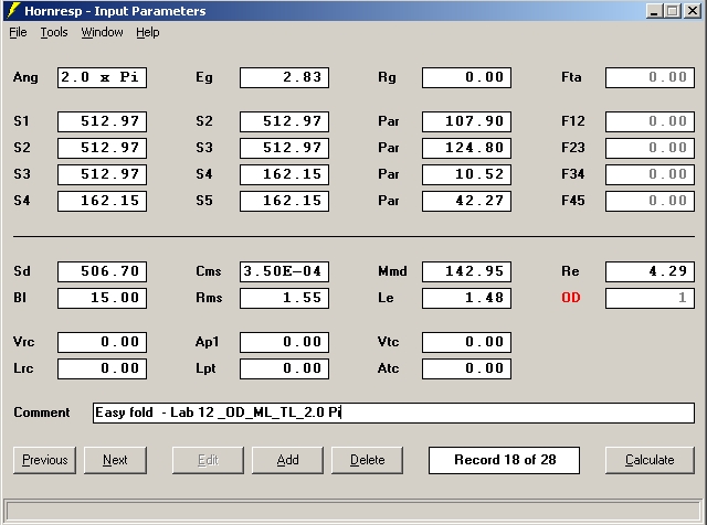

Those TC Sound drivers model really well in this enclosure, with the extra throw translating into higher SPL. I think I will build 4 enclosures, two for my current Lab 12s and two for TC Sound drivers. I have both an HT and a two channel setup (Magnapan MMG's) so I have a need for multiple subs.

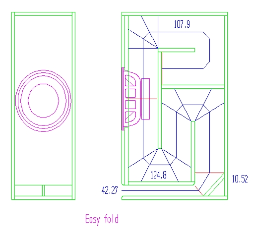

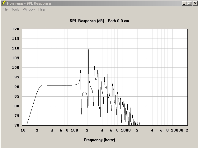

Single fold design
Does anyone see a problem with folding these in this configuration?
I have space for one or two, tall subs with a small footprint.
Trying to decide if I should make the Don Snyder design recently showcased by Layertone and unfolded by Oliver http://www.diyaudio.com/forums/subwoofers/143714-lab12-tapped-horn-19.html

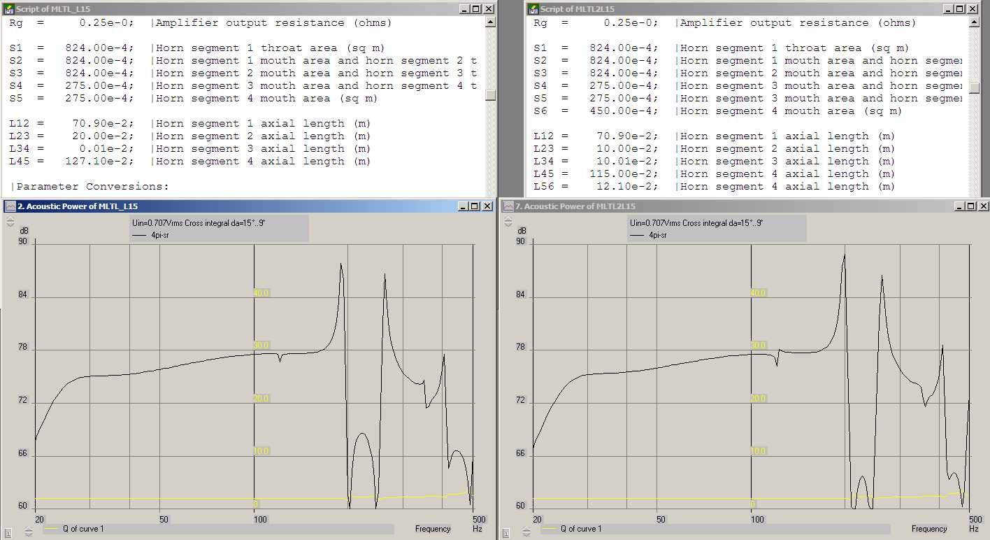

Or, maybe unfold this OD-ML-TL like this................... Here is the original design below.
Or, even have the 45 degree mouth like this.
Both of these are slightly different, mostly in port length, but also where the driver mounts in relation to the port and the fold.
Hrsp. says they both perform identically to the original design shown at the right.
Help me decide,
Dave

Post #65: "...anyone see a problem with folding these in this configuration?"
Don't see any problems, but the 45 degree duct opening to the room does not seem to be helpful in AkAbak. I didn't enter these particular enclosures, but an MLTL build around the LAB15, and tried the same duct modification without seeing any benefit. The angle at the inside can be evalutated in Hornresp, and may be helpful.

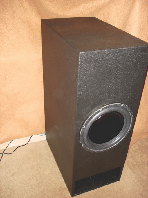

OD_ML_TL Build
I have all the material cut (18 mm Baltic Birch) and am in the process of gluing and assembling.
I have Wool for stuffing, speakers and just got a new laptop with ARTA and REW installed.
I also have an ART dual USB pre and an ECM 8000 mic.
I also installed System Architect 3.30 for the Crown amps.
The design that I am building is a little different than the "final" listed earlier in this thread, but it seems to simulate well in HRSP.
I tried to simplify the design as much as possible.
I didn't like the idea of the large external flare, mainly because it is hard to define exactly where the port ends, plus the maximum velocity in the port is only ~ 2.3 M/S so I don't anticipate any port noise.
There is a ripple in the response at about 80 Hz that comes and goes with just a few mm's of change in duct or port length, but I am assuming that may go away with some stuffing.
I tried to get the driver to mount lower but I could only get it about 5 inches lower, and that greatly complicated the design.
So I am going to live with it just the way it is.
I should have some tests of a finished, stuffed cab (or two) with a broken in driver in a week or so.
Dave

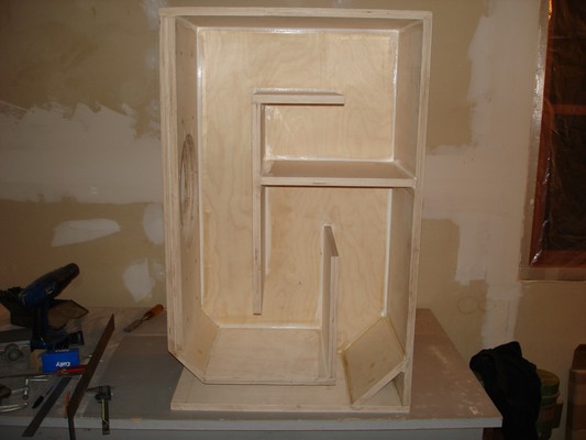

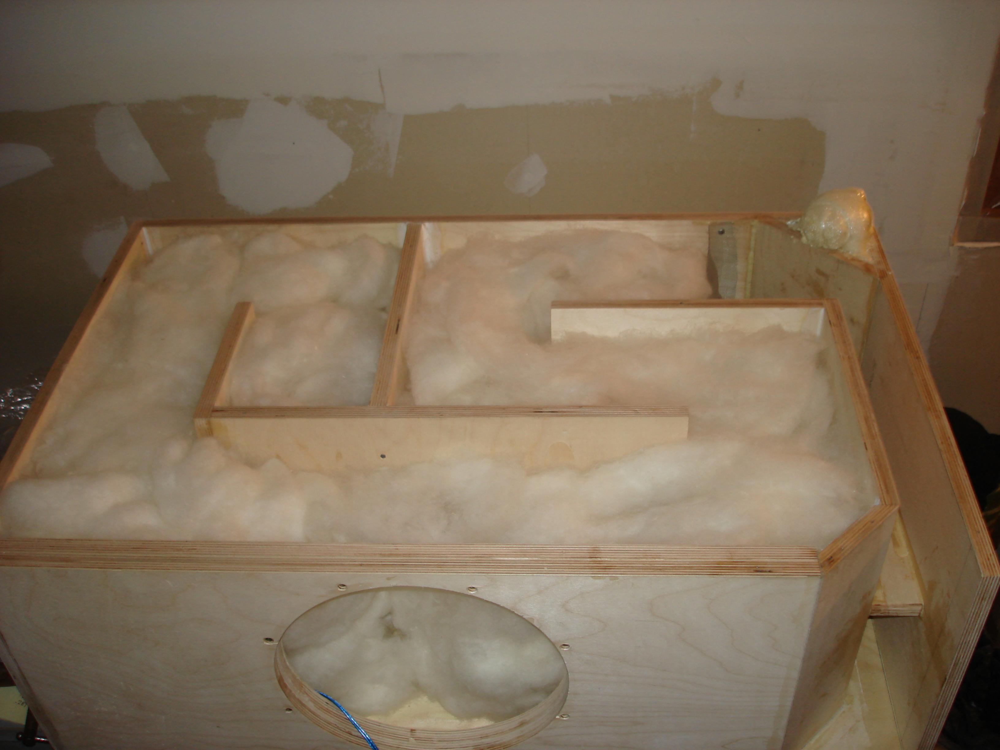

Partway there

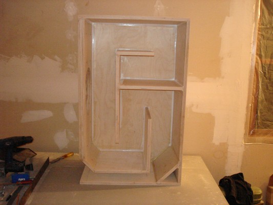

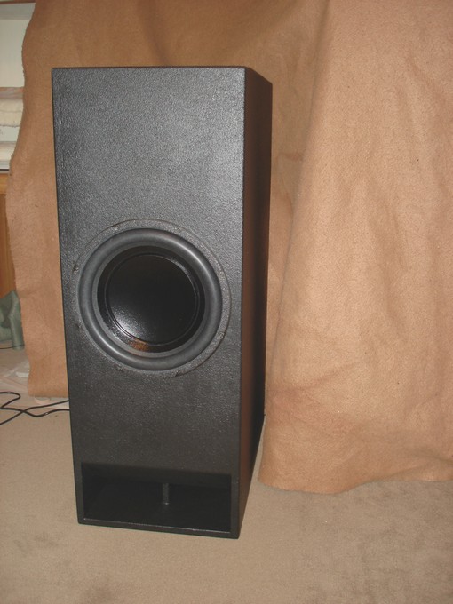

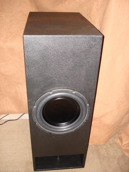

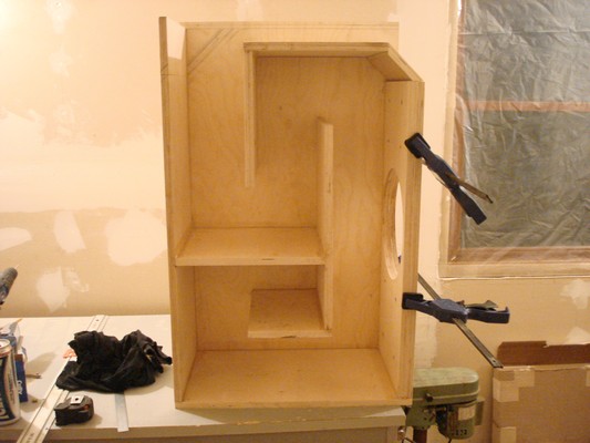

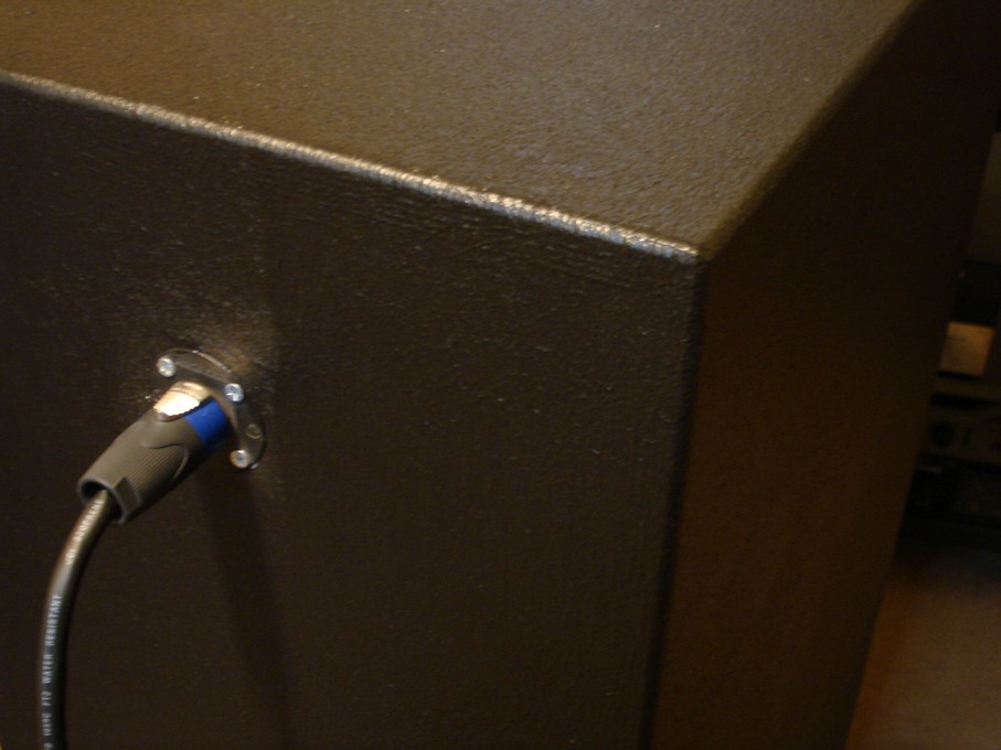

So I finished the first OD_ML_TL box and glued the entire thing except the last side.
I used 18 mm 13 ply Baltic Birch for the entire box.

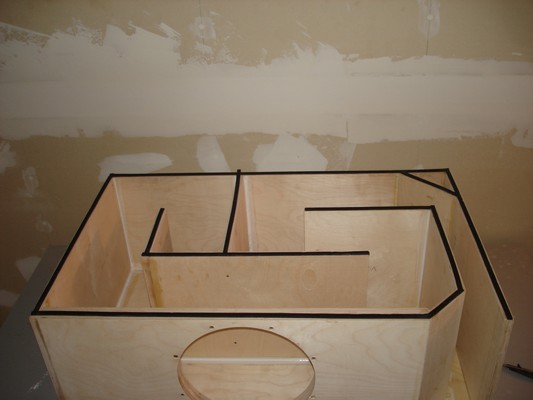

I used Polyurethane glue and then caulked every joint with Dow Silicone II just to be safe, oh and about 50 Self-Sinking Small Flat Head Square Drive 1-5/8”_#6 screws along with my 6 big wood clamps
These screws McMaster-Carr Stock number 91520A301
I also used threaded inserts for the speaker mount bolts.
These inserts McMaster-Carr Stock number 92105A665. They work well but I had to use a larger than recommended drill (7.4 vs. 7.0 mm)
I screwed the last side on using foam gasket tape to seal it and left out the damping material.
I basically wanted to break in the driver and do a few FR sweeps without damping to see what it really does to the speakers FR.
The first thing I will say is, if you have a couple of designs, each with their own cutlist, don’t get the cutlists mixed up.

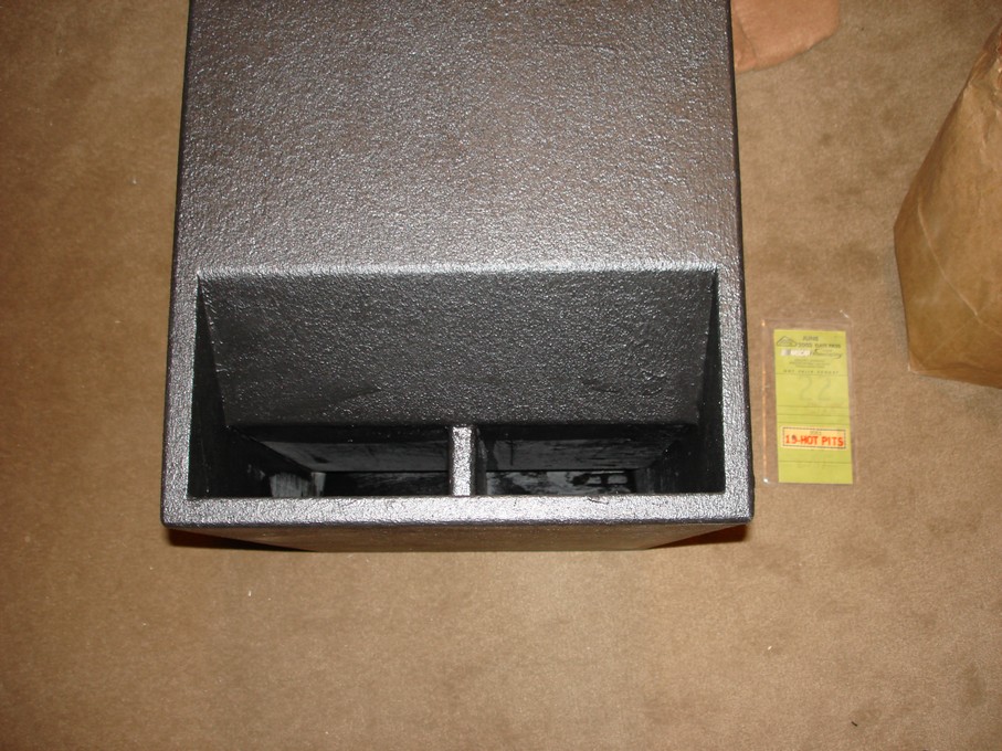

I was planning on leaving out the external flare, but…I used the wrong cutlist and am out of Baltic Birch that is long enough to make 4 more baffles. I have allot of 30” X 30” BB but the baffles have to be 33 and something So, I will either leave them with an external flare, which is only 2/3 of the size of the “final” design in this thread, or I will make a glue in piece to fill in the flare.
I am worried that the port is too short, and I do not know how much of the flare actually acts as a tuned port.

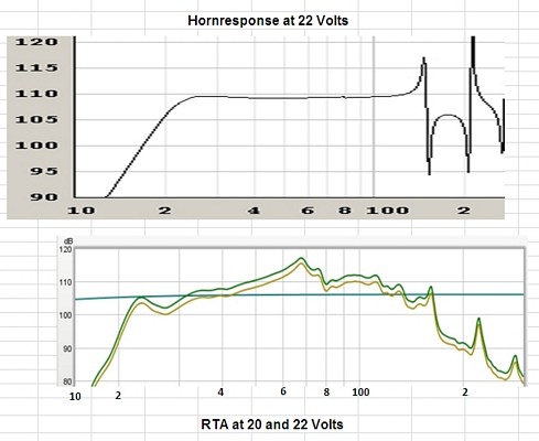

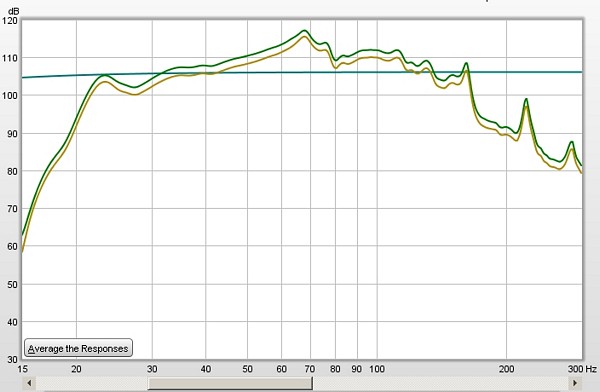

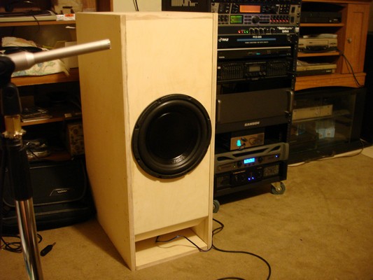

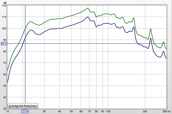

So here are a few Pics and some FR sweeps.

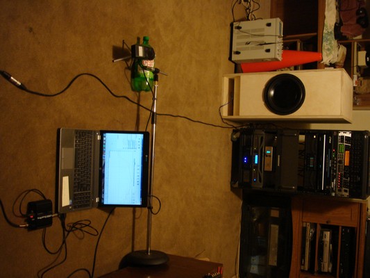

I used an ART dual USB pre with a Behringer ECM8000 microphone and REW on an HP ProBook 4530s, 2.3 GHz dual core with 4 GB DDR3, 500 GB drive and Windows 7 pro 64 bit software.
The USB pre does not list windows 7 as a usable O/S and it took me a while to get it working.
Also, the ART dual USB does not allow for calibration like a normal soundcard, or at least I can’t figure that out but the loopback response curve is not all that bad.
It drops off about 1 dB from 30 to 15 Hz and has some ripple maybe 1 dB each way in a sine shape (3 waves) between 14,000 and 22,000 Hz. Not that bad for what I am doing.
The FR plot was done with HP-22 Hz-48dB-BW and LP-120Hz-24dB-BW both programmed on a Crown XTi-1002 amplifier.
Also I set the limiters at 20V and then 22V (~93W and 108W) to protect the speakers and give a reference. The SPL numbers are set with a new Radio Shack SPL meter and are within +- 1 dB or probably better.
These measurements are 15 Cm off of floor and 1 meter from baffle surface in the center of the largest room I have.
The room however has concrete floor and walls with a drywall ceiling.
It does have a rug and some furniture like a soft couch and a giant soft chair.
I had wanted to do some measurements outside but the 6" of snow on the ground and the 15 degree temps made that less appealing. Maybe in a few weeks when the sub is finished.
I found when listening to the sub I preferred to use LP = 80 Hz-12 dB-BW and have gone down as low as HP = 20 Hz-48 dB-BW with the limiter set at between 20 and 24 volts. But I have seen some occasionally scary excursions with HP = 20 Hz and limit = 24 V (135 Watts), although only on movies with some big LF content.
I will admit that I really do not even notice that it is there until I either shut off the Crown amp or a really violent low scene comes along in a movie.I can't wait to have 2 of these spread around the room with some EQ on them.
I found it interesting to watch the cone during an RTA sweep with the 22 Hz-48 dB HP filter and starting the sweep at 10 Hz, the speaker cone starts to move with some large amplitude's, much bigger than I ever see even with the movies.
However the large amplitude occurs at 13 to 16 Hz and I can see the motion but hear nothing. Then the amplitude drops way down and i start to hear the speaker.
This makes me wonder if response below 20 Hz really does anything.
The pictures show construction at several steps, the gasketing that I used to seal the temp screwed on side panel, the sub hooked up in my den, my measurement setup and a few FR sweeps. I tried to make a comparison of HRSP and the RTA output but the scales are so different that it was hard to do.
I would have liked to do the measurement outside but the 6" of snow and 15 degree weather made that less appealing.
Next I will pull it apart and add damping, then do the measurements all over again.
If the FR curve does not improve quite a bit I am going to make an insert to cover the external flare, increasing the port length. I may also put a 3/4" divider in the port to help with aspect ratio.
So, here it is so far.
The measurements are first HP-22 Hz-48 dB-BW_LP-120 Hz 24 dB-BW. with the limiter set at 18 and 22 Volts.
The second shows the same crossover settings but with a limiter at 20 (93 W) and 22 Volts (108 W) plus the loopback calibration is also in the file,straight line at ~ 105 dB.

So I finished the first OD_ML_TL box and glued the entire thing except the last side...The first thing I will say is, if you have a couple of designs, each with their own cutlist, don’t get the cutlists mixed up.
It is great to see this design being built!!! I plan to build in a few months and will also post the results. Looking at the measured data it seems a fairly good match to the model, will be very interesting to see the effect of the stuffing.
It does seem that the port is a bit short compared to the Bjorno modification (see attachment). Off the top of my head I can't recall if this would significanlty change the tuning of the design.

Finished, for now
I finally finished stuffing the box and doing the final gluing of the side onto the box.
I ran around it with a ¼” round over and put 2 good coats of Duratex on the box.
I put a fresh layer of foam sealant on the speaker and bolted it down using Socket Head cap screws.

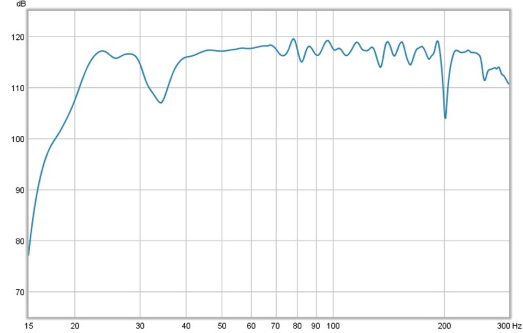

Before I put the speaker in, I measured it again using DATS. I was surprised to see that Fs had risen from 22.0 to 22.8 Hz.
So I set it up and did some sweeps, and this time I realized that I could run it at a higher voltage than I was using. I had it limited to 24 V (135 Watts) but I found I could run 29 V (200 Watts) without distressing the speaker.
One thing I did notice is my other woofer cabinets are being excited to the point that I almost can see the cones move.
Anyway, here is a 15Hz to 300Hz sine sweep with a 22 Hz-48 dB/Octave BW_HP and a 180 Hz-24 dB/Octave BW_LP filter and the Voltage limiter set at 29.15 Volts.
When I did the first sweeps I saw a big hole at 34 Hz. I’m not sure if this is room acoustics or the speakers response.
I put an 8 dB boost at 34 Hz with a Q of 6 into the Crown amp and the response was almost flat after that.
I should note that I am not using any smoothing on this data. I see if I use 1/6 Octave smoothing my lumpy line will almost get flat, or at least real smooth and the hole at 34 Hz almost goes away. So I guess that is cheating.
I may play around with the port some, but with a little EQ it sounds great.
22 Hz-8th order HP...70 Hz-4th order LP with 8 dB boost at 34 Hz (Q=6).

Dave,One thing I did notice is my other woofer cabinets are being excited to the point that I almost can see the cones move.
Looks good, the big hole at 34 Hz easily could be due to the room, but try shorting the other woofers out, they may be acting as tuned bass traps.
Unpowered un-shorted speakers can have surprising influence.
I am just unsure how long the effective port is with the external flare, and that makes me uncomfortable.
Connect the DATS to the driver when it's mounted in the enclosure and do an impedance test. The graphed results can tell you a lot about your built speaker, including the effective Fb.
