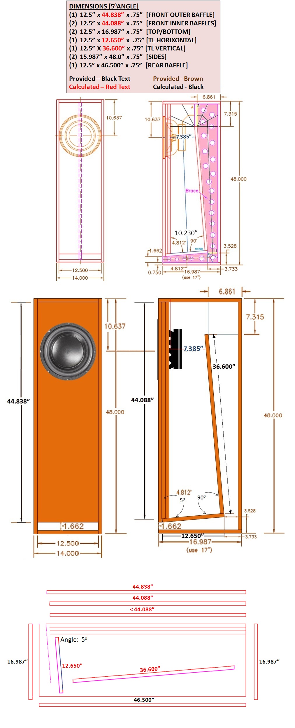

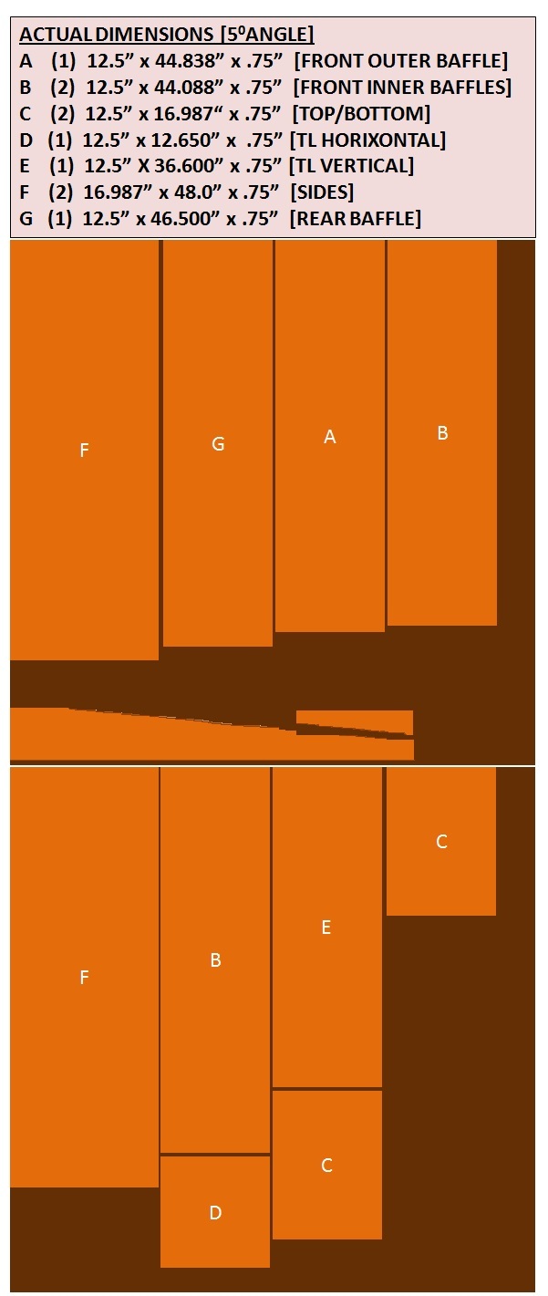

Dimensions and Cutsheet - Baltic Birch
Attached are my first stab at filling in all the material dimensions and a cutsheet for the design posted by Oliver. I plan to use Baltic birch 13-ply material (60" x 60" x 0.75") that I will buy from a local wood supplier in Maryland. I only have MS Paint and PowerPoint so my level of accuracy is not that of tb46 who has more powerful tools, but MAY be good enough. Due to the precision of Oliver's numbers, I will have to do some rounding when actually start to cut wood. There is a typo in the dimension sheet, should be 16.987 for sides instead of 15.987.
I finally received my orders, so will be headed back to the US in August...😀 😉 🙂 😉 😀
Outstanding! I'll be waiting to see how this design works out too. Glad to hear you're coming home.
Edit: That's one hell of a front panel, probably need some serious chamfering.

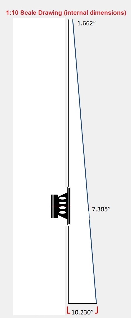

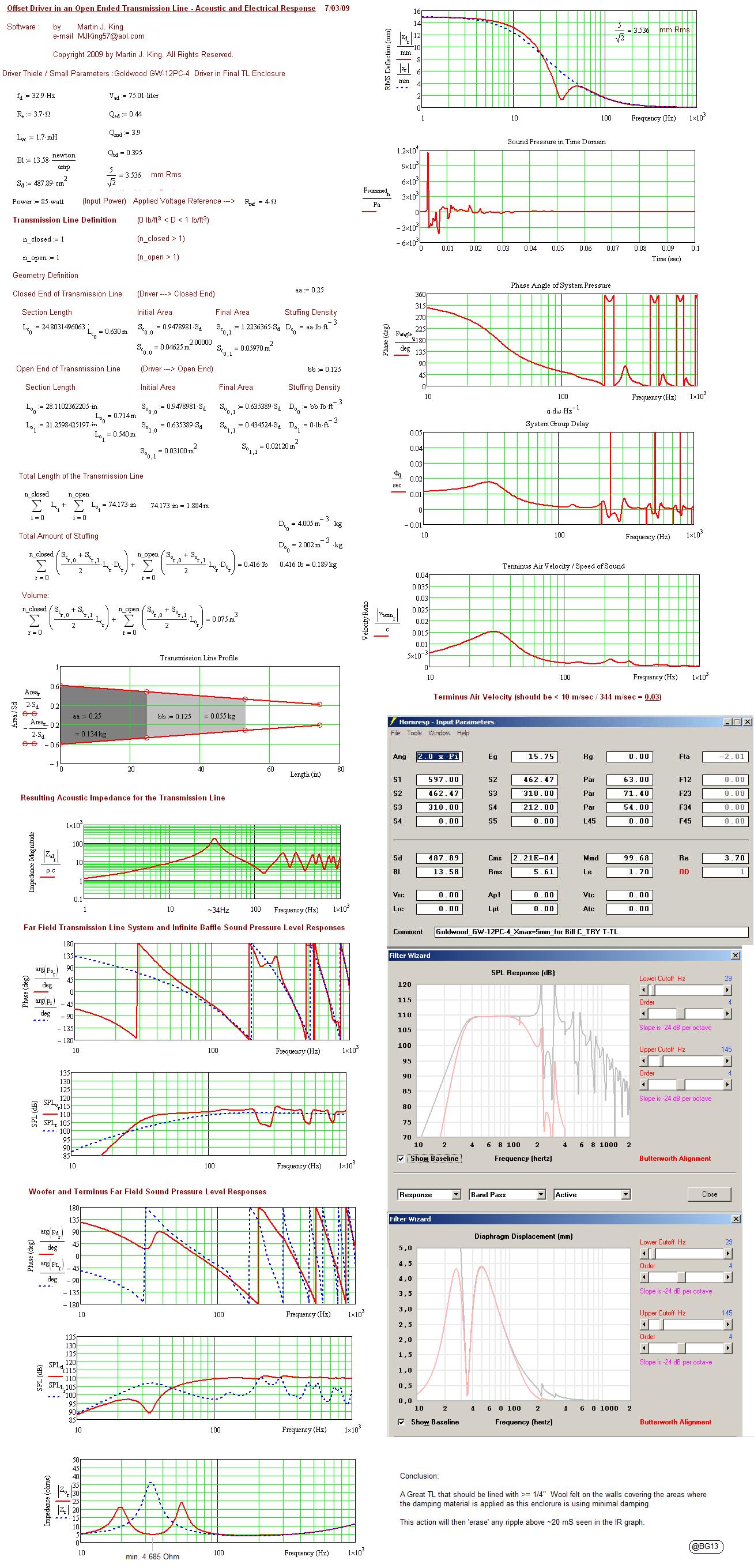

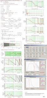

That's my kind of a Baffle! Good work, I think it's best to check this design in a simulation when stuffed.. Normally a TL is using a Sd/3 Terminus for Drivers where x-max is around 10 mm but should be increased for long throw types. I guess only MJK:s programs can solve this matter satisfactorily.

Thanks Bjorno, I downloaded the data you provided to another build for a similar design using a Goldwood driver (Oliver posted a link on page 14 - attached below). The thread starter did not go with the design, so I thought I would give it a go.
These two (eventually 4 if I get crazy) will be paired with the awesome TTQWT you developed for my Mael-X driver.Construction to start in September! Based on the quality of the design will use primarly 0.75" Baltic Birch (the real stuff in 60"x60" sheets).

I would be great to see a work-up by you using MJK's spreadsheets for this design, the drawing is in Post #182, and the simulation is in Post #143. (This was mainly an attempt to show a different form of construction.)

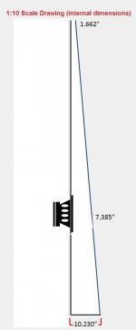

One other question for Oliver (or anyone who knows)
Would there be any ill effects from mounting the driver like this is the QWP? Edit: Or t-qwp or ..ha, so many initialisms!
