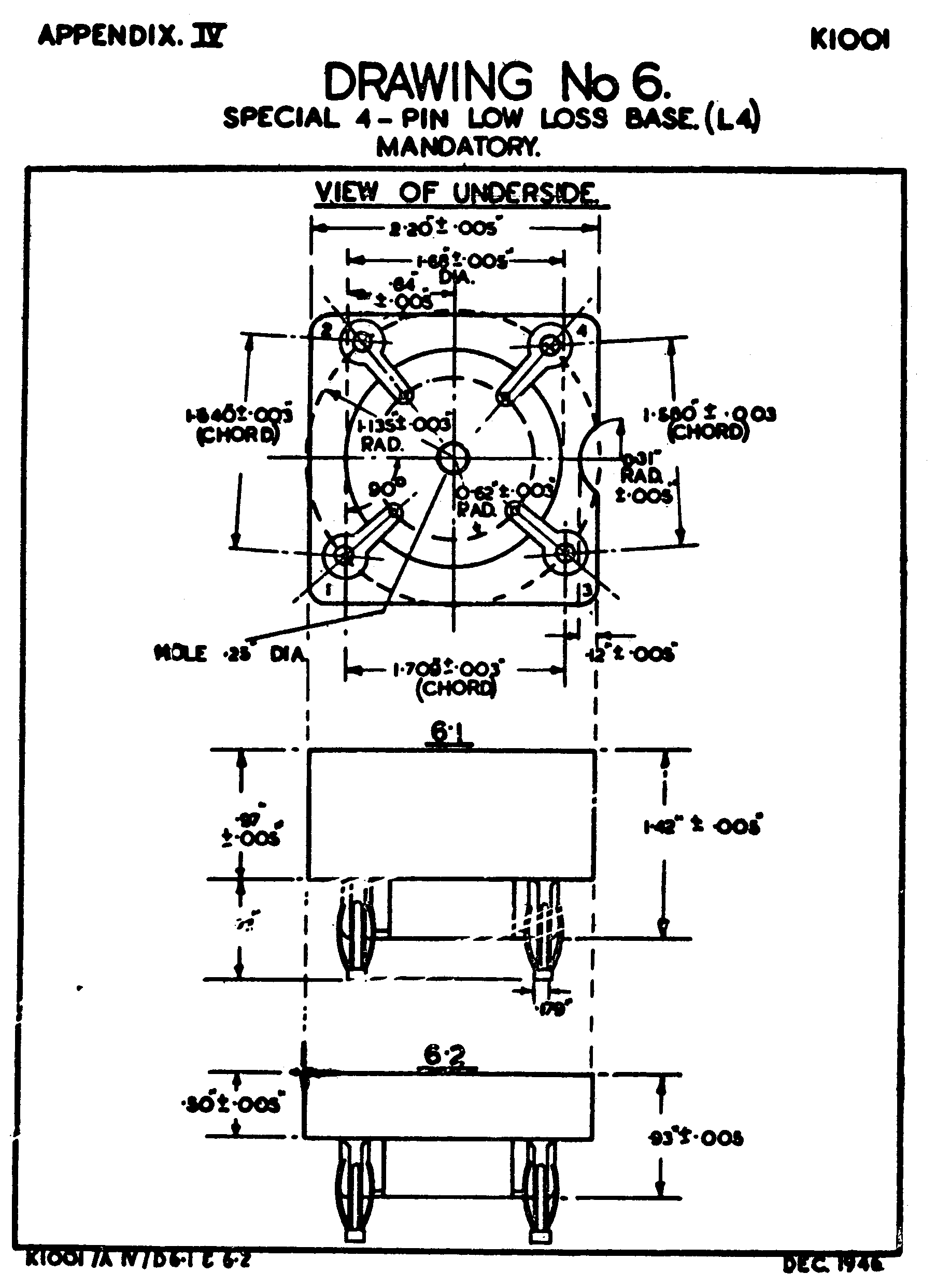

L4 (UK) valve socket
Does anyone have a dimensioned drawing of the UK L4 valve socket?. I have a number of V.T.25s, DA60s and a DA 100 that I want to make an adaptor for so I can test them on my VCM163. These sockets appear to be unobtanium.
Thanks, M.
