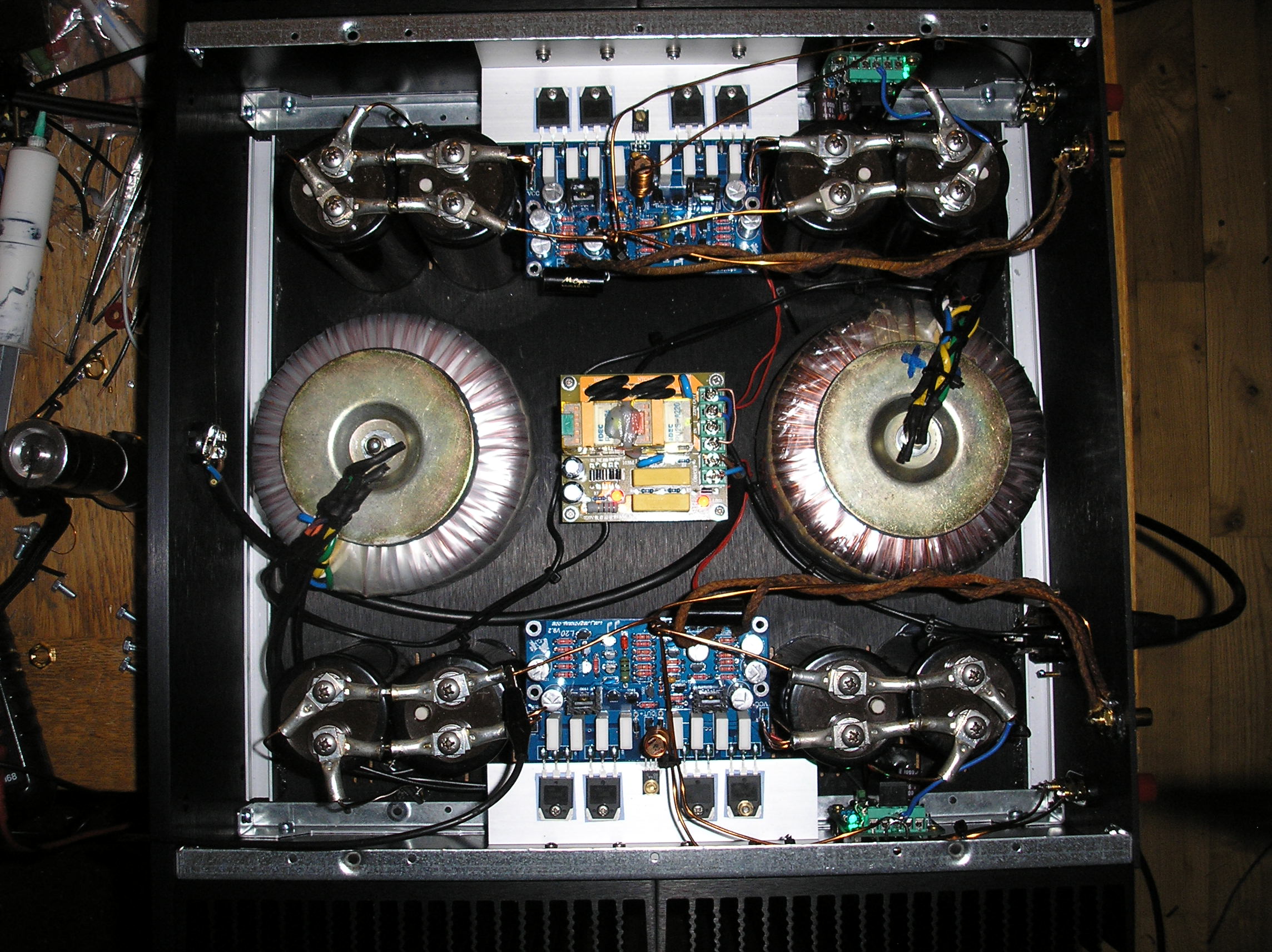

I removed the supplied input capacitors on my monoblock builds and the sound is significantly better. But removing the capacitors is not a good idea if there is any DC on the input signal. Otherwise, the amps are stock standard and I have fitted speaker protection modules. I used new toroids which give +/-56V rails which for me are a lot safer than the +/-73V rails I had with the first toroids. Of course the power is lower but I never use more than about 20W on the loudest passages with my 92db speakers. The L20V9 really does sound very realistic, the bass end is well controlled and the overall sound is very smooth. It could be a little more detailed at the top end when I compare it to my 300B 60W monoblocks but they are a hard act to follow. I'm using 4x10,000uf on each power supply rail plus 10x22uf wound foil caps on each rail. I feel that this 220uf of foil caps on each rail cleans up the top end a little and have used the same idea on other builds. I am using massive heatsinks which are complete overkill and never seem to warm up. However, when the amps have been on for a few hours they do seem to sound a little more detailed and the layering is improved slightly.

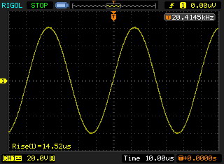

by removing the input capacitor(10uf) the amplifiers started to sound
and quite nice,i should remove the 10k resistor as well
- and of course Replace the 2k2 resistor with a COIL (inductor) and C2 to ,with the calculated value for the 24,5 - 25khz LowPass filter :p
and bring the input to aprox 6-8V preamplifaction,i dont know the upper limit
that will be normal for high end preamp :note::note::note::note::note::note:
the 100k should stay in place because it brings preamp to required input impedance
sO HIGH PASS filter only after amplifier and !! Not Before
- also replaced 1n4007 with ultrafast 35ns diodes ,because 1n4007 limited speed will act as a filter for transistor switching

There is no need to touch any other components when the input coupling capacitor is removed. It just means that the the sound will improve and the LF responce will extend down to DC. If there is any DC on the input signal from the source then that would be a problen as the DC at the L20V9 speaker output terminal would no longer be zero and if more than 50mV then speaker damage could occur. My L20V9 PCB's have been working very well now for a couple of months. They are stock standard apart from removal of the input capacitor and they do not show any signs of instability. The heat sinks I am using are too big and don't get warm and it takes quite a few hours for the amps to sound nice at the top end. This might be because the output devices a running too cold or maybe not.

Me again! Can you tell me what you are using for a heatsink? I have the Conrad MF20-75 @ 0.55 degC/W for 80 degC rise type left over from the ULD. Are you using the MF30-75? 0.39____

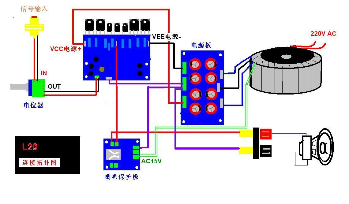

Hallo! IF i limit the imput voltage, can i use a 80 V rail as power supply?? I have a beautiful 220/ 55+55V at home en i wish use for my L20 board!
The specs seem conclusive to me:
Performance parameters:
- Power 200W (8R) 350W (4R)
- Voltage: DC + - 65V
- AC voltage before the rectifier:Recommended dual AC 36V;if you don't know what it is,pls using DC65V
- THD = 0.009% 1K HZ 50W 8R
- SR = 35V / US
- Noise 92DBU
- EIN = 114 DB
- Frequency Response 20-20KHZ + - 0.5 DB
- 34 times the voltage gain
- PCB size: 116MM * 72 MM
- Using KEC B817 D1047 and Toshiba A1930 C5171
