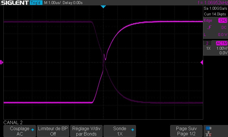

Thanks for showing Berlusconi. I will be doing the mod very soon. Do you recall what bias you used to get the optimum low distortion and what output power was used, presumably in an 8- or 4-Ohm resistor load? Also, I have not added the output coil either, maybe that is not helping the bright sound? The amp currently runs very cooly.Please observe the crossover distortion at the leading edge of the square wave response

How to measure: just solder two isolated wires to the SMD pads and place a 100K potentiometer in series with 33K fixed resistor. The fixed value resistor is added to avoid accidental inrush of high current. Determine the optimal value by observing the leading edge of the square wave response.

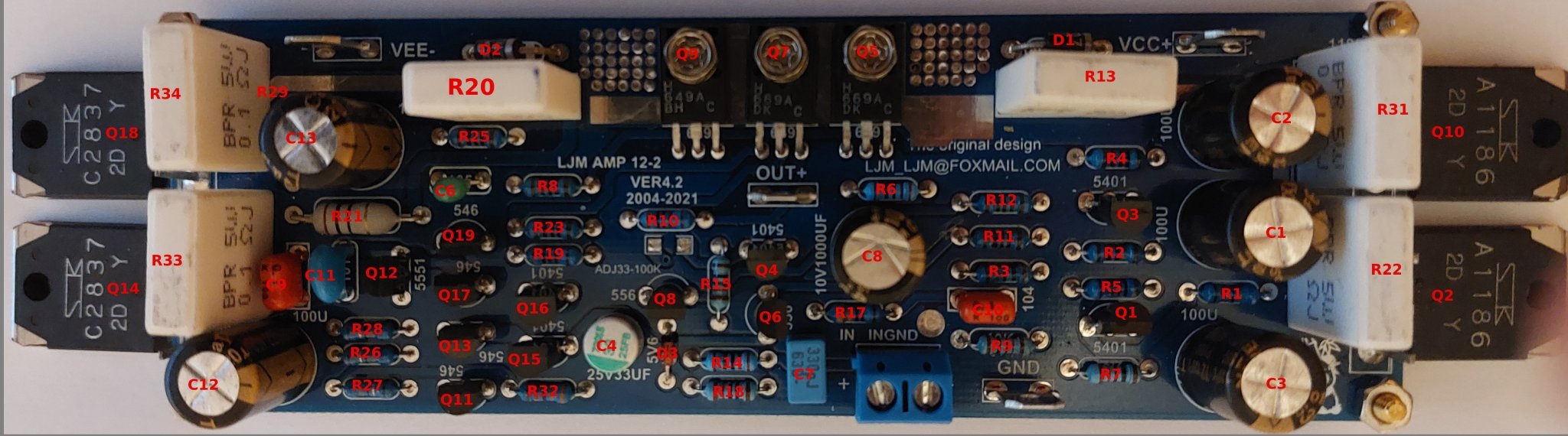

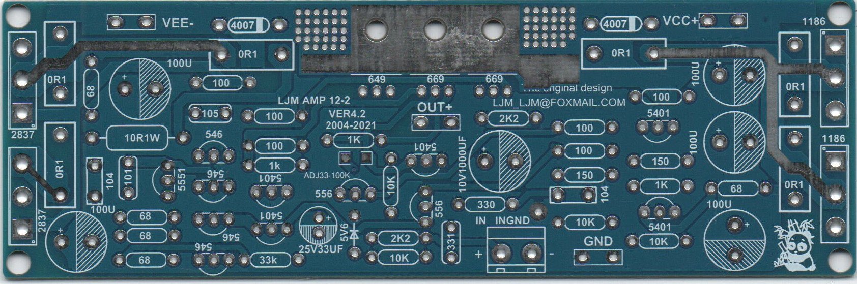

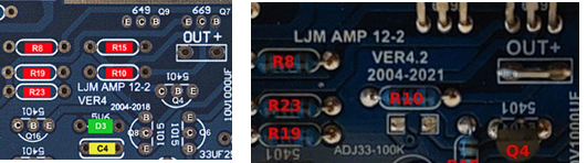

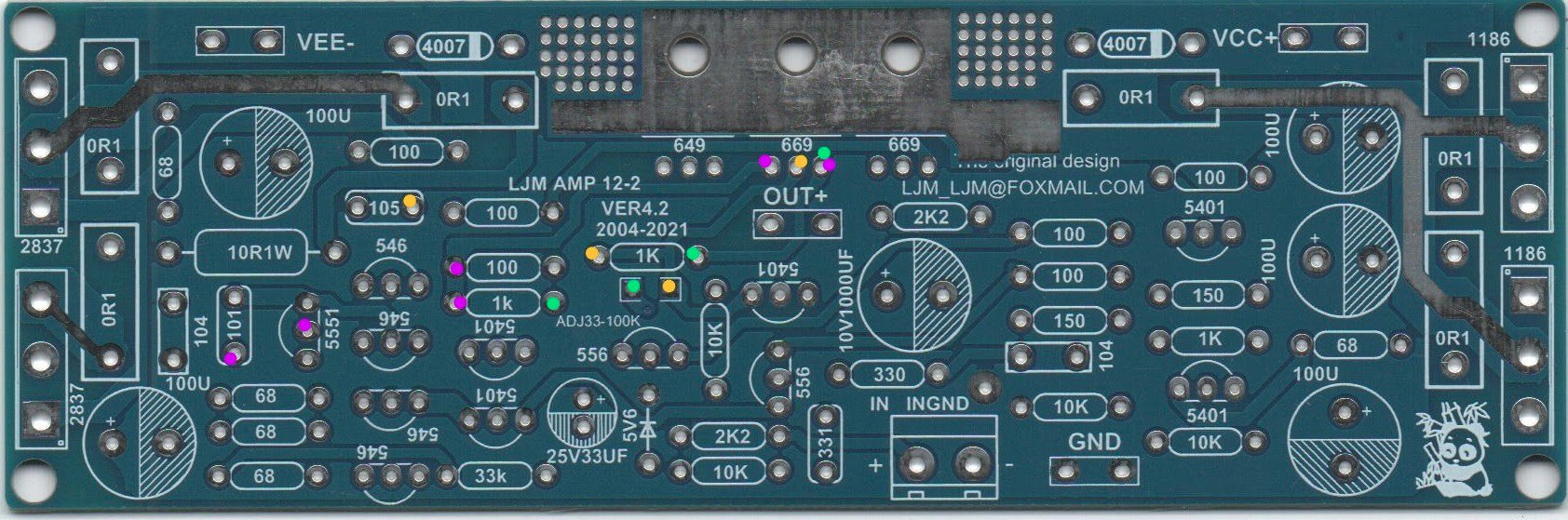

I found this in another post. It shows the location of R19. If you look at my bare board photo it shows this resistor to be a 1K resistor.Only thing I am not confident with is WHAT resistor on the 4.2 board is R19?
Excellent SJKE. Yes, the V4.2 layout shows that R19 has swapped position with R23 on the Ver 4.0 you show earlier. R19 and R10 measure 1K Ohm in the positions shown on V4.2. ... proving the latter one is correct ...(R23 is 100 Ohms) This is one reason I could not make sense of it. So, the tabs correspond to the R19 and thus make it easy to add a bias control resistor.... whether itI found this in another post. It shows the location of R19. If you look at my bare board photo it shows this resistor to be a 1K resistor.
be a trimmer or a fixed resistor... very well done and thanks 🙂
Hi SJKE...did some extra resistance checking and found that the SMD tabs MUST relate to the R10 resistor NOT R19!... It is easy to test. R19 gives me a reading of 999 Ohms but R10 AND the tabs give me an identical reading of 1003 Ohms making me pretty sure they are the very same. Try the test on yours. So, the design is to alter the resistance of R10 rather than R19, but I'm pretty sure either will have the same effect on varying the bias current.

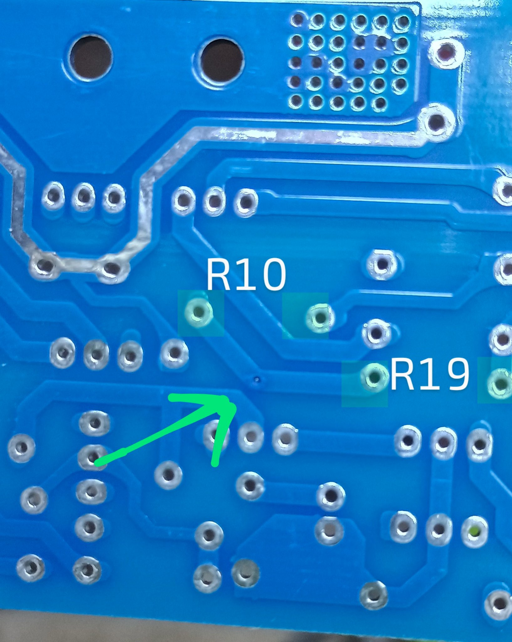

Hey sonicles, I did some poking around with the continuity tester on my multimeter. I did rather jump around a bit but the points with the same color are connected. Maybe when I have some more time I'll try a more systematic method. R19 is connected to one pad and to R10. R10 is also connected to the other pad.
R10 is connected to both pads, however, it is also connected to one pad in conjunction with R19.R10 AND the tabs give me an identical reading of 1003 Ohms making me pretty sure they are the very same.
Thank you very much "Sherlock". I have found that post too.I found this in another post.
I have found also a snapshot below in yet another post >HERE<.
Published by @dasoft
There is yet another very important post by @dasoft >HERE<
According to that post R19 should be 875 Ohms

Excellent and thank you Berlusconi. I am now tempted to simply select an 875 Ohm (or the closest available combination) resistor rather than bother with the trimmer. PS: 510 + 360 (in series) = 870 Ohms.... tested selections will achieve desired 875 OhmsAccording to that post R19 should be 875 Ohm

I have re-evaluated my opinions today and can say that anything between 800 Ohm and 1K will be OK for L12-2.
LJM is indeed a good designer. We do not appreciate that enough. Even with the default values, i.e. without any changes, his board will be able to attain theoretically decent values of bias current. Read the quote below to see why. One can adjust the biass to even higher values if desired. Higher values will elliminate posiible cross-over artefacts. This has potential to make the board perform even better at the cost of even higher heat dissipation. Frankly, heat dissipation of this amplifier is modest taking into account the power it is capable attaining.
