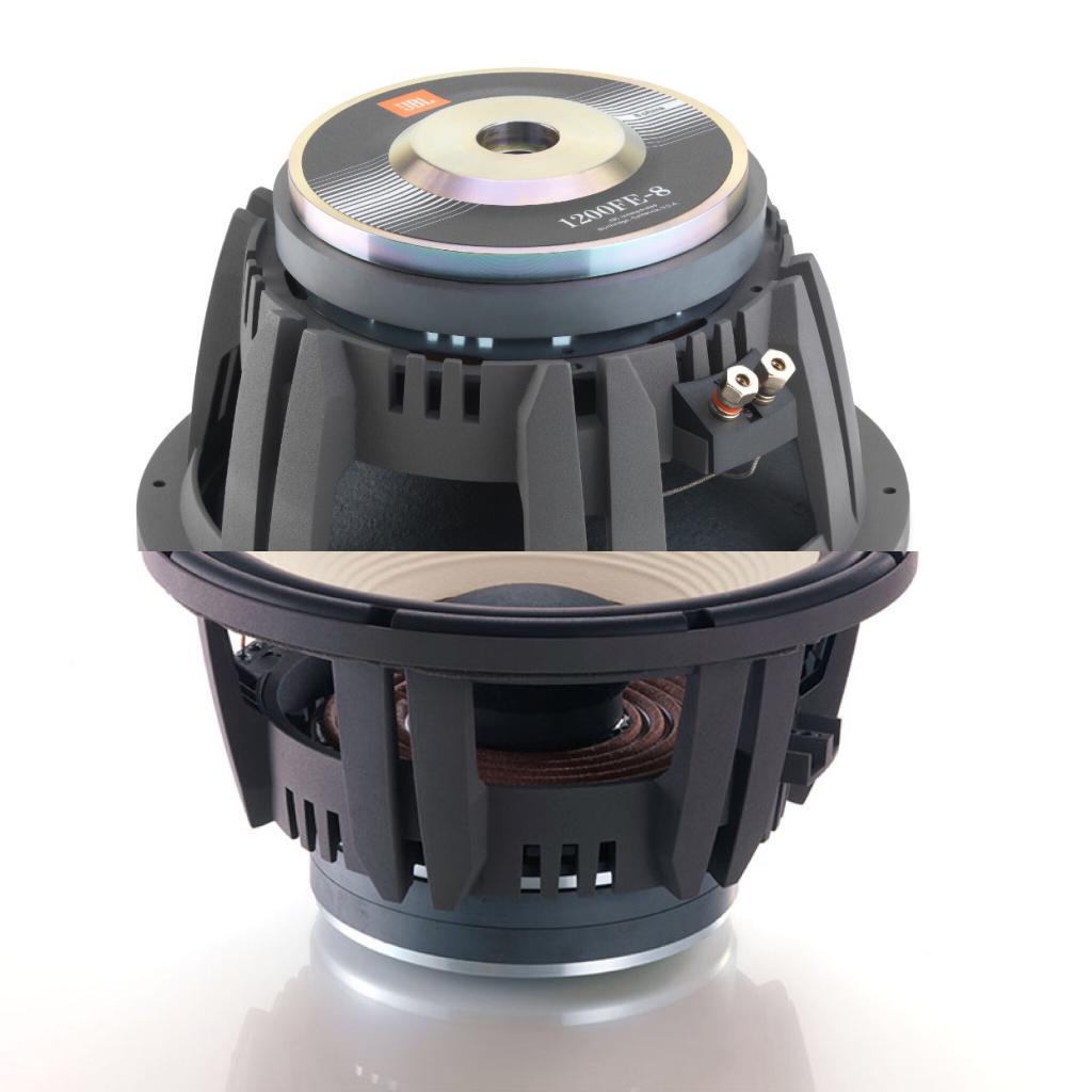

What you do is find an Auto sub-woofer with moderate sensitivity, low Fs, low Qts, high Xmax and decent power rating > very doable these days.
You cut and mount the sub. reverse style > magnet out, on the back of the enclosure. (this slightly increases the enclosure volume)

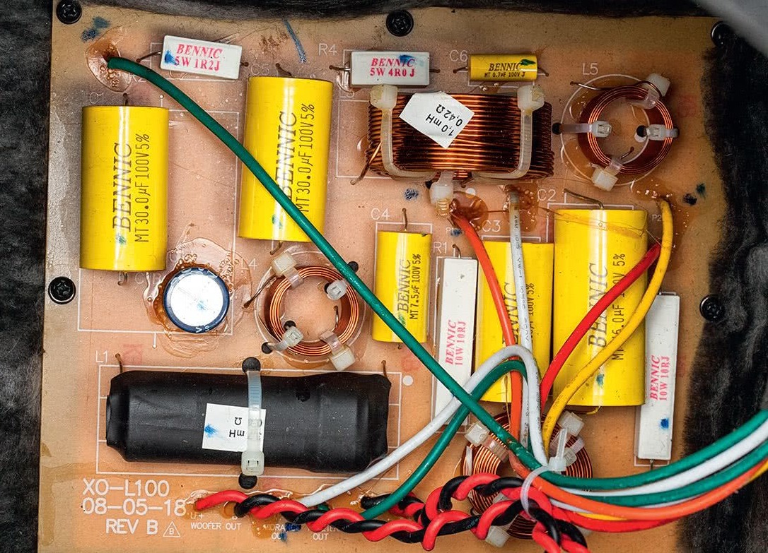

Without changing any existing XO components, you drive this sub. with a high mH inductor that has high DCR. The rough start is 12mH @ 6ohm DCR.
Although experimentation is needed, like stuffing or blocking the existing port, what you have created is a "Large low frequency Power Assisted port".
