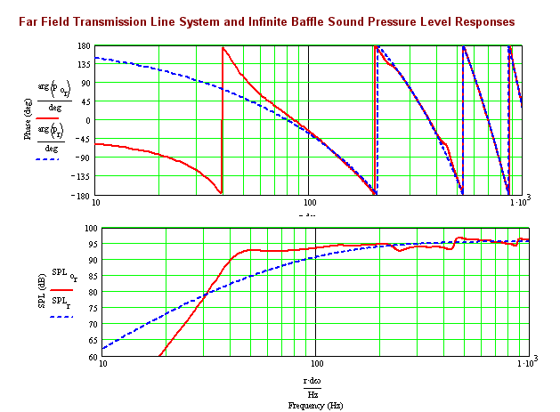

No, they were for the same straight, untapered MLTL I came up with before (Martin's ML TQWT sheet can model straight, as well as tapered enclosures you see). The only updated sheet I currently have is the Ported Box sheet which can't model tapered enclosures, so I'm using the current sheet for those, same as GM's using.
As you clearly like the tall ML TQWT enclosure (and why not?), I've played around with some dimensions a bit more. GM's fast tapering job looks like it provides the best response for the Corals of this particular tapered geometary with 2 ohms series resistance applied. However, if you're willing to increase that a bit to around 4 ohms, which isn't out of sight (I've used 10 ohms before now and as resistors are cheap, you can afford to experiement a bit!) then Martin's original ML TQWT enclosure, ironically, will also work quite well: http://www.quarter-wave.com/Project02/FE-164_ML_TQWT_Design.pdf
You'd just need to increase the port radius to 2" up from the original 1.5" Response rises somewhat, but the series resistance will sort that, and you need to remember the boost room-gain will provide -the room is the major factor low down, with box speakers at any rate. Frequency response of that enclosure is below. GMs generally looks similar, just a bit flatter.

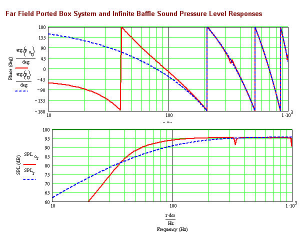

Just for kicks -- I realized I should have done it earlier -- I did a sim of Coral Audio's recommended bass-reflex box using the ported-box WS and GM's params. Even unstuffed (and minus 2-ohm series resistor), it looks like a surprisingly clean FR curve, decent LF, with just a couple of sharp dips (standing waves?). FR curve attached below.
The Coral dimensions: 10-4/5 (W), 20.5 in. (H), 7-2/3 in. (D)
The driver is mounted in a 7-in-dia baffle opening located 5-9/10 in. from the top. The port is located 4 in. from the bottom, and is a square of 2-3/5 x 2-3/5 in., and 4-in long. GM's params: Fs = 68 Hz
Re = 8 ohms, Lvc = 0, BL = 9.46 NA (calc'd), Sd = 214.0834 cm^2 (6.5" nom.), Rs = 2 ohms, Vas = 31.346 L, Qed = 0.433, Qmd = 5.671, Qtd = 0.494 (auto calc includes Rs).
Dimensionally, it's about the same as Scott's design (So, Sm = 90 in.^2), and about half as high (20.5 vs 42 in.).
As a start, would it be prudent (for a neophyte) to just build the Coral box, since it seems to provide decent LF response, especially if will be used in a small (bassy) 13x13 ft room?
And, this is just curiosity (and DIY fun): Next, once things settle down, would it be possible to couple the Coral box to a daline-type TL? There were a couple of threads re: dalines a few years ago, but nothing conclusive. GM outlined a personal system for such daline-type designs, noting that they require low Qt/Fs drivers (not exactly Coral's strengths). Some mentioned splitting the volume to 1/3rd box, 2/3rd TL. And, interestingly, MJK mentioned that he did not seem to have much success modelling the dalines with the Mathcad WSs.
Questions:
1. I was just thinking that if the daline experiment didn't work, I'd still be left with a pair of decent Coral boxes. Is this feasible, or would the basic Coral box just not work for a daline?
2. Will using a rear-firing port for the Coral boxes to accommodate (aesthetically) the daline TL be a mistake?
3. Can just modifying the length of the daline TL pipe enable one to tune the LF output to suit a room, or is this just my pipedream?
I'd appreciate any suggestions and advice.

MathCad isn't currently working for me, but in theory, 19.30" x 11.93" x 7.37" with the driver down 8.93" and the vent near/at the bottom will be even smoother, though probably not audibly so, especially once a little damping is used. Anyway, the notches are the vent comb filtering with the driver's output, so easily damped.
Whether to build them or not is up to you. It's simmed response assumes it will be ~up against a large wall at ~ear height, making it much more rolled off perched on stands well away from any, so it boils down to how much efficiency you're willing to trade for a ~flat in-room response.
Yes, you can convert it to a Daline tuned to ~48 Hz, though all things considered, bottom firing seems the best option. Typically, damping the vent exits is the way to fine tune them to the room, just like a TL.
