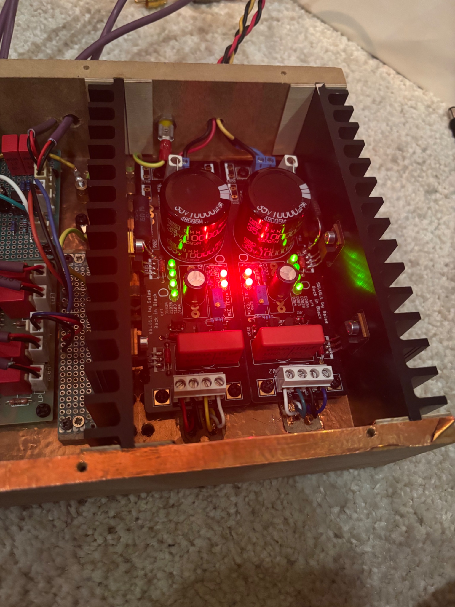

It’s been on in idle mode overnight en everything looks stable. Vin goes up and down some 100-150 mV with mains fluctuations and Vout is 5,075, what I dialed it to yesterday.
Now playing, sounds great. If there is improvements, which I think, is hard to tell since I have products in the chain later that needs to be changed to less noicy stuff. Maybe I can hear some blacker background, or maybe I’m just happy it works 🙂
Also I don’t know how to measure it since it has no analogue in.
Now to a combined PSU for this and an L-Adapter fed network switch in one case to be constructed.

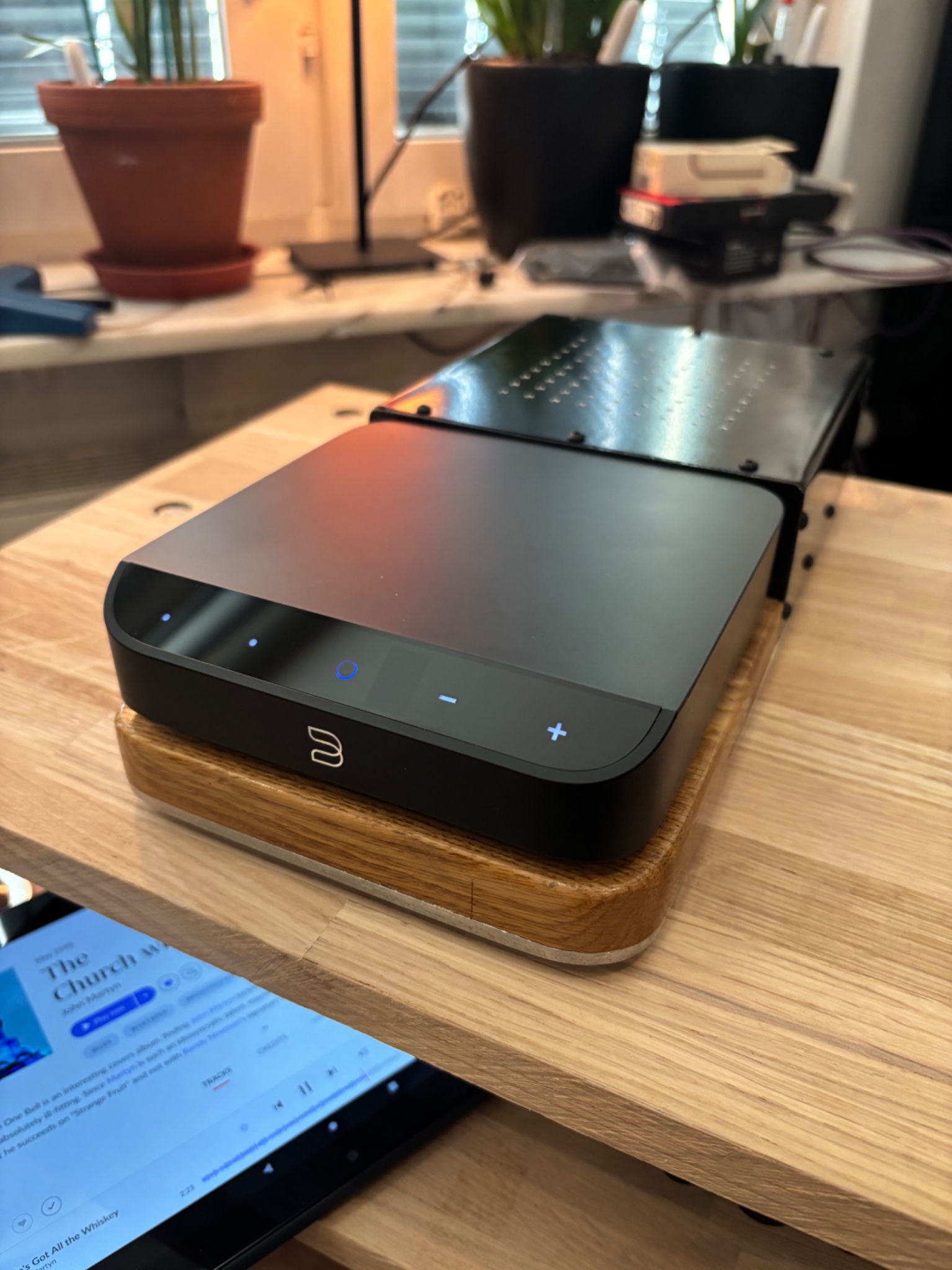

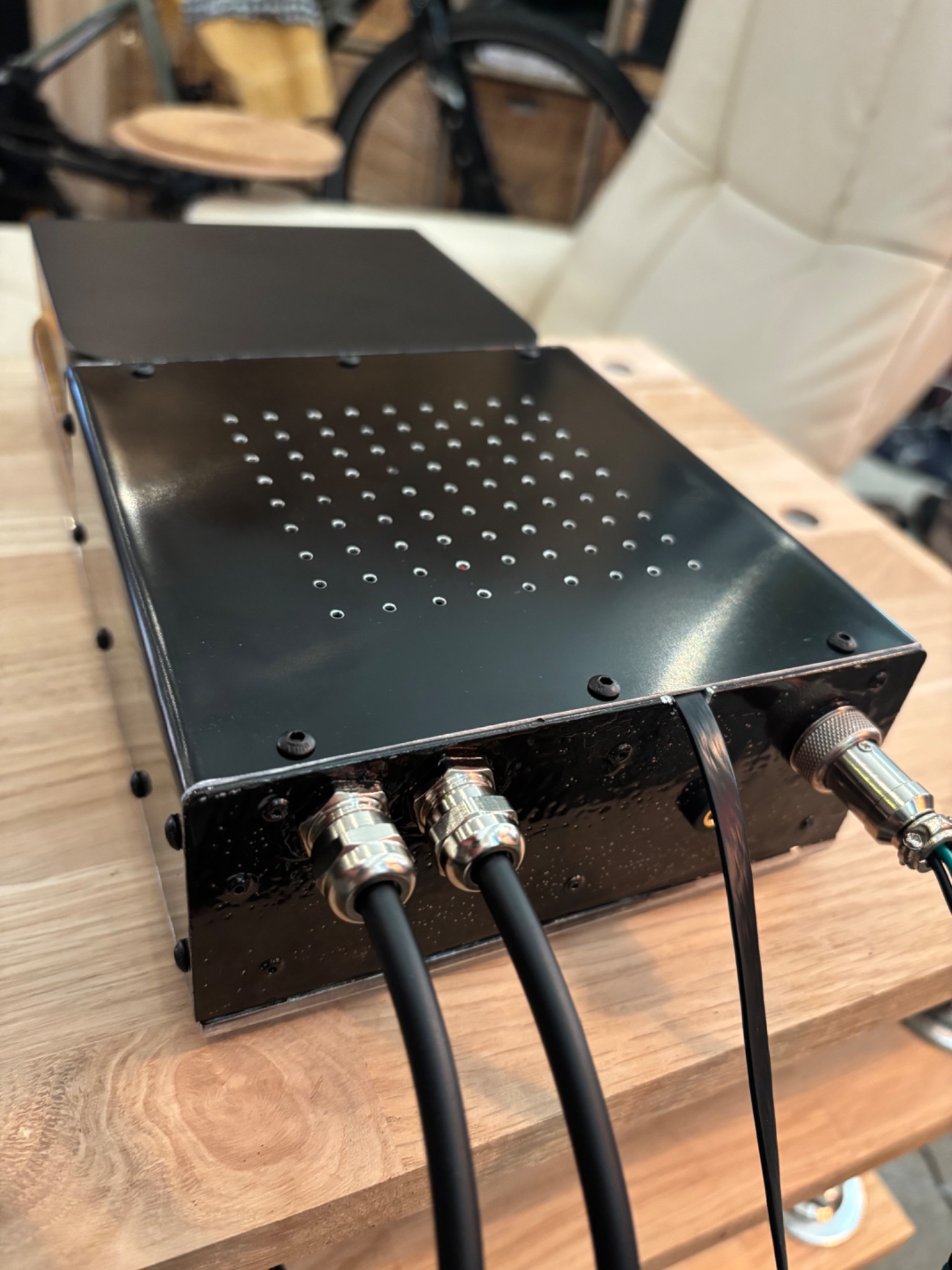

Some pics how the ”Node Nano Docking Adapter” looks like lidded. I think it became pretty slick.
Ethernet and Mogami 2524 passing right thru, the Mogamis I locked with pass through lock things, usually used on boats for watertight cable pass through.
Will make a shielded interconnect current umbilical as well.

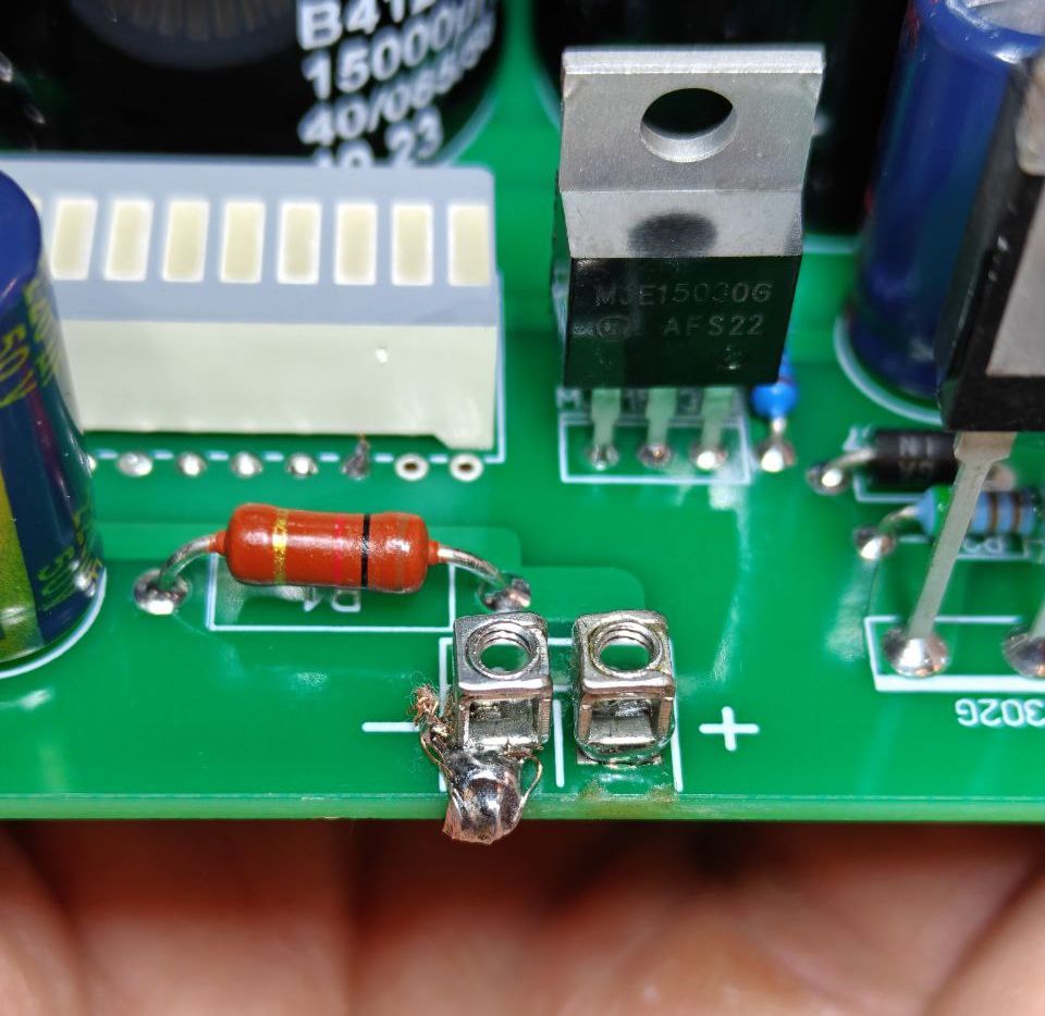

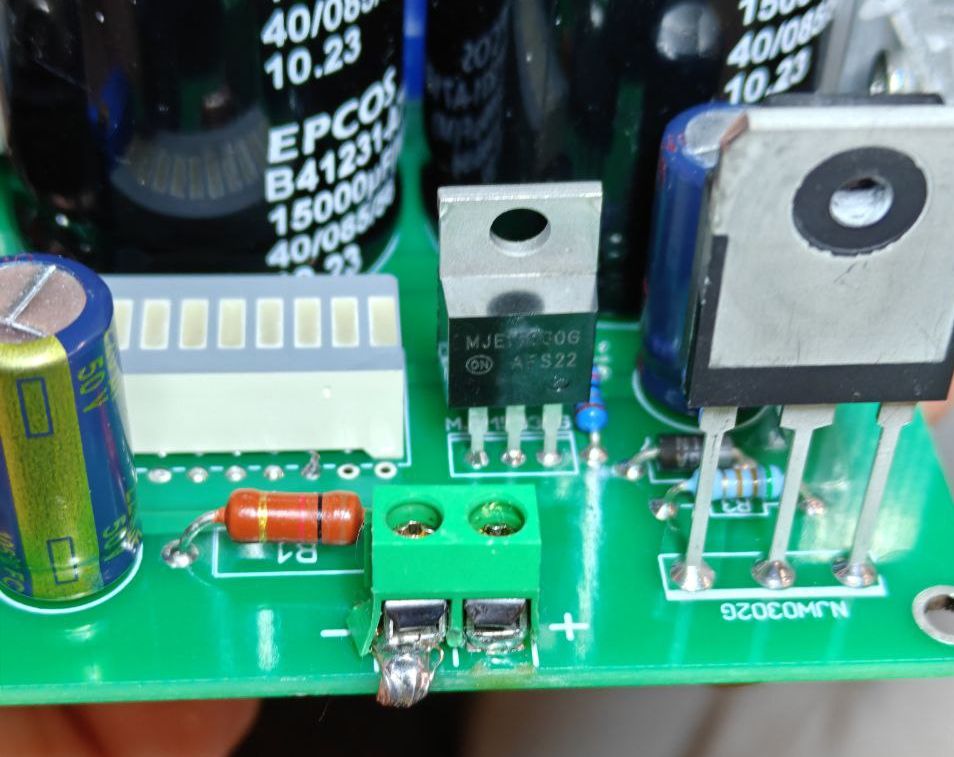

One more note about high current output in L-Adapter: if needed 3+ amperes, then must take care about output terminal blocks. Cheap aliexpress blocks could handle up to 3A, for more amperes I added more solder under blocks:

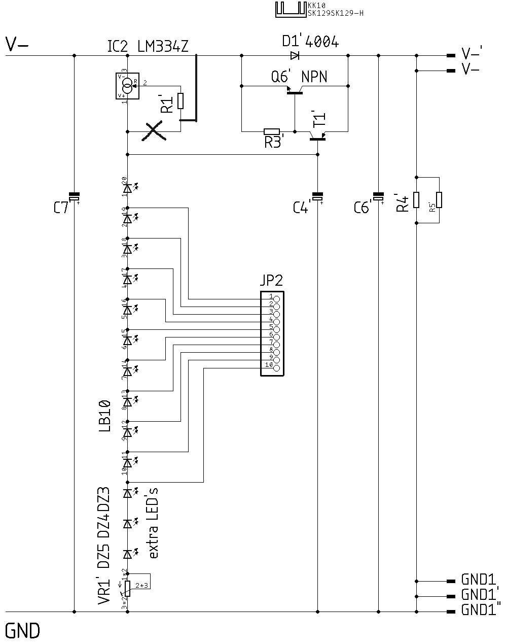

I did not also publish a mirror negative version. I don't know exactly how you have in mind to do it. What is your modification schematic? Somebody could stack dual positives when using dual independent secondaries trafo, with a virtual ground output midpoint like when we do symmetric supplies out of batteries or lab PSUs of independent power channels.
Hi Salas,
I build the negative voltage of L Adapter ..... and it works!
The schematic is the one of post #624 by prasi, the Indian guy.
In that schematic there was an error in the position of 12R resistor, that you have pointed out.
The resistor have to be located between V- and R and NOT between R and V+
I used the NPN BJT NJW0281G (complementary of NJW0302G) and the PNP BJT MJE15031 (comp of NJW15030).
Voltage ref with Zener + leds for -33V at 200mA
I put the dual L Adapter before the ultrabibs in my preamp, cause L Adapter + ultrabibs have better sound that only ultrabibs.
Buona notte
Orelli
