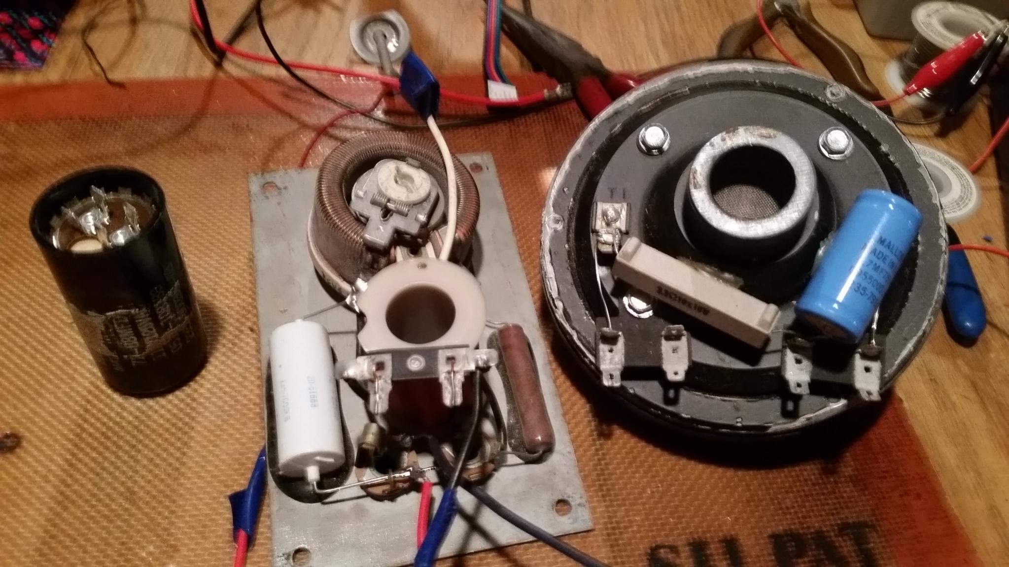

Kustom MT15 with EV T35 and EV 1824. Gollehon MR90 crossovers were added at some point. Both cabs are DOA but all but 1 T35 drivers are OK. No continuity through the white part on the lower left. Not sure what this even is, all the markings are serial/mfr data best I can tell. No markings on brown (cap?) or inductor either. From my noob crossover knowledge it appears the large cap to far left (black) is 77uF and good for 500hz HP? (due to 2 T35s @ 8ohm/first order) and the curcuit on the 1824 might be HP for T35’s (cap is 4.7uF/first order?) so maybe I can bypass the Gollehon altogether at least for now? That said, I would like to get the MR90 fired up… Could the white part be a fuse? Lastly, gonna run those mid horns with EVM 15L's. Do I need to LP? 2.5mH inductor? For now I want to keep it passive...

Sam,
The brown part is probably a wire wound resistor.
Don't know what the white part is.
The 77uF cap was probably just used as DC protection, and is probably dried out.
If you want to re-use the components you will need to measure them to see if they are still working properly.
I'd suggest copying the crossovers used by the Klipsch Heresy II speakers that use similar components, but that still won't be right for your mid horns or 15", but closer than the jive pile you have now.
With a steep filter, one T-35 per side will get plenty loud for home use, and are more sensitive than the 15L.
Art

Think I made a little sense of the old XO circuit. Tweeter HP circuit is on mid horn and appears to be first order near 4kH (4.7uF) with 3.3ohm resistor for attenuation. The midhorn circuit is the gollehon XO. I had this backwards in my mind. Circuit appears to be 2nd order @ 550hz (43uF measured prolly a 47uf) but cannot measure inductor to be sure. I disconnected the "white thing" and it was a cap and within spec. Little did I know that caps do not pass continuity... The brown thing is a resistor and in spec at 4ohms. Thinking I will wire this up removing resistor to run one tweeter and reversing polarity as 2nd order. Leave gollehon XO alone with resistor in circuit as mid horn is 2db hotter (107db) than tweeter (105db) on paper. Woofer is 105db average per hornresp sim. Will remove the 77uF cap, it is way off too... Then I need LP to 15". Looks like 2.0mH + 47uF gets me 2nd order LP from 650hz. If this fires up and get me near anything doable I might be confident enough to order the parts for the LP filter and if that works I might tackle the Klipsch design. Starting to get dangerous with XO circuits now... Still a little grey on impedance with resistors when using online calcs. IE - 8ohm driver and 3.3ohm resistor. 4.7 > 5 ohms right?

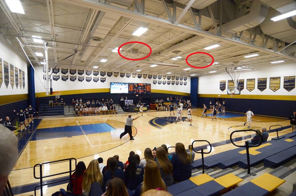

Started thinking about this and maybe a better direction would be to clone the EV XO circuits. X8 and X36. https://community.klipsch.com/index.php?/topic/72382-electro-voice-x36-datasheet-attached/ I suppose some measurement gear is in order too if I continue to tinker. In a similar note, I have dilemma. I was brought in to consult (as an old band guy) for a new PA system of local high school. Mostly just looking power ratings etc. My understanding EV rep did the engineering. Recently attended a function and it sounded very out of phase. Would love to bugger around and get to the bottom of it and curious what tools would be necessary to debug. I swear it sounded so out of phase like if I reverse a terminal it will come alive. Maybe a kid swapped a cable or maybe the cabs distances are off.

Main reason I am putting off REW is the learning curve. Costs are reasonable. Yep, system is flown... Truly a professional's job. I just want to identify the need to get one. I should be able to get behind the system tho. First thing I going to figure out is if it stereo and try some panning at least if something obvious shakes out. Anything blatantly off? Speakers are in pairs back to back.
The picture is too low resolution to see any detail of the cabinets, and the angle is such that it is hard to determine if they are covering the listening area without excessive inter cabinet overlap, so can't say whether anything is "blatantly off". The cabinets are likely a two way, horn along side of a cone driver, which puts the off axis lobe/dips in the horizontal plane. Considering the width of the coverage area compared to the depth, a vertical orientation of the same cabinets (possibly requiring rotating the horn, if that is an option) would likely give better sonic results, but would hang down further, compromising aesthetics, and create a more likely basketball target.
