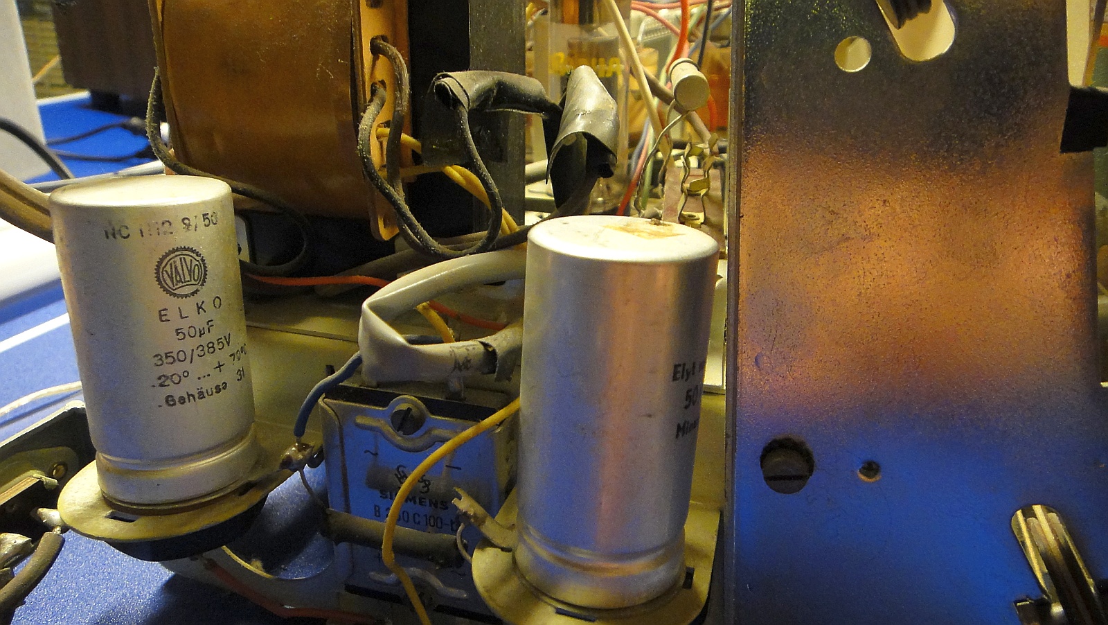

Unfortunately - the only electrolytic caps I can see are the power-rail ones (3 x 50uF/380V), it does have discrete Graetz bridge rectifier by Siemens, everything else seems to be non-electrolytic - is it possible?

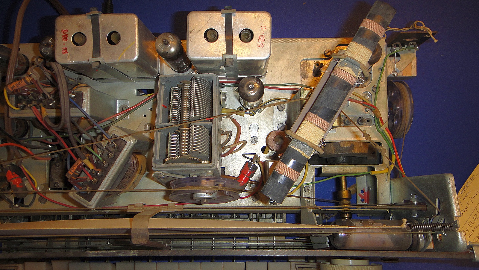

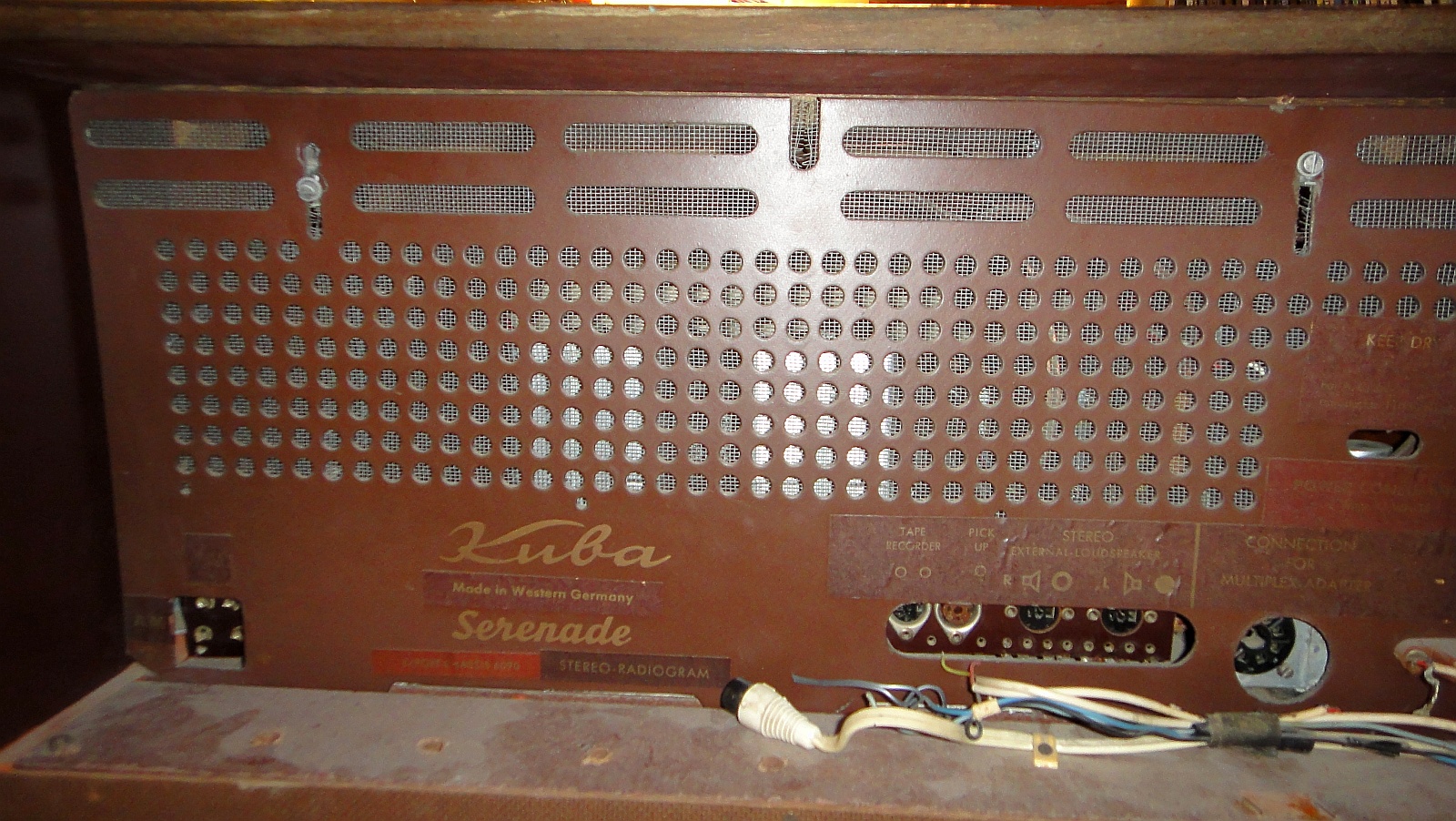

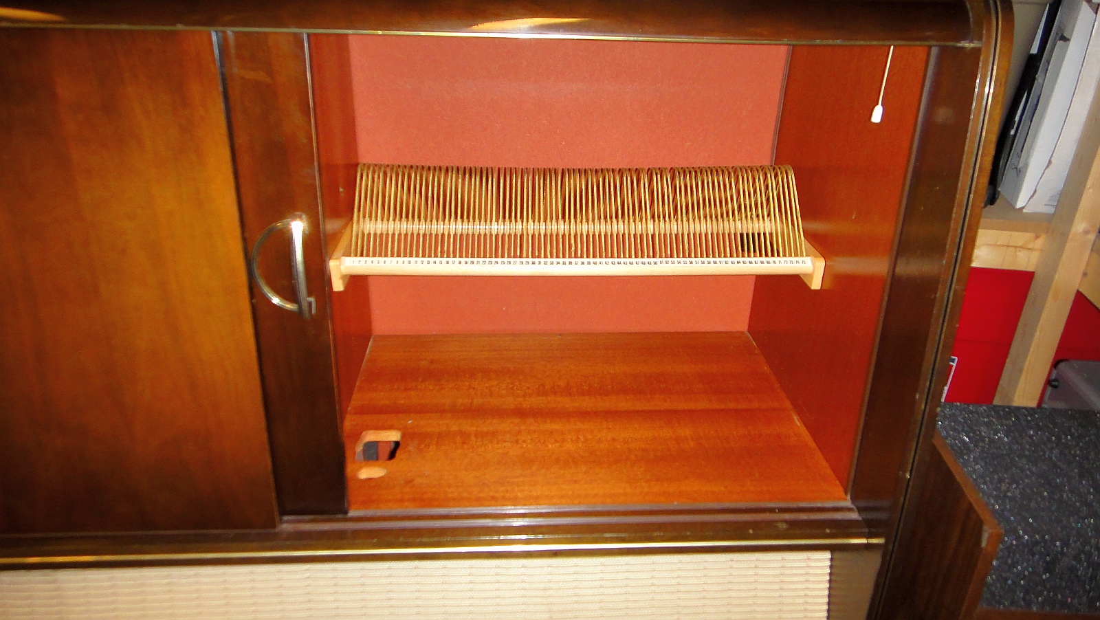

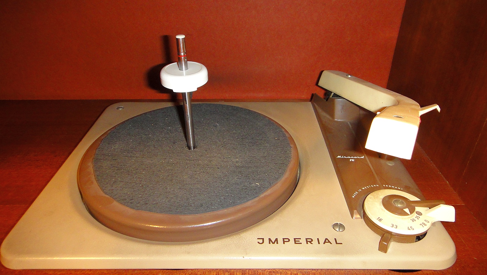

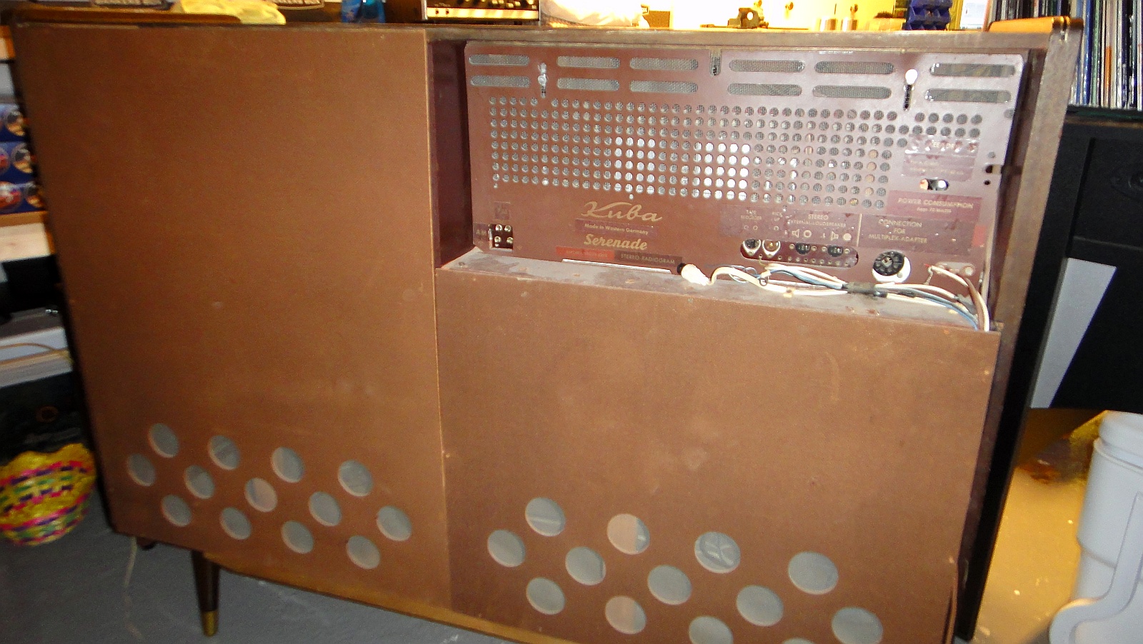

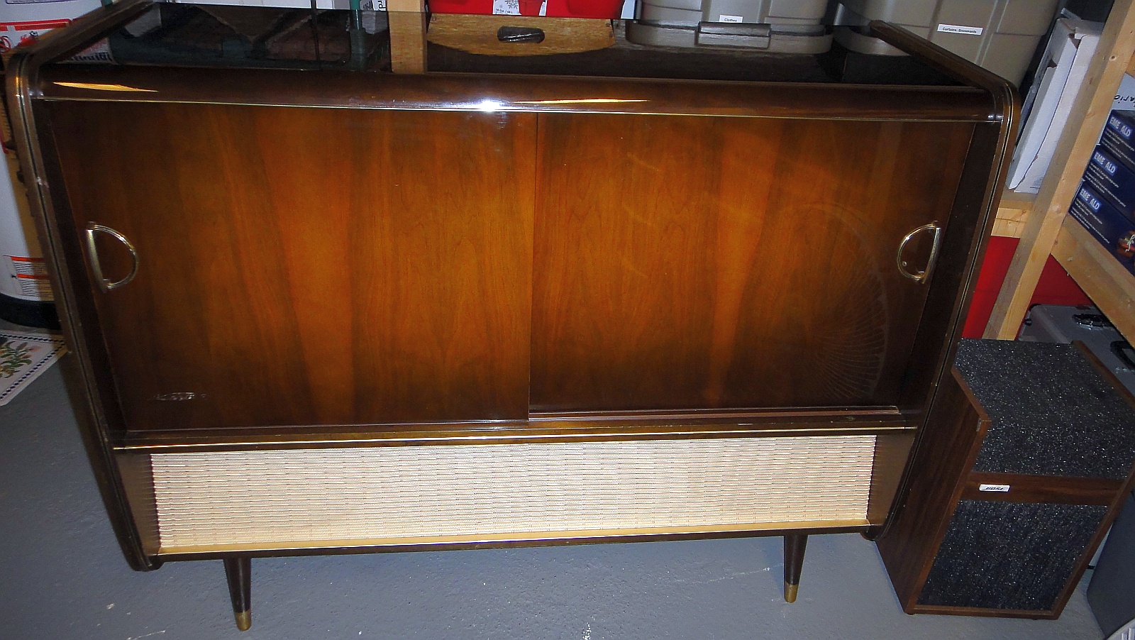

OK, the details - first,I am attaching first the general front/back Console View’s photos here...

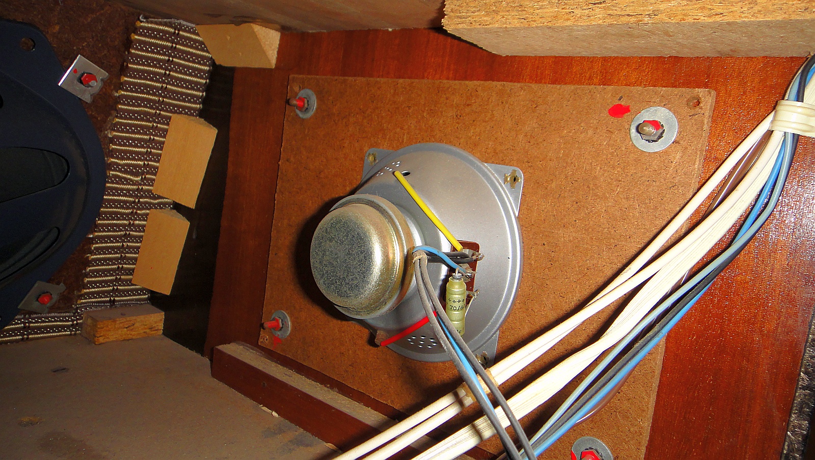

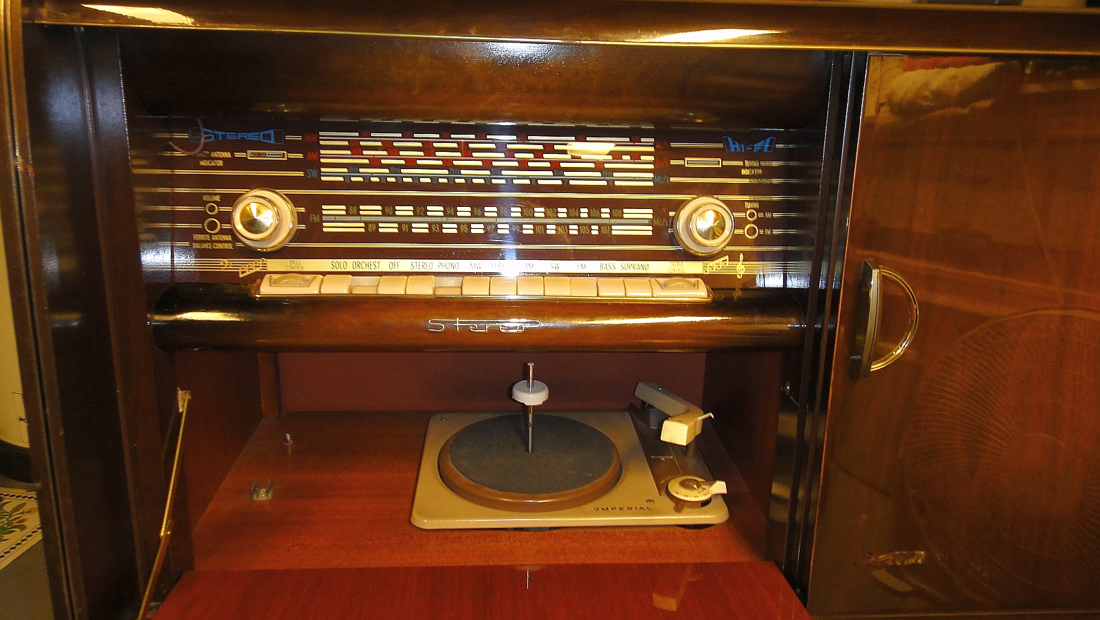

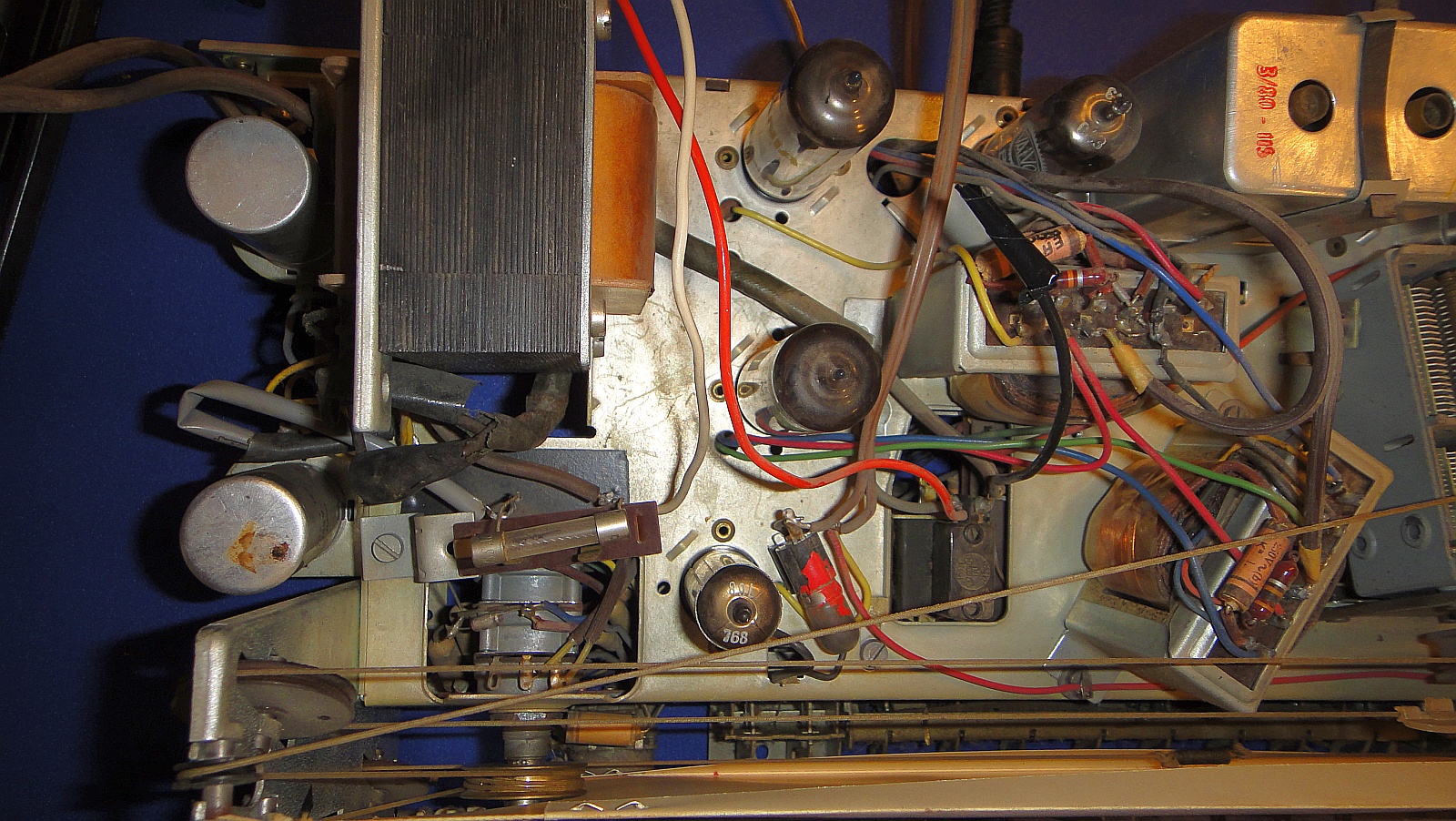

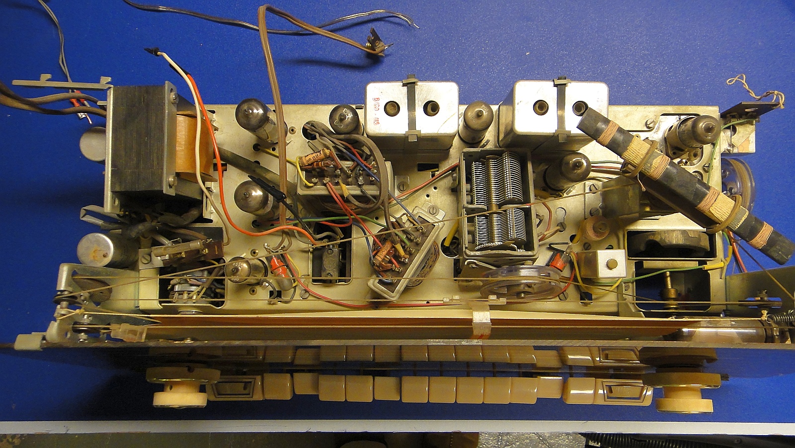

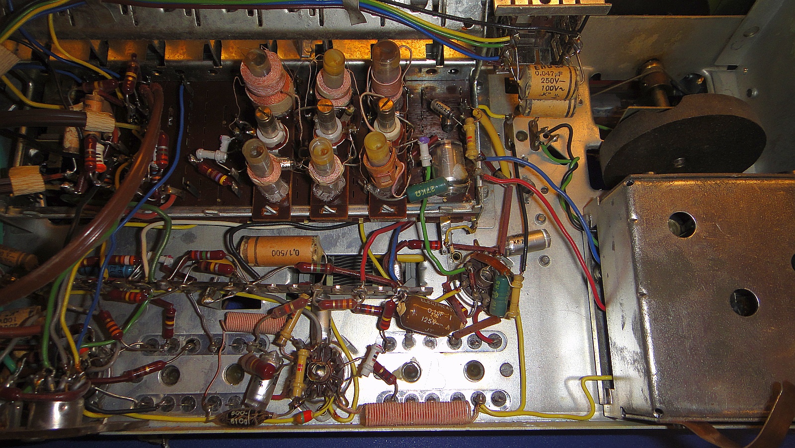

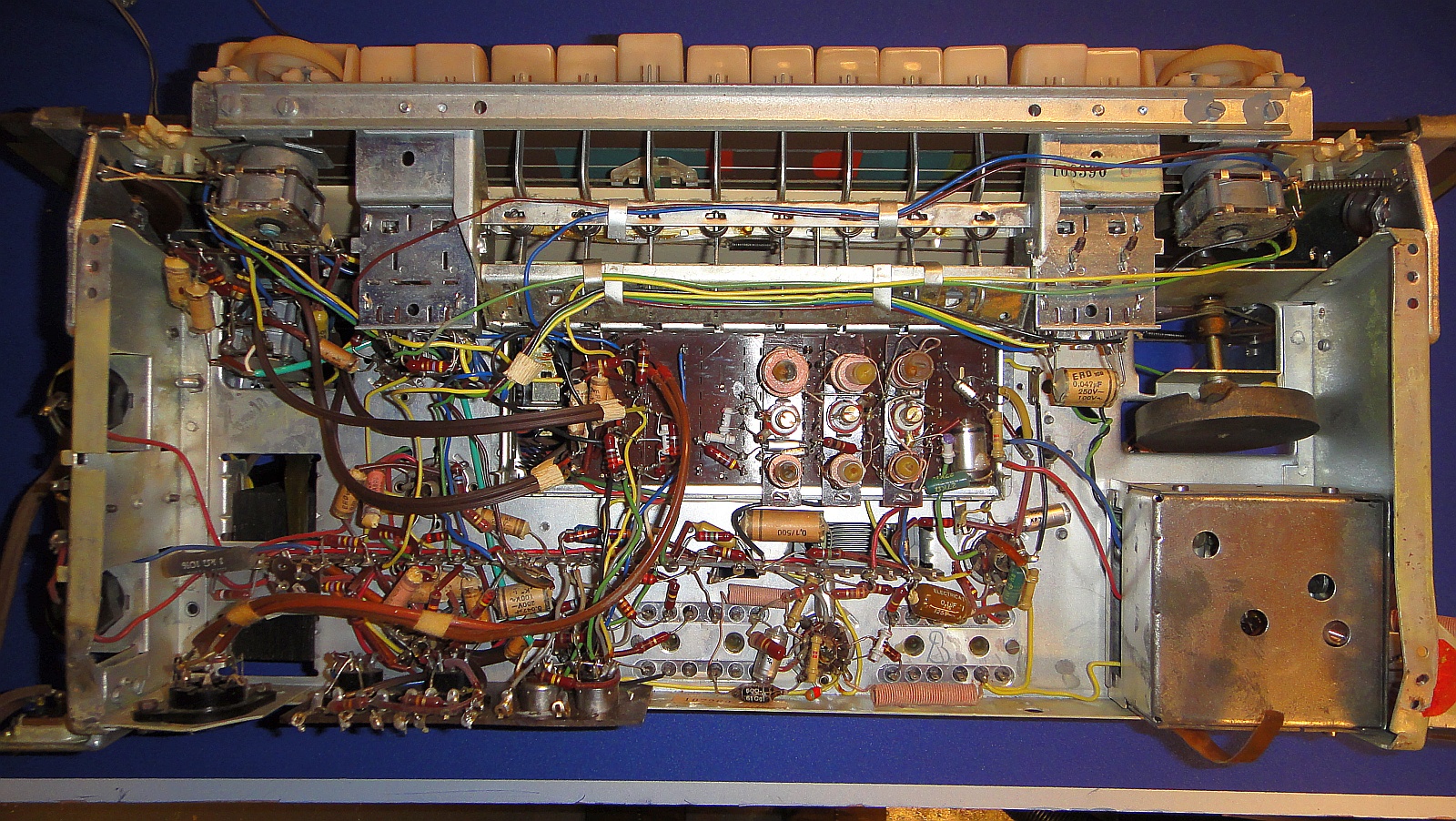

... and now the receiver's photo with the details.

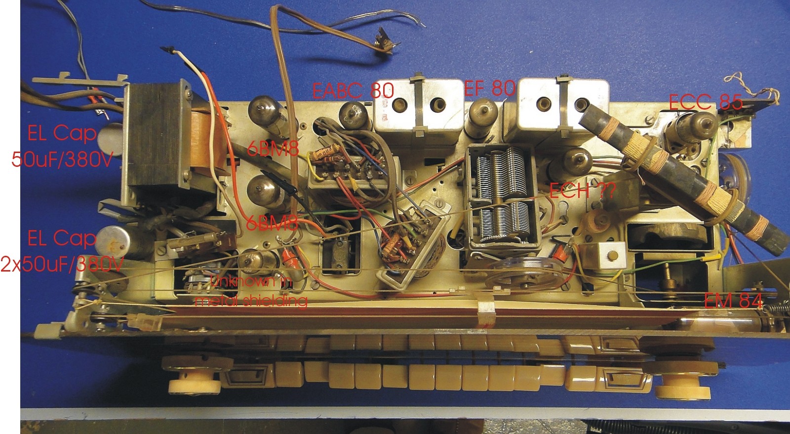

Also- here it is the list of tubes:
1, 2. Stereo amp – 2 x 6BM8 (Sylvania)
3. One unknown (in irremovable metal shield, no labels)
3. EABC 80 (Valvo)
4. EF 85 (Valvo)
5. ECH ?? (Valvo) – the number is erased...
6. ECC 85 (Lorenz)
7 EM 84 (Lorenz)
I have created one photo with tubes' position for easy illustration.

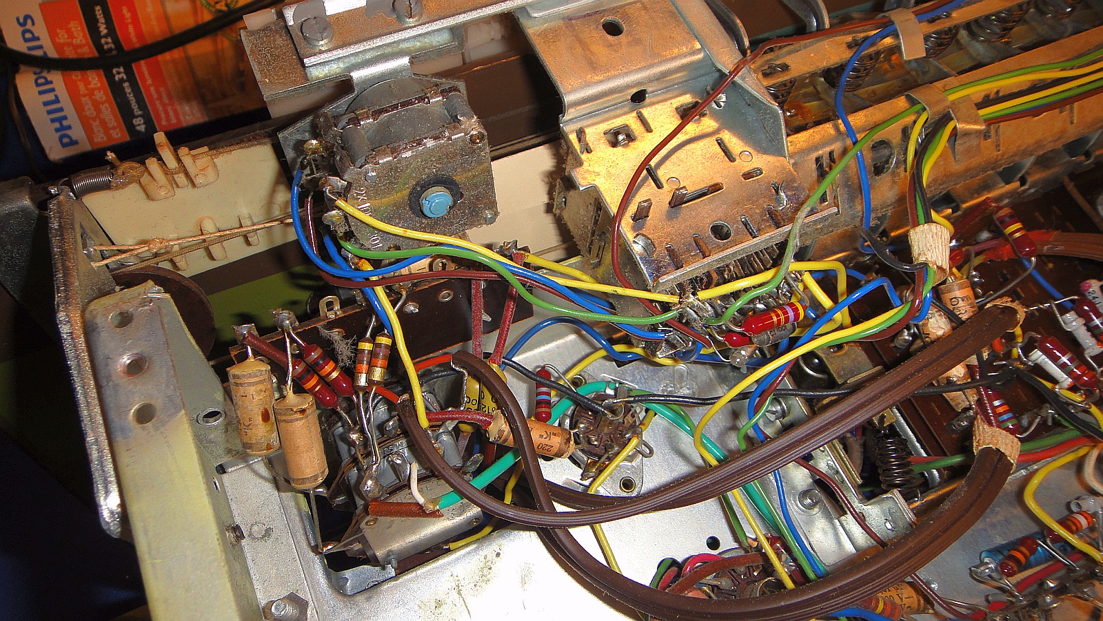

Basically I have the following issues with this unit:
1. One of the amp's channel works (almost) fine - just some overpower at max volume. But the other channel is very week to non-existent. Changing the tubes doesn't make a difference, so the two amp tubes are fine. The balance works and makes the difference on the working channel. Bass and treble setup works fine.
2. On AM I can find one station only and it's very, very low volume. Clear, though.
3. On FM and MW - nothing. Tuning Level Tube (EM 84) is lit, but doesn't make a difference when rotating the dial.
4. Turntable moves, but I guess is irrelevant as it's sapphire - it'll be replaced with "new" vintage one anyways.
5. With one channel working and on internal speakers, when connected to CD player - the sound is full, rich, clear and powerful.
Questions:
1. Am I right about the only two electrolytic caps at the left? Anybody see others?
2. Any chance to have a similar schematic?
3. I can run a test signal and trace with a scope the signal to workout the missing amp channel, but have no idea how to approach FM and MW troubleshooting. I started my electronics degree around 25 years ago, when the tubes are out of the alumni already, so no tube troubleshooting experience, so be patient with the newbie... 🙄
Thanks in advance!😀

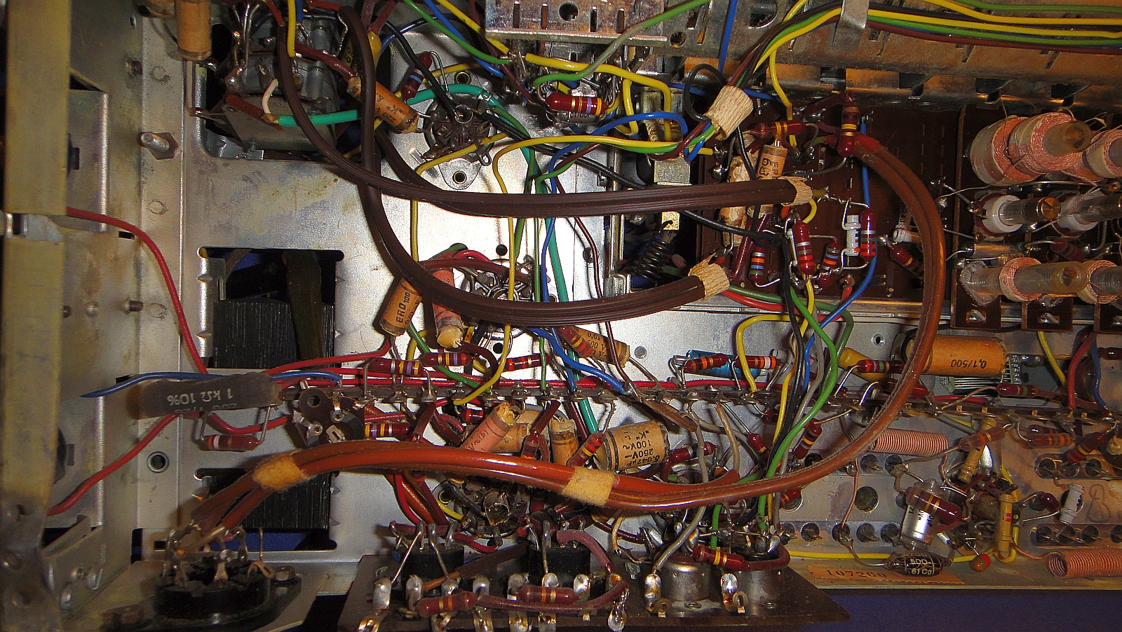

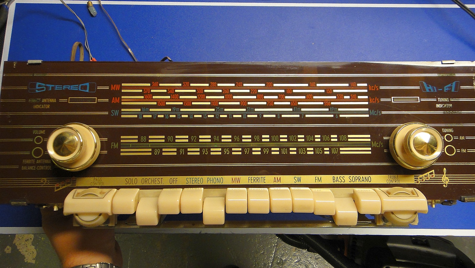

2X 6BM8s tell us you have about 2 WPC of SE pentode power.
The reason FM doesn't work is that it requires an external unit. As is, it's AM only, for radio. The tuning cap. is 2 sections, with many plates. That's a dead giveaway. You also have the DIN connector on the back panel.
The Benjamin/Miracord record changer will not damage the center holes of records. The arm is the $64 question. Can a decent mag. cart. be mounted in it, along with holding the tracking force down at a reasonable level? The cart. in situ is definitely a piezoelectric POS, which actually destroys records.

No. Permeability tuning for FM was common in Europe at this time. I think the photos show a piece of dial cord heading for the FM tuner. The presence of an ECC85 is a dead giveaway - this was the standard FM front-end valve and almost never used for any other purpose in domestic equipment.Eli Duttman said:The reason FM doesn't work is that it requires an external unit. As is, it's AM only, for radio. The tuning cap. is 2 sections, with many plates. That's a dead giveaway.
My view is that it is almost impossible to do 'remote debugging' of RF circuits unless the local person already has some knowledge, experience and test equipment. Audio is simple by comparison.

The unknown valves will be ECH81 and, probably, EZ81. I am surprised that the EZ81 has a metal shield - this may be to aid cooling.
You probably have a standard AM/FM mono receiver with a stereo amplifier replacing the normal mono audio section. The circuit will be fairly standard so if you can't find a specific service sheet you can get a rough idea by looking at anything else from the same era.
DF96: in the photo with the two big electrolytics you can see a flatpack rectifier. So probably not an EZ81.
The tube in the shield seems to be of smaller diameter than the EABC80 and ECL82. That makes me guess it is an E ninety something. It does not need an EAA91 as it has the EABC80.

One last question – nobody saw any electrolytic caps, right (beside the two big “bottles” at left), right?...

OK. Yes it seems to be a B7G. Two pins are unused, so with two for the heater that only leaves three for the circuit. It appears to be connected to the volume control. Need to take the shield off.
I'll try to remove the shield, it has to be cut off with Dremel or something - it's too tight and seamless...🙄
You said it may control the volume... of the amp part or something with RF? And what the next step would be with this tube?, how it'll help?

The B7G is probably an EC92 (same as half an ECC81). See Mamba Ch= 609a Radio Kuba Imperial; Wolfenbüttel, build which looks similar.
Unclear what this does. The triode in the EABC80 is different (that is more like half a 5751), although similar mu. I suppose they could be used as a stereo pair, but an EBC90 would be a better match to the EABC80 triode.
