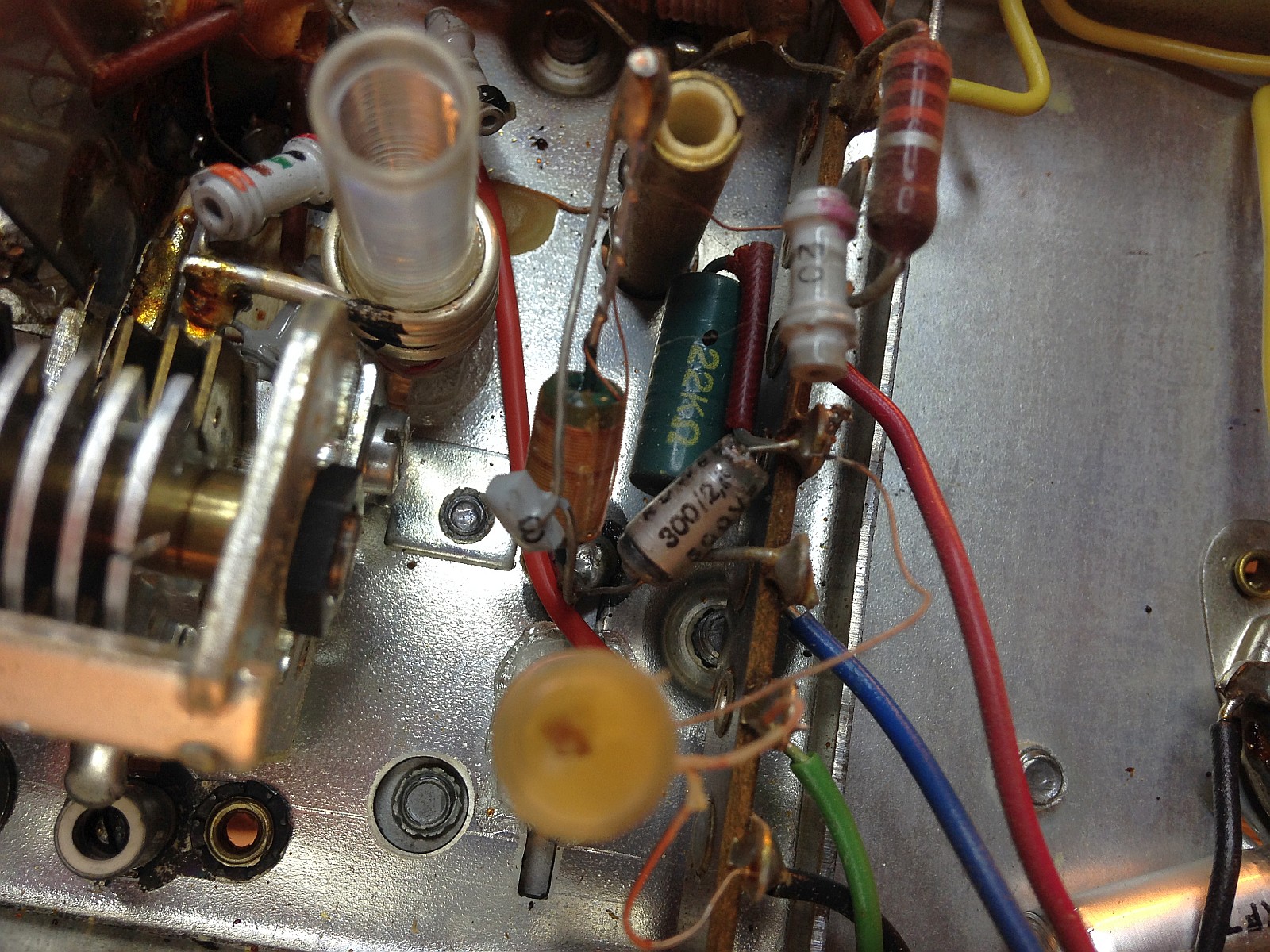

This is the biggest cap of the type (film cap?). The label have been burned out originally, what I can see is "...000J" on most right side of the label. When removed the cap showed around 7 nF. Should I assume the value of 10000pF (10 nF)? It's in SW radio rail, but at least on the schematic I can't find cap with such a value... do you think 10nF should be fine?

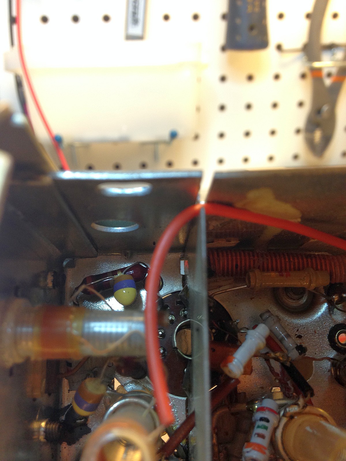

A) The cap with color code at the left. I did my best searching the codes (I assume it's Ceramic Camp?) and I am reading it 15 pF/200V. Am I right? Should I replace it just in case or to remove and measure?
B) The black cap at the top (assuming it's a cap). It reads 4700, 500- 61C. I am reading it as 4700 pF, 500V DC, 61 degree rating - am I right? The problem is when removed and measured - it shows around 225 nF. Any ideas whaty happens here, why it's such a huge difference in measured and listed value, leak, dry, short...?

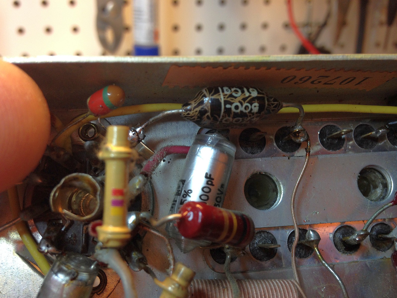

Th two color coded caps - as on Photo 2 - I am reading them as 46 pF, 300V, am I right?

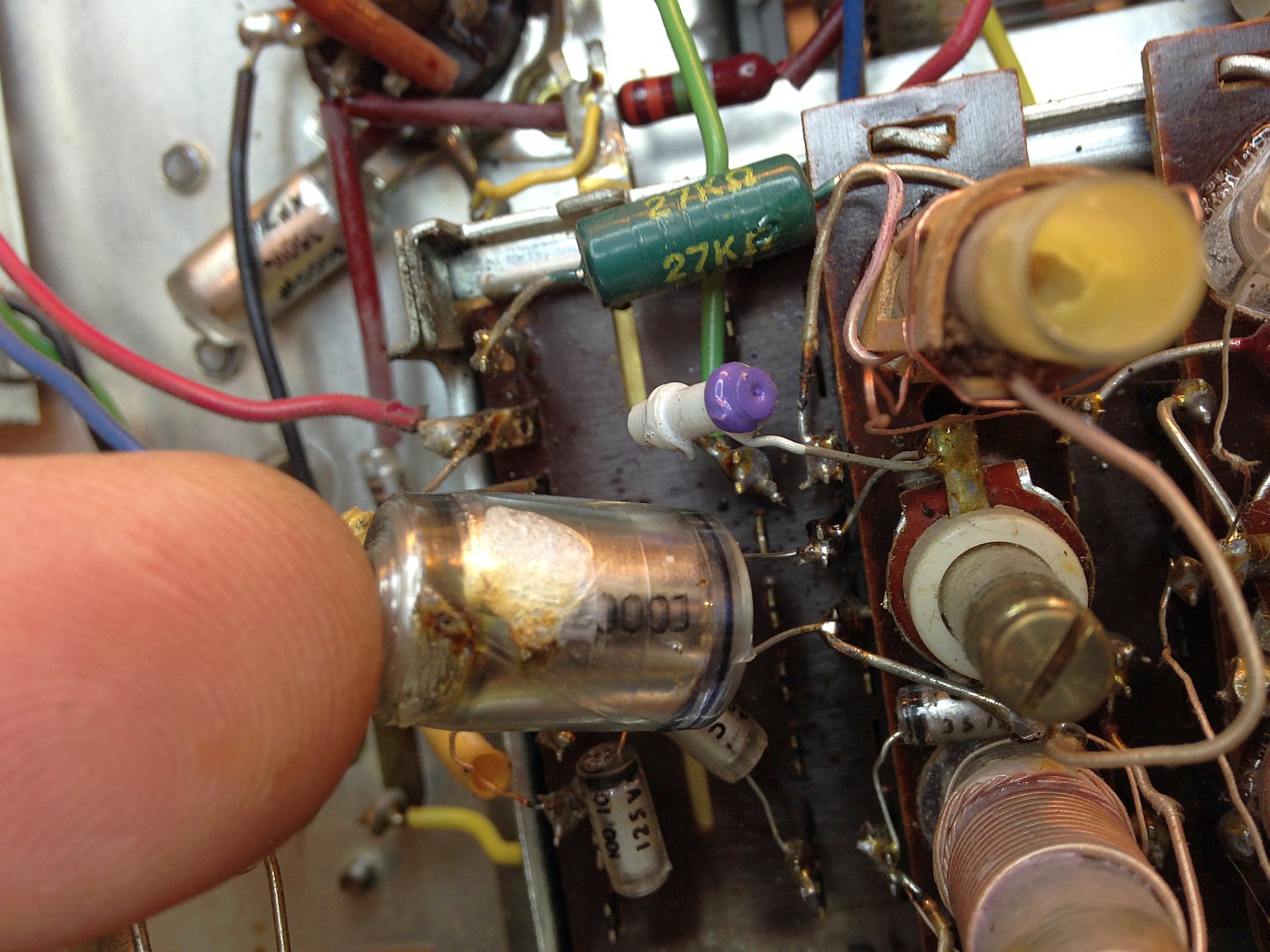

This is the biggest question - you can see one cap I am reading as 300pF/500V, one green inductor (with wire on it) and one unknown gray component with only marking "3" on it. Any idea what is it? Note - it's in FM section which doesn't work, so I am trying to eliminate any suspicions component.

#1 is a small value polystyrene capacitor.
#2 A: Looks like a resistor. I might not be looking at the right part though.
B: looks burnt, so one would not expect it to measure accurately
#3 Confirm with a capacitance tester.
#4. Measure the thing with the "3" with an ohm meter, then resort to capacitance check if needed.

Generally speaking, there is no need to replace ceramic caps. I never had a faulty polystyrene in my life and restored lots of those radios. Just the burned one is a problem, I agree.
One you HAVE to replace is the black one in the second pic. Thats a real crap. The reason for the high capacity is as follows. The old resin becomes faulty and shows lots of cracks. Water vapor enters the cap and the paper dielectric. But: Water has a very high ε and thus increases the capacity. Sadly it also leads to leakage currents !
