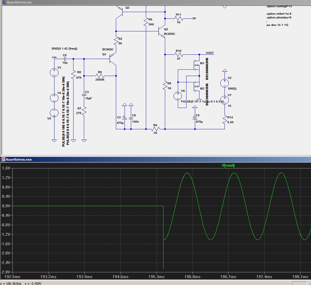

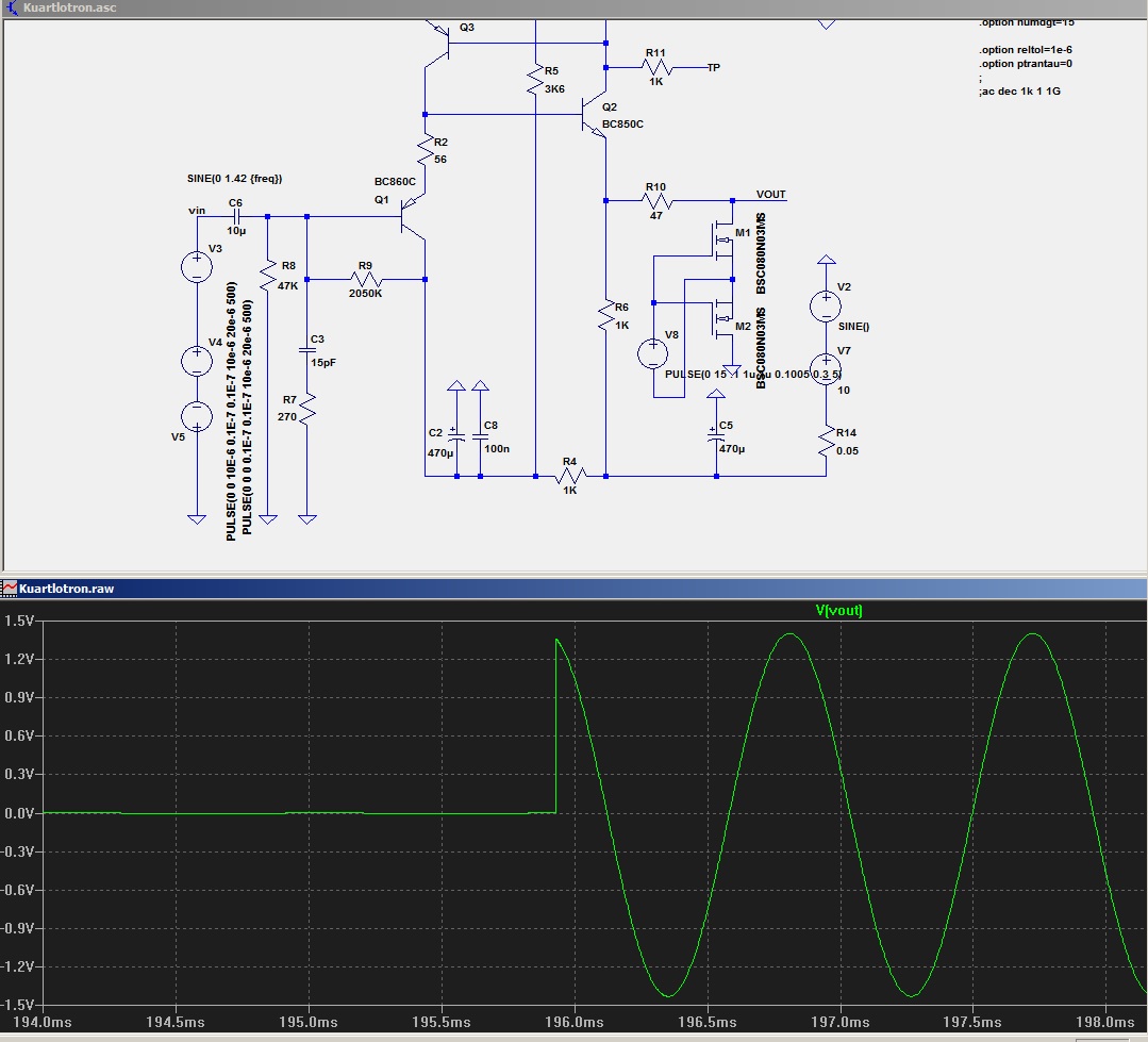

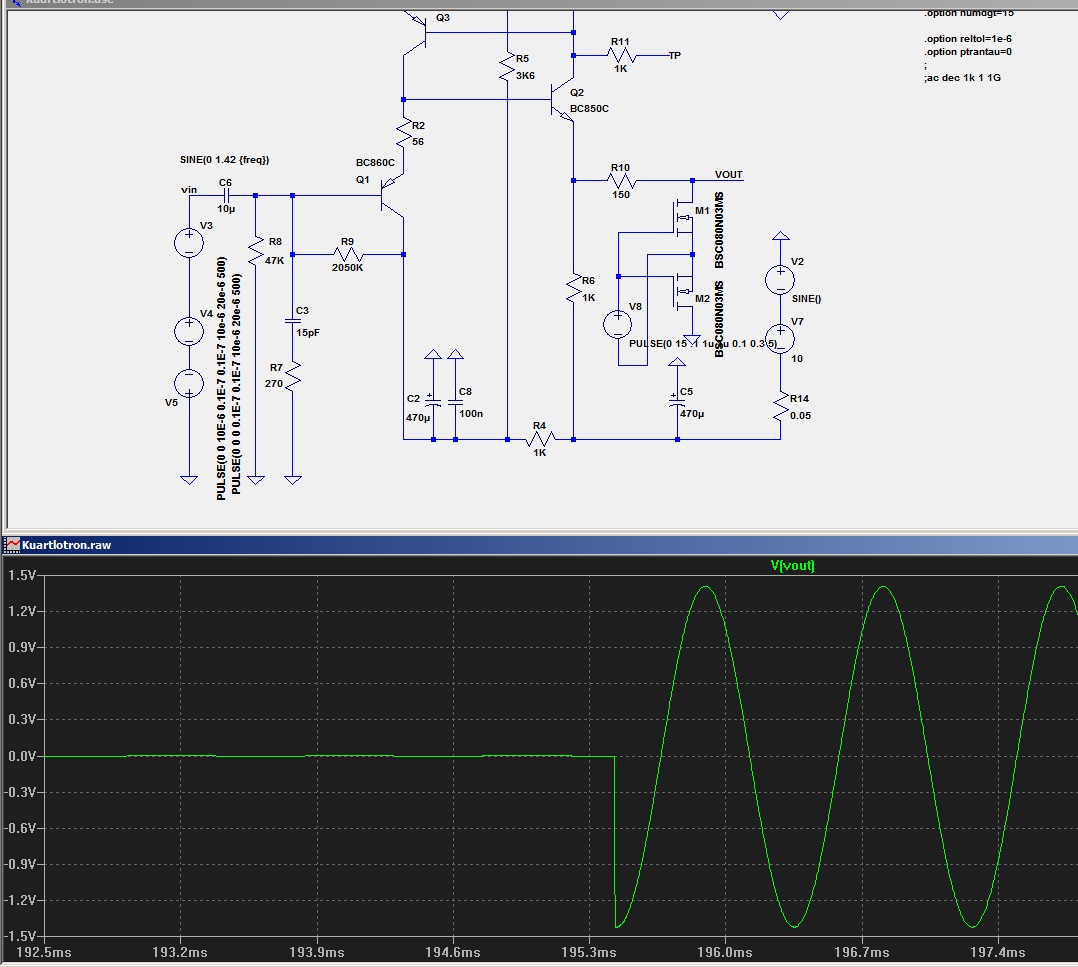

I simulated the behavior of the buffer recovering from cutoff at the moment the muting is released. I put in a pair of MOSFETs wired up as a solid state relay to mimic a relay contact. The signal level at input is 1Vrms.
First picture is for R10=150 ohm, no transistor cutoff,
2nd picture has R10=47 ohm, transistors cutoff during part of negative cycle, but muting releases during positive cycle.
3rd picture also has R10=47 ohm, muting releases during negative cycle in the middle of transistor cutoff
The spike in picture 3 looks bad. It has 2uS at its base and the amplitude can quite possibly drive a power amp to clip if the LPF at the power amp input isn't aggressive enough.
So what are the options that we have for the muting?
1) increase R10 to 330 ohm and there will be no spikes up to 2.33 Vrms at the input. The buffer will then end up with an output impedance some would wish lower.
2) scrap the shorting to ground scheme and leave the relay contact in the audio path, as it is in the current layout
3) any other ideas?
3) any other ideas?
3) Use output caps, shorting to GND won't be a problem then. Text in BOM:"only install muting relay when output caps are used"....
Or leave it like it is now and use excellent relays 🙂

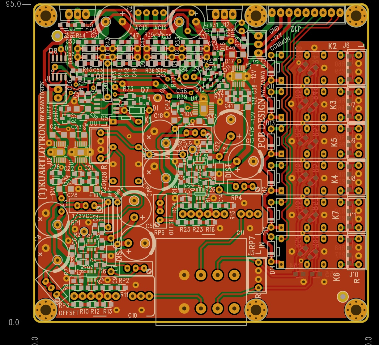

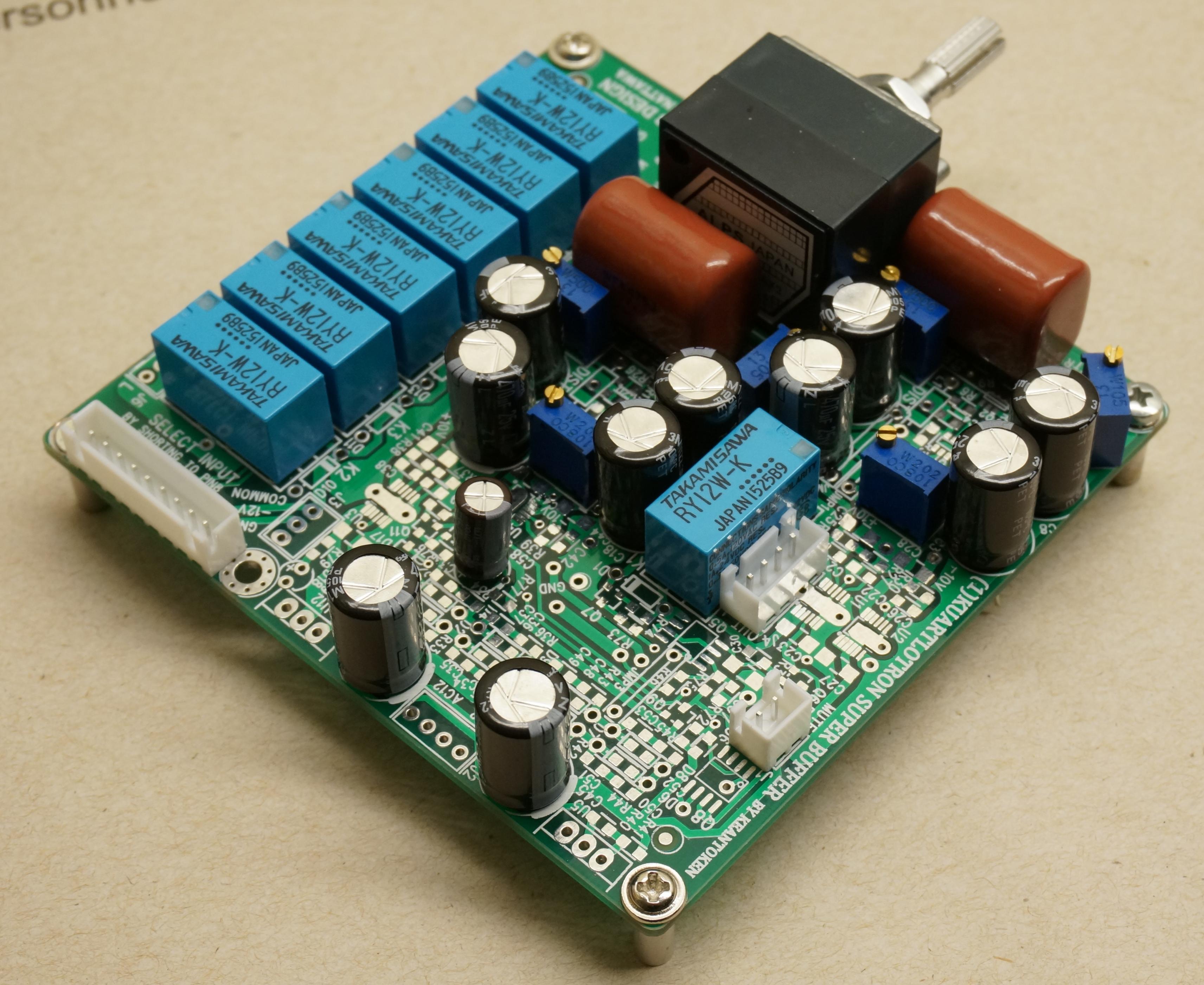

I was hoping to receive the Linear Tech low noise LDO regulator samples by Friday, and have been prepared to start assembling the preamp on the weekend. To my disappointment nothing was in the mail.
These regulators are the finest pin spacing (0.65mm) components in this design, I would definitely solder them first before anything else goes on the board. Can't do anything other than making a mock-up with all the through-hole parts to make sure things work together.

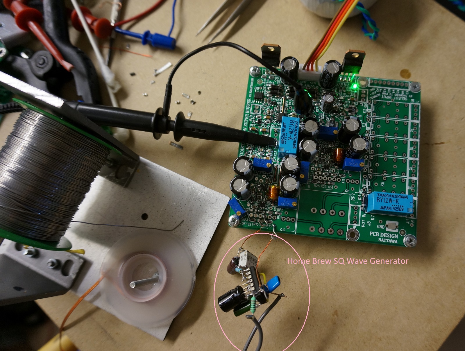

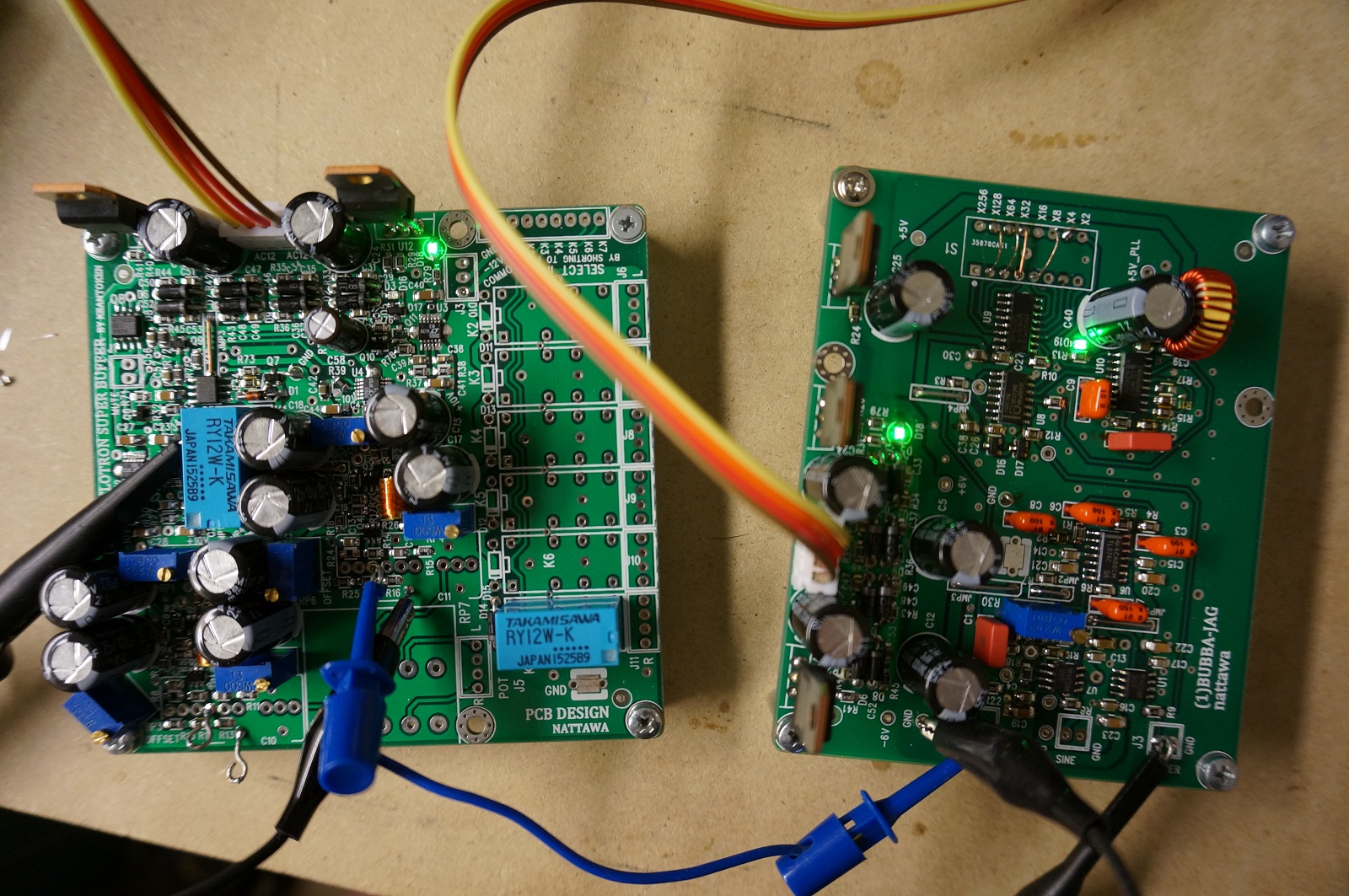

Received the LTC LDO regulator samples and managed some soldering iron time. This is the look of the PCB with all SMDs soldered down, all done manually with a regular soldering station with temperature control.

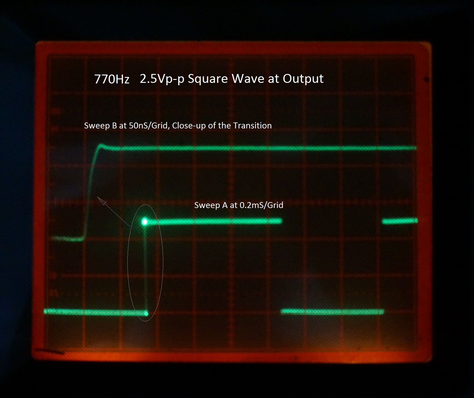

The thing works, flawlessly.
The buffer, the low noise power regulator system, and the muting control all work. There was an error in the negative LDO regulator connection in the schematic but was easily corrected by re-wiring a resistor on the PCB.
The buffer buffers a square wave test signal that has a transition time of about 10 nS beautifully.

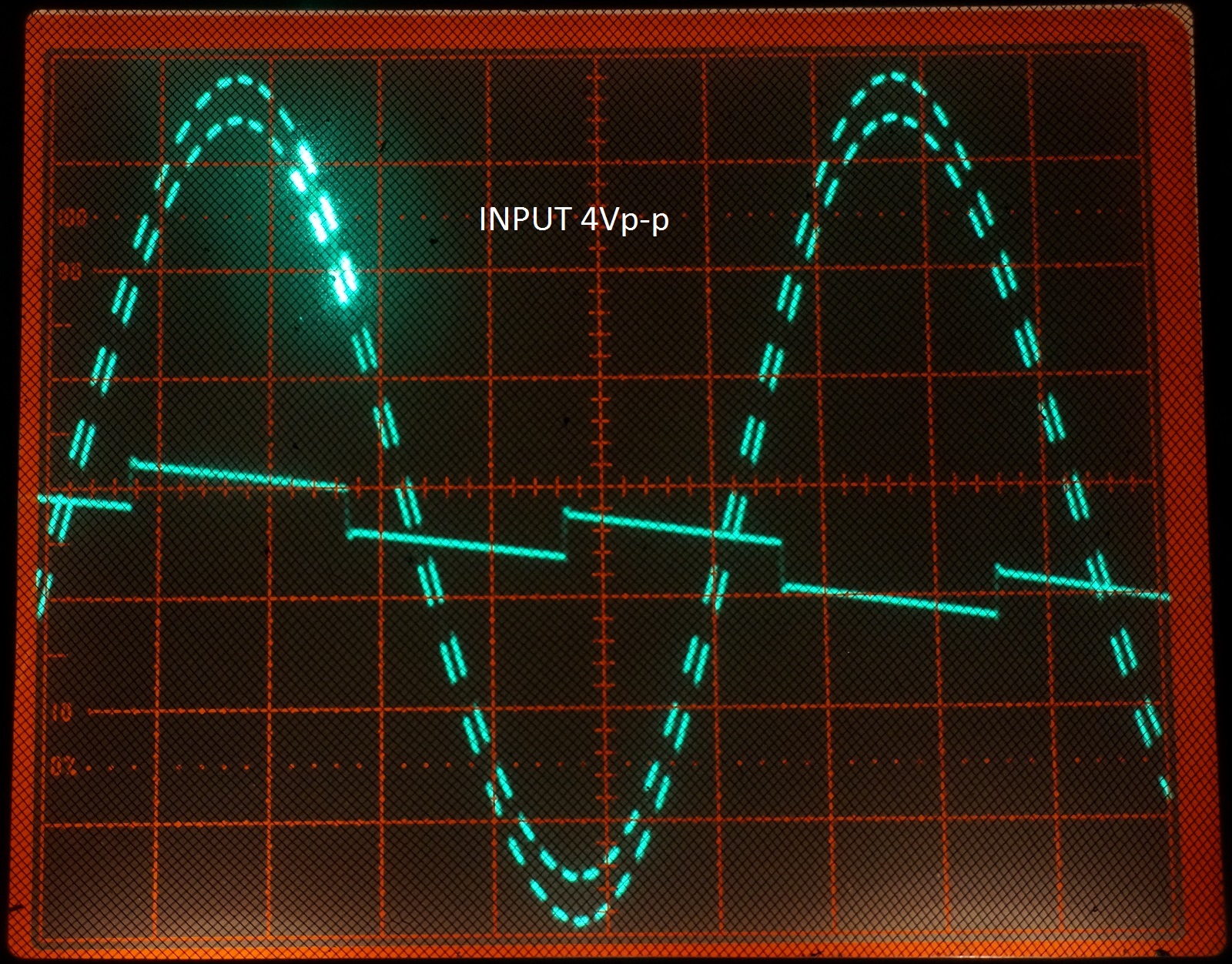

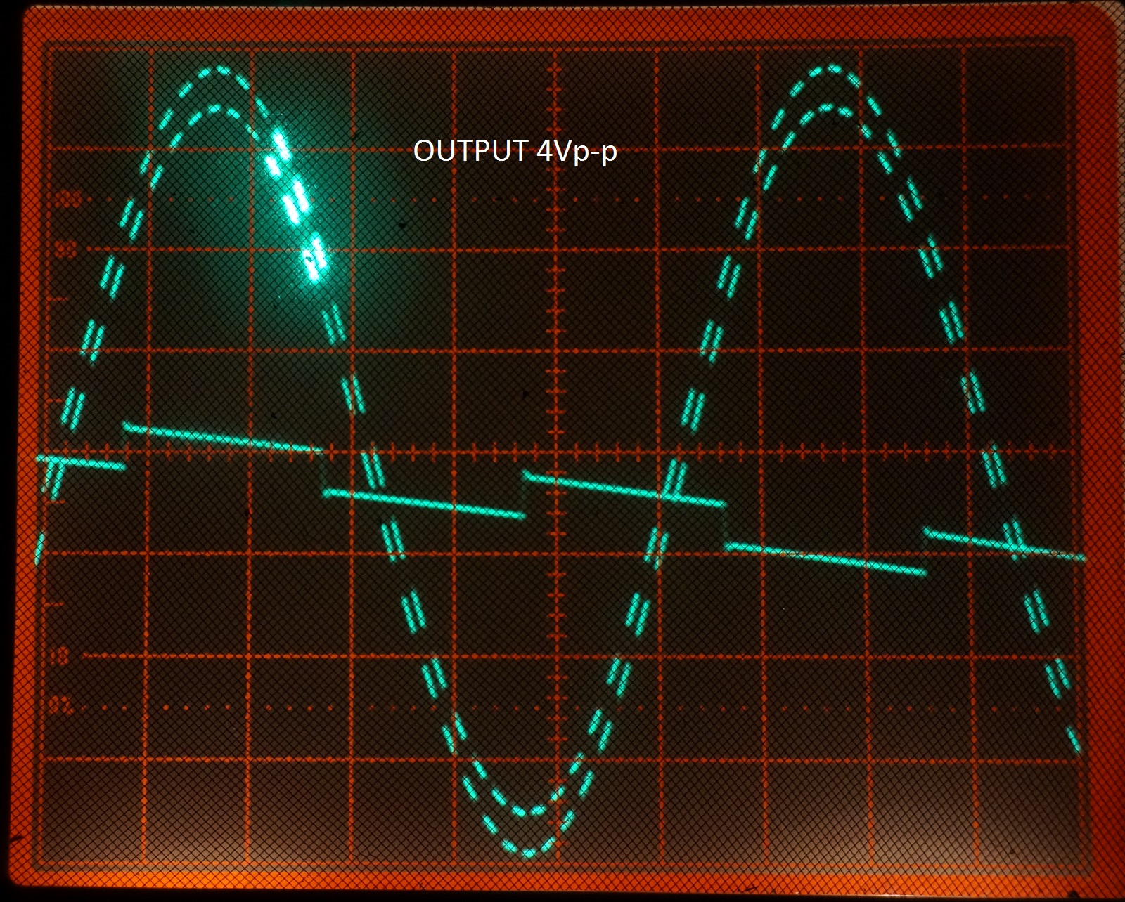

I posted a jagged sine wave test signal generator that I call "Bubba-Jag" on the solid state forum, and our Kuartlotron has become its first customer. The Bubba-Jag
The scope screen shots of the input and output wave form show Kuartlotron's excellent response to the fast transition edges throughout the sine wave cycle. The sine wave is about 1.7KHz in frequency, and the imposed square wave is 32x that at about 54KHz. The B-sweep (close-up of the highlighted part) is at 5uS/Grid.
