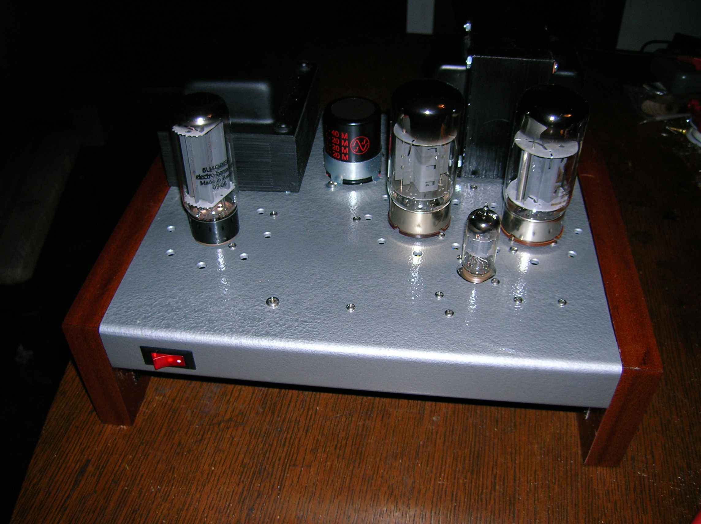

Marantz 8b

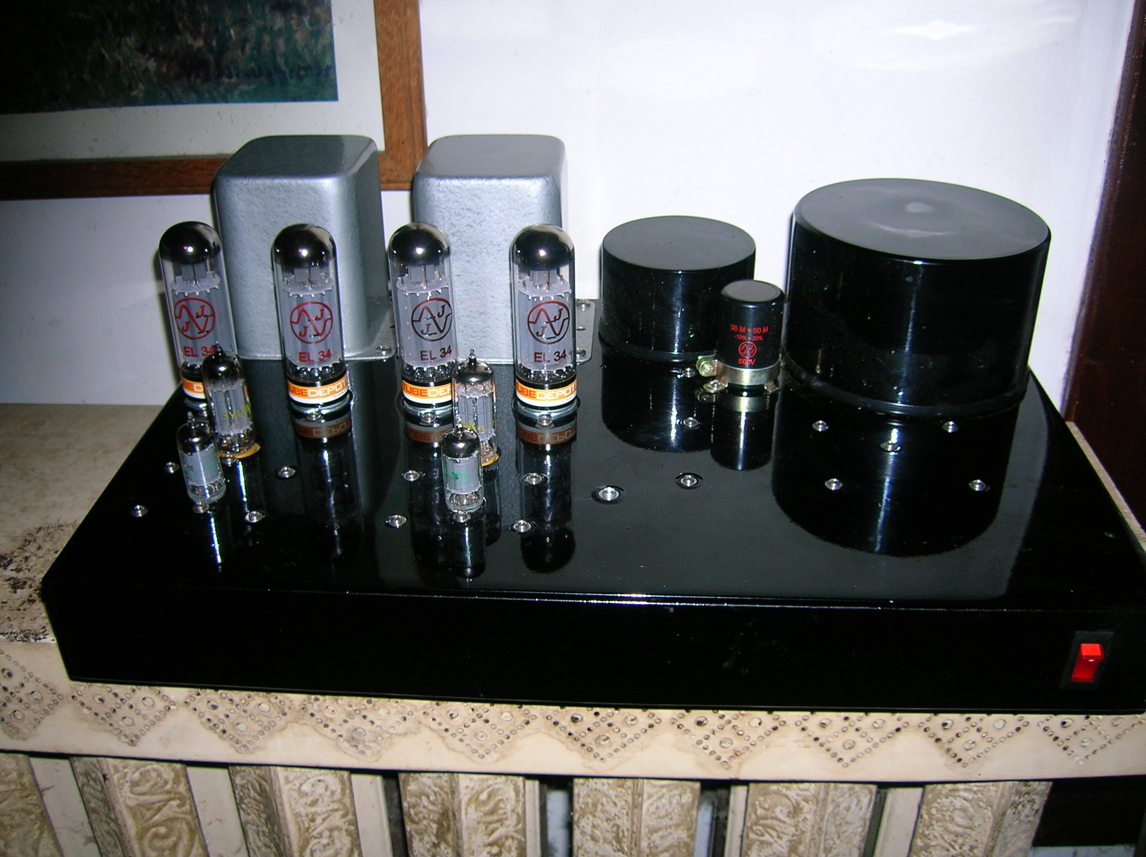

Those Plitron output transformers are EXPENSIVE. About $400 each for the outputs. I was almost finished with my 8b copy when I set it aside. I'm using a pair of Acrosound TO300's. You might find some 8b parts from the reissues built by VAC, Kevin Hayes is a nice guy. But I'm with the others. The St 70 is a much better place to start. The 8b is a really complicated amp.
For yucks I've attached a couple pictures. The black amp is my 95% complete 8b copy. The other is one of a pair of Dynaco Mark II clones I'm working on at the moment. I say make m pretty!
