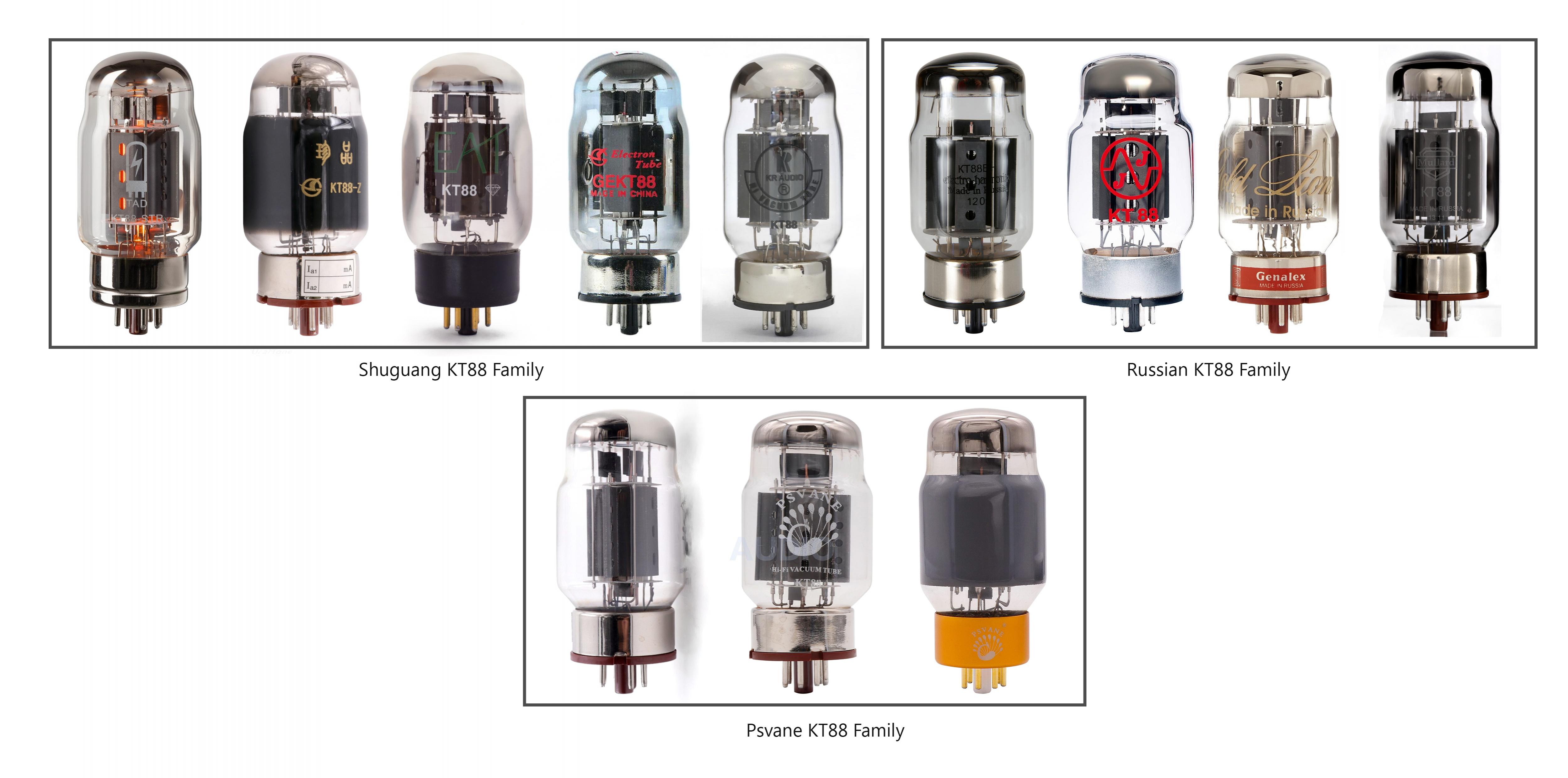

Is KR Audio & EAT rebranded Shuguang?
Looking at several tubes we can see that the socket and glass envelope of the Russian (New Sensor) family is very similar and sometimes identical. Same thing can be said about Shuguang tubes with some variation in the socket, but similar. We can also see that the glass envelope has a slightly different shape with a more rounded top than the Russian tubes. (Note that JJ is not New Sensor tube but has similar glass envelope)
When it comes to Psvane, the glass envelope looks like the Russian.
When it comes to KR Audio, the glass envelope looks like Shuguang.
Are we looking at collaborations ?
