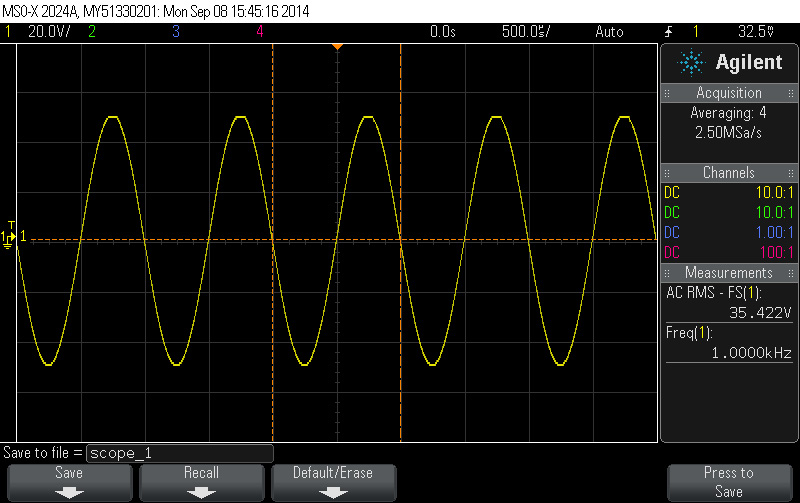

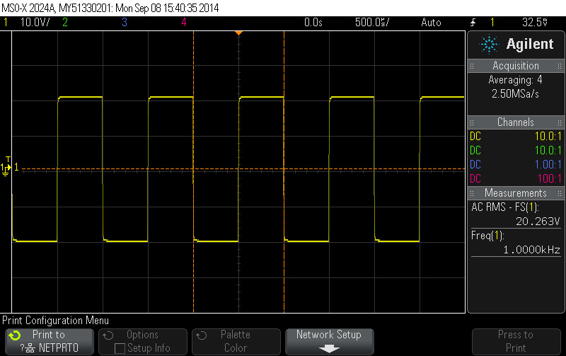

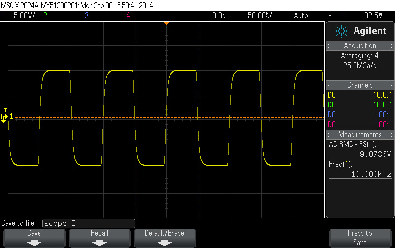

Just a check what type resistors are you using for the o/p tube cathodes ? (I hope wirewounds). I'll tell you why. In my reply way back on page 1, I provided an o/p tranny leakage inductance waveform spike with quite alot of energy in the overshoot; this is inherently always present. What many power amp builders don't realise, is that the energy is also reflected back in the tubes, hence appears at the cathodes as a mirror spike. The transient current spike will over time eventually ruin metal film and other chemical types.
So bear in mind the effect on components of hammering a design with a squarewave test at 10 KHz or around.
