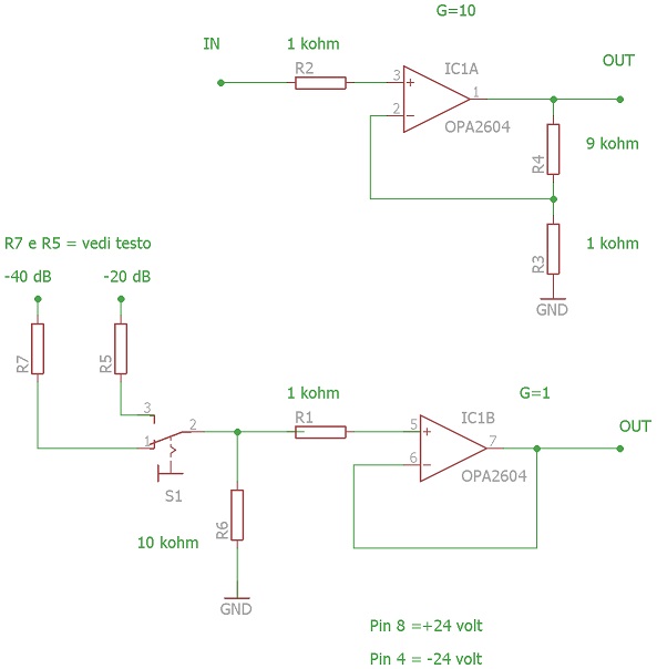

Do you know Visual analyzer?
Scarica programma
It comes from a guy in the University of Roma, the last update is 2014.
It is very complete, need some practice but is very good.
With tone generator and sound card you can have a good test set.
In this way you can check each stage and the performances; the only thing is to use a right signals.
Regardin the output fro sound card you can have a good amplitude to drive the amps.
The problem is the input of a sound car becaues it accept max 2 volts, normally.
In attach you can find a simple circuit where you have the possibility to reduce by 20 dB or 40dB the signal you need to check.
Also, the input impedance of this circuit is high; if you need to check a signal from anode you must put a 10nF in series with the R7 that is 1 Mohm to block the dc voltage.
The input with R5 is 100 kohm and is not enough but you can use this at the output of the amp because with 20dB of attenuation you can see until 20 Veff ( less or more).
In the upper part of the image there is also a simple signl amplifier 10 time, can be helpful.
The supply is +/- 24 vdc, with this voltage is possible to get an output signal around 12 Vrms with a low distortion .
Walter

Yes of course.
Another thing is to check the freq answer
If you have a 192 khz 24 Bit card you can see 96 khz of BW, and it is enough
But another very important test is the THD versus frequency so you can see the shape of THD.
The optimal will be an orizontal line at same level for the sweep from the low freq to the high.; normally in a tube amp the shape is similar to U where at low freq. and High freq, mainly due the O.Transf. , the THD increase.
It is important also to check these performances without feedback first; the BW must be the wider possible, this is a simptom of a good project (O.T. included of course)
Walter

Yes I do have 192khz 24Bit.
