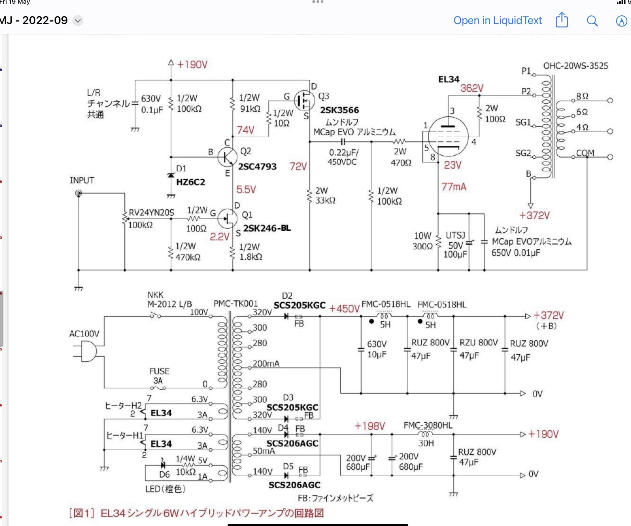

KT150 Single Ended driver consider
Hi Folks, can anyone tell me attached circuit where the front end and driver stage SK3566 able to drive KT150, certainly I will modify t to fixed bias as - 48v.
