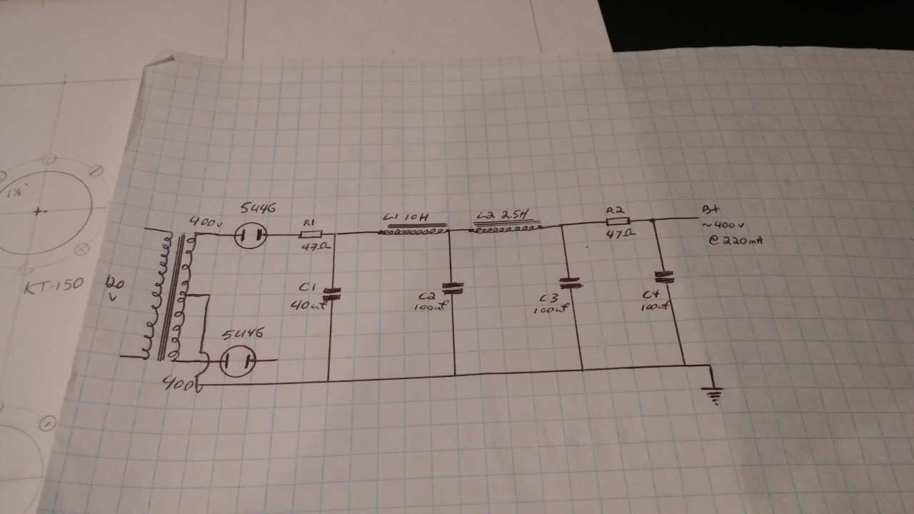

How's this for a valve PS?
..Assuming the second half of the rectifier is connected properly.. whoops.

If you have not done so already download PSUD and simulate your power supply.
PSUD2
I would recommend changing the load resistor to the appropriate current value and also playing with a stepped load to see how your supply reacts to a change in load.
And then read a lot about what others have done with PSUD. There is much to learn and it is a very valuable tool.
ray
By the way don't forget to include a bleeder resistor that can cope with over your expected 500 volts or so. If necessary, use low voltage rated resistors in series.
Once you start testing, try getting a sense of how long the bleeder resistor takes to get the voltage stored in the caps down to zero.
ray

How might I lower the impedance of the PS section while still achieving minimal voltage ripple?
If you install another larger inductor to replace the second one you may not need the 2 dropping resistors. Although I am not sure what the B+ will be. You need to plug that into the psud. The first inductor needs to be more capable since it will be subject to full unfiltered voltage. If you need more voltage you can adjust the final B+ upwards by placing a small value cap in the first position making it cLCLC.
If your 10v filament transformer is center tapped you can use half of the windings for 5 volts.
cheers.
It is going to be a mellow sounding amp with all the resistances in series...
I read that Class A like a low impedance power supply.
This is a highly contentious discussion. Low impedance in single ended power supplies means small capacitors (about 40uf max) for filtering and low DCR chokes . this will lead to more residual hum in B+ which will be more or less audible depending on the sensitivity of your speakers. I guess it is something you need to try and see if it is acceptable to you. cheers
When I'm playing in PSUD2, it depends on where the B+ is going.
If transformer coupled output, your B+ flows through the output transformer. Any ripple there is going to be stepped down at the secondary. Say you have a 5k:8 transformer. The voltage ratio is 25:1, so even a few mV of ripple on the B+ becomes pretty tiny reflected on the secondary. You also have the AC impedance of the OPT primary in your favor.
If the B+ is going to an input stage (assuming single ended), you want to be a little more careful because ripple is magnified by the amplification of the stage. Again it is going to be somewhat mitigated, depending on your topology, but I try to minimize it as much as possible in the modeling. Real world performance is probably going to be worse. Luckily, input stages usually run at much lower current, so you can afford brute force filtering.
Consider some secondary filtering for your input stages. Something along the lines of CLC(output B+)RC(input B+) can work out well, space permitting.
There is a way of calculating the ripple in db, the noise floor and the ratio to output.... all this is garbage, for real there is way much more going on in the amplifier.
When you do your power supply design properly with reasonable voltage drop 5 to 10 mA is not a concern, in a tube amp there is greater contributors to the ripple: Heaters, Induction of the wires, Radio pick up.
Feedback will get rid of the most annoying 60hz and 120hz artifact picked up along the amplifying circuit.
Nice post Sodacose, the output transformer is a huge divider of B+ ripple.

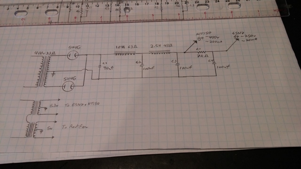

Suggestion for Canadatubedude: instead of resistors in serie to lower the B+ to desired levels, find a transformer which has a lower VA. If you need to lower the voltage place high quality resistors to the ground, serie resistance is a nice thing in a phono stage with 1 mA , with a KT150 tube you are killing the sound because the transformer will never be able to supply the current demands through the resistance, consider 50 Ohm as the higher value for a choke resistance, and get a nice huge cap
Update
Wow thanks, those two posts are very informative. So <1mV ripple isn't really necessary, at least for the output stage. I'll take another stab at the PS design and go for less resistance.
I've already purchased the PT (Hammond 378CX) so I'm stuck with it.
Here's a rough circuit I've drawn out. I haven't included values, I'm hoping you people can help me out with this.
