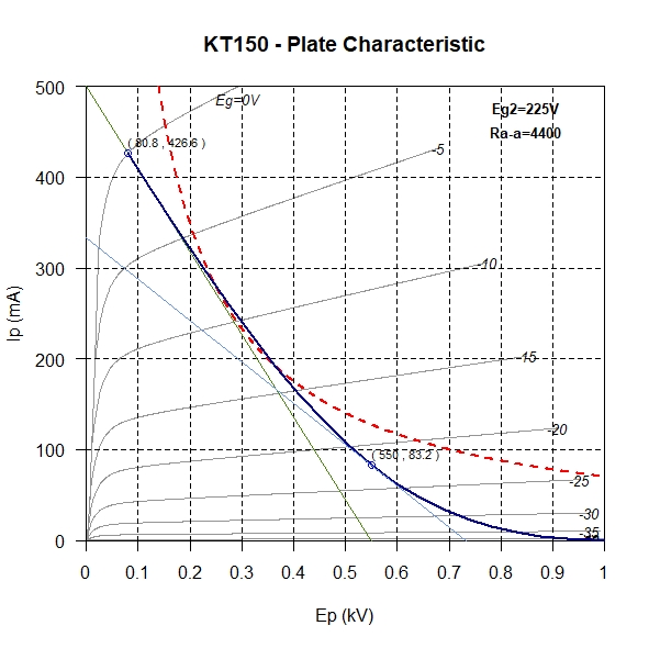

I worked up a loadline for this type. Looks like it can do 75W easy, and without going too far into Class AB. The primary load looks like 8K8 will be good, and that's probably a stock value. Not enough detail to extrapolate a likely h3 estimate, but this is a simplistic estimate anyway that depends on a lot of assumptions. Says nothing as to how the circuit actually sounds, and that's a matter of listen and learn, seeing that it depends heavily on the actual harmonic profile of the harmonic distortion. H3 isn't so bad (mostly an edgy, overly aggressive sound); it's the higher order harmonics that sound really bad. In any case, you'll be needing some NFB to clean up whatever harmonic messes open loop operation produces.

You are welcome, it would be interesting to find out how the actual tubes bias up, because Tung-Sol's datasheets for the KT120 and KT150 are kinda sketchy.

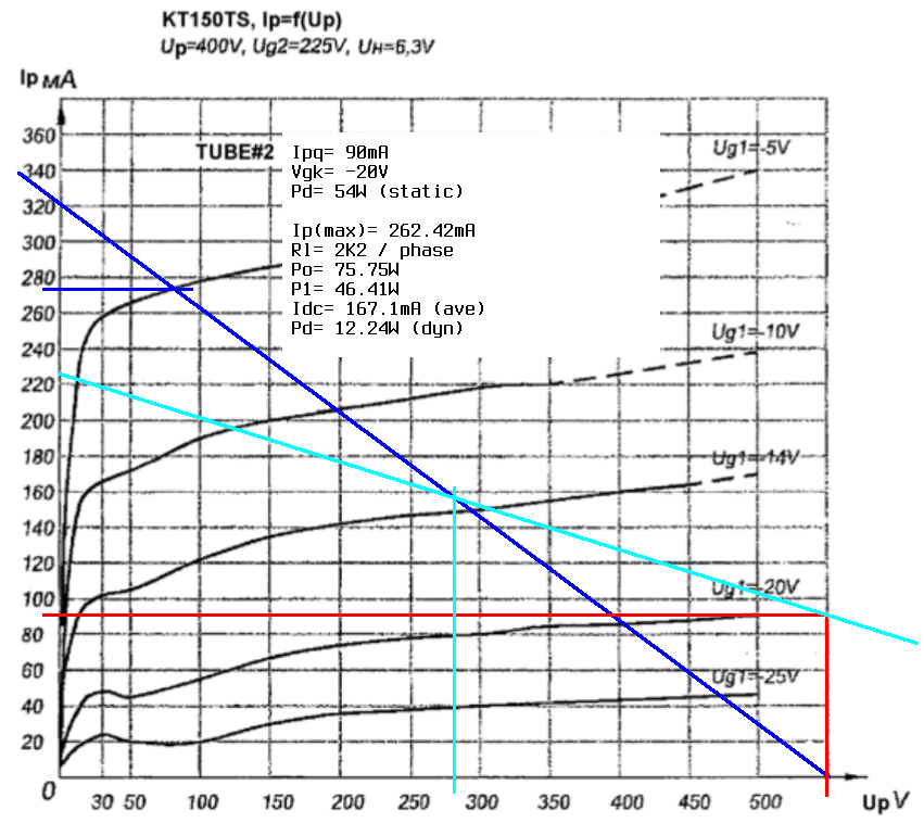

On the lasts diagram I can't understand why we have to set the bias point so the 150 will dissipate almost the 85% of the Pa to reach in a good power in AB?

Also -22 v of bias it is a problem for driver because you will go into A2 easily and there is no reason to do this in AB

80% of plate dissipation is considered not too hot for a class ab amp..
so for a 60 watt plate, 48 watts at idle is not so bad...
now that is 96 watts at idle so that the class A window is indeed significant...
in many cases, you need not go out of classA to transition to class AB, maybe power is enough...
and this is what i am counting on doing the kt150...

look at bias point
are 54 watt as miles said and more looking at your diagram

Hmm, 550 x 0.0832 = 46, 46/70 = 0.65. Not 0.85. 😉
Ok, my error on typing but the concept is the same
No reason to have this dissipation in AB configuration.
This is the wrong way, in my opinion, to reach a fine class AB amp.
The bias point a -22 v, as said before, is not good.

As you imaging if you connect the g2 by 1K resistor to Vdc the bias point goes around -40 vdc ( I have to check better on my other amp with same conf) In this way you can set the Ibias at, p.e., 40 mA so you can run in full class A until 4-5 watt, the previous stage is not a risk of to drive in A2 the 150 grid, you haven't to use maybe an additional gain stage to drive properly the CF and the life on power tube will be longer.

The resistor grid I use for each 150 in fixed bias is 180K-270 K without any type of problems..
After that you must use a good OT otherwise all consideration are not logic.
