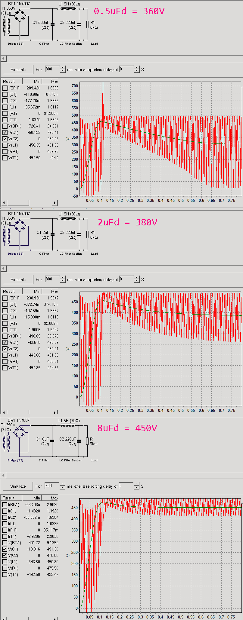

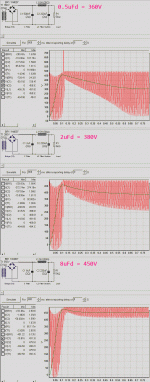

Thanks for the link Jazbo8. I had a read through. Thanks PRR for your analysis as well. I have gone through the transformers I have on PSUD2 and found, as you did, that there was no real ideal match. However, using PSUD2 I tried something that I have seen before in older equipment and schematics that I don't fully understand. That is the use of a smaller than normal capacitor and then a choke after the rectifier. This can then be followed by whatever combination of resistors and capacitors that are required to achieve the ripple reduction desired. Varying the capacitor between 2 to 6 uF varies the voltage to any level that you want. This works on PSUD2, but I have been unable to find much on using this method to adjust B+ with respect to there being any benefits or down sides. Any info that you might have on this method would be appreciated. I prefer not to use a tube rectifier because of space constraints on the chassis I have available.

About the small c1, i noticed that under 1uf the voltage is affected minimally and starts to change rapidly after that. So, by the time you reach 3uf the voltage is close to max. I recall that a value of less than 1uf for c1 helps to lower the impedance of the PS. If you can build your PS with all film caps is also an excellent procedure for a SE amp.

I usually use only film caps in my builds, except for cathode capacitors, which I normally bypass with film caps. I have built the RH84 and listen to one daily, and like it. I'll have another look at the RH Universal, but I'm likely to build my KT120 amp with triode and ultralinear connections, as my OPTs provide for both. A switch to add pentode mode with Schade style feedback might be workable too. Other than lowering impedance of the stage, are there any other impacts that you know of that result from the use of a small input capacitor?
Yes, and PSUD will show you why it works. The voltage at the first, small, cap has HUGE ripple. Say the peak hits 500V and the dip hits 300V. Now L-C filter that, the "average" is about 400V (+/- depending on exponentials, rectifier pulse-width, and choke DCR loss). With ample L and C on the end your DC may be as smooth as you wish.
The "problem" is that the first cap value is more critical. Usually the first cap "can" be -50%/+100% tolerance, and older electrolytics were certainly this sloppy, and worse as they age. (Paradoxically an e-cap's effective value can drop or *rise* toward the end of life.) Hammond did it with film caps, which can be made much better than +/-20% and don't change for many decades. But that much film cap is historically expensive. But fashionable, so maybe it is a way to go.
A hasty sim suggests the sensitivity to 1st-cap value is not large. This may be your path.
