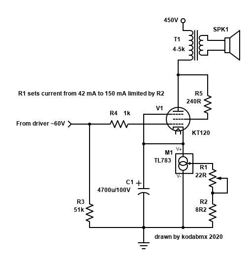

I am searching for output stage voltages and operating points. Specifically the KT120 SE UL and triode mode.
5K output, 400v plate to cathode, 40v bias, 100-130mA current?
Would a 300 ohm cathode resistor work? seen up to 500 ohm cathode resistors.
probably use a 400-0-400 power transformer.
or should i lower the current a bit?

It can be run at 100ma - 400volts plate but you need to make sure its still 400 volts at that current for class A also remember its a higher heater current than the KT88 , this seems to be a big issue elsewhere .

With 100 mA and 400 volt the point is fine and you get more power .
For triode mode the 5K can be little bit higher , the Rp is lower than 800 ohm so 3,5k can be good.

Why not ditch the cathode resistor and use a TL783 as a current sink? Then you can have Dial-a-volt™ and run the tubes at whatever current level you like with the turn of a pot 🙂
