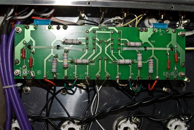

Well, if you are certain there are no problems with the relay - it can be a bit difficult to verify for sure. You may want to check again that there is no short between pins 3-4 when counting from the back of the amp. Better bleed off the B+ before doing this, as it will usually keep close to 200V for days.
You should check the bias since the bottom is already off. The cathode resistor is probably 5 ohm if there is a 10 ohm on both sides of the PCB. Measure the value to be sure. Adjust the corresponding bias pot to get a voltage across the cathode resistors corresponding to a current of 50-65mA.
SveinB
