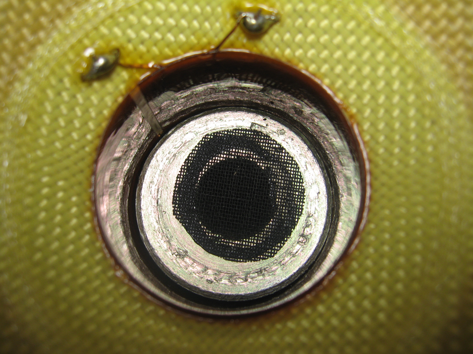

Thanks everyone for the answers. The amp is ok (tested with other loudspeakers). So the best way is to buy new drivers. That allows me to 'destroy' the old ones. Can you please help me? How should I center the magnets? How should I check if that is magnets that fix the cone?
Just buy new ones and install. Then don't drop or bump them. Magnets on these things are huge. The frame of the speaker usually bends from a mechanical shock such as a drop or bump. You can try bending it straight, but I find replacing is best on these units. They are available, but expensive.
well if the drivers are "frozen" (the cones won't move) removing the center dust caps to visually confirm that the magnets have shifted would be step one.
Here is the photo with the dust cap removed. The magnet have shifted. What would be my next step? Thanks!well if the drivers are "frozen" (the cones won't move) removing the center dust caps to visually confirm that the magnets have shifted would be step one.
PS. I haven't removed the dust cap from the second loudspeaker yet, but the problem seems the same.
without the the right tooling it's nearly impossible to remove and re-center the magnet without damaging the voice coil. re-centering a magnet is generally done along with a full recone as the magnetic gap would be filled by a spacer to maintain the proper distance and allow the new epoxy/glue to cure.
if the center hole(under the screening) is threaded you might be able to remove the magnet and with luck and the appropriate thickness paper spacer against the inner of the voicecoil former possibly manage to re-glue the magnets.
i've only succeeded in this sort of thing a very few times myself most often my efforts turn into a damaged coil which necessitates sending them out for recone/recentering.
on one attempt i succesfully re-glued the magnet but also glued the voicecoil (the guys at the reconing shop had fun with that one)
