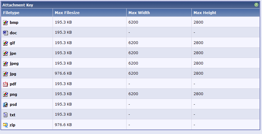

It's fine to email me. I just looked at the file size limit for the forum, and it's 976k for zip files. I would think that a schematic would be smaller than this, but if you have a problem posting it, don't hesitate to email.

I guess I haven't tried to post a large file since the upgrade. Wasn't the old limit 100k? I will make a PDF and post it.

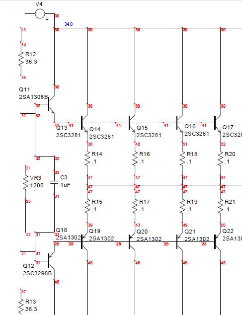

I think "working on" is the key here. I changed a few values as I worked on the design. I now feel it is finished. Attached is a Zip file with the schematic in PDF. The node numbers didn't print for some reason. They do show in the print preview. I am also including a screen shot of the schematic which does show the node numbers. I have also included the net list of the complete amp. It will very interesting to see how the results differ between sim packages.

I just tried to attach the Zip file and was told it exceeds the limit. I will try breaking into 3 files.
Ignore the 3 blank pages in the screen shot. I don't know why they are there. I am still having trouble with the third file. I will try again.

The PDF you posted, "50W DIY Amp Scxreen Shot .pdf" is missing a bunch of the circuitry, making it impossible to associate all the node numbers on the schematic with those of the netlist. See the capture below. The front end came out fine, but the front end is not really part of the discussion about data correlation at this point. The circuitry in between the front end and the output stage - shown on the left side of the diagram below - is missing.

I think it's preferable not to look at the complete amp for the purpose of correlating simulation results. Since the discussion thus far has centered on the behavior of the output stage anyway, adding the input stage doesn't really clarify anything. It just muddies the waters further, making it more difficult to construct a working simulation file from the netlist. For example, suppose you aren't able to post a legible schematic containing node numbers corresponding to the netlist. From the one you posted above, it looks like there's some technical difficulties in the capture that are causing garbled schematics. If these difficulties can't be overcome, I could generate the simulation from a netlist of just the output stage - without the schematic. If you still have the full simulation files corresponding to the original netlist you posted in post #39, that may be the simplest way around all this. Do you still have them? It shouldn't matter that the netlist isn't for the final design. In fact, the discussion on output stage behavior was about your already existing design anyway, not some as yet undetermined future design.
Andy,
I am attaching the screen shot with node numbers again. This time it looks to be complete. I posted the complete amp because that is what I thought most here (as DIYers) would want to see. This is not some some "as yet undetermined future design". This is still the same basic amp, both VGS and OPS, that I presented originally. It has been changed slightly for improved low impedance performance and drive so it can be used in a bridged design for 200W output at 8 ohms. That is the reason it is an inverting amp. This has been built by me in the past, and is a working product. I have taken advantage of the sim program I have now, but not then, to adjust some component values. I do still have the files from post 39. What exactly would you like me to do with them? 😱 Lets keep it clean here!
