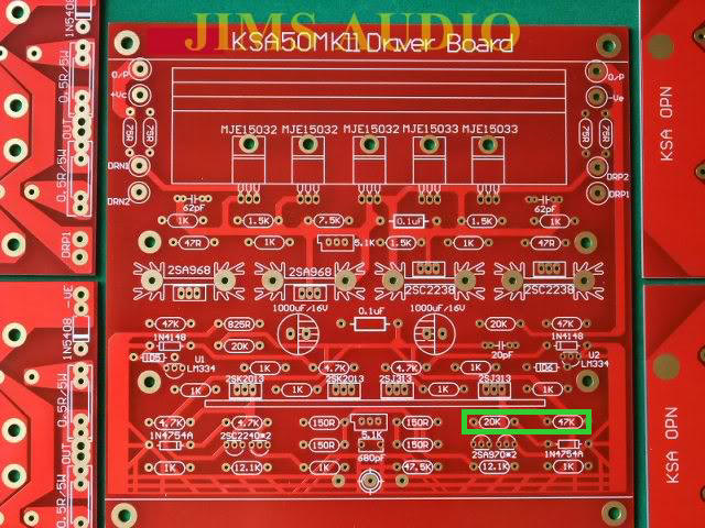

What are the misprints on the Board?

Jeezus, Young Man! Don't keep us in suspense young man! What is the misprint. Do be aware that if you just go ksa50 and not ksa100, there are directions at the bottom of the parts list to omit or add certain components. Or if you perfer one type of component you have follow instructions.They are exact copy of original KSA50/100mk2 and they work fine. wcleungoo has the same boards http://www.diyaudio.com/forums/solid-state/62168-my-completed-krell-ksa-50-clone-pics-2.html and I have them too (red like yours). Just be careful. They have misprint on the component side. Take a look at schematic!

20k and 47k resistors above 2sa970 transistors and zener diode, should be 4k7.

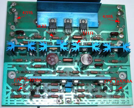

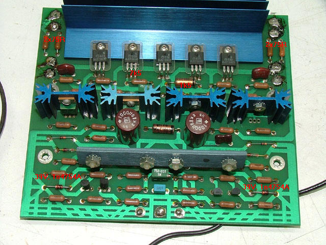

Just another thing. There were some differences between KSA50mk2 and KSA100mk2 in component values.
Take a look at the pictures. First picture is KSA50mk2.
Also, KSA50mk2 had 0R5 emitter resistors for output transistors, KSA100mk2 had 1R.
But, you can leave as it is with component values from jim's audio list.
