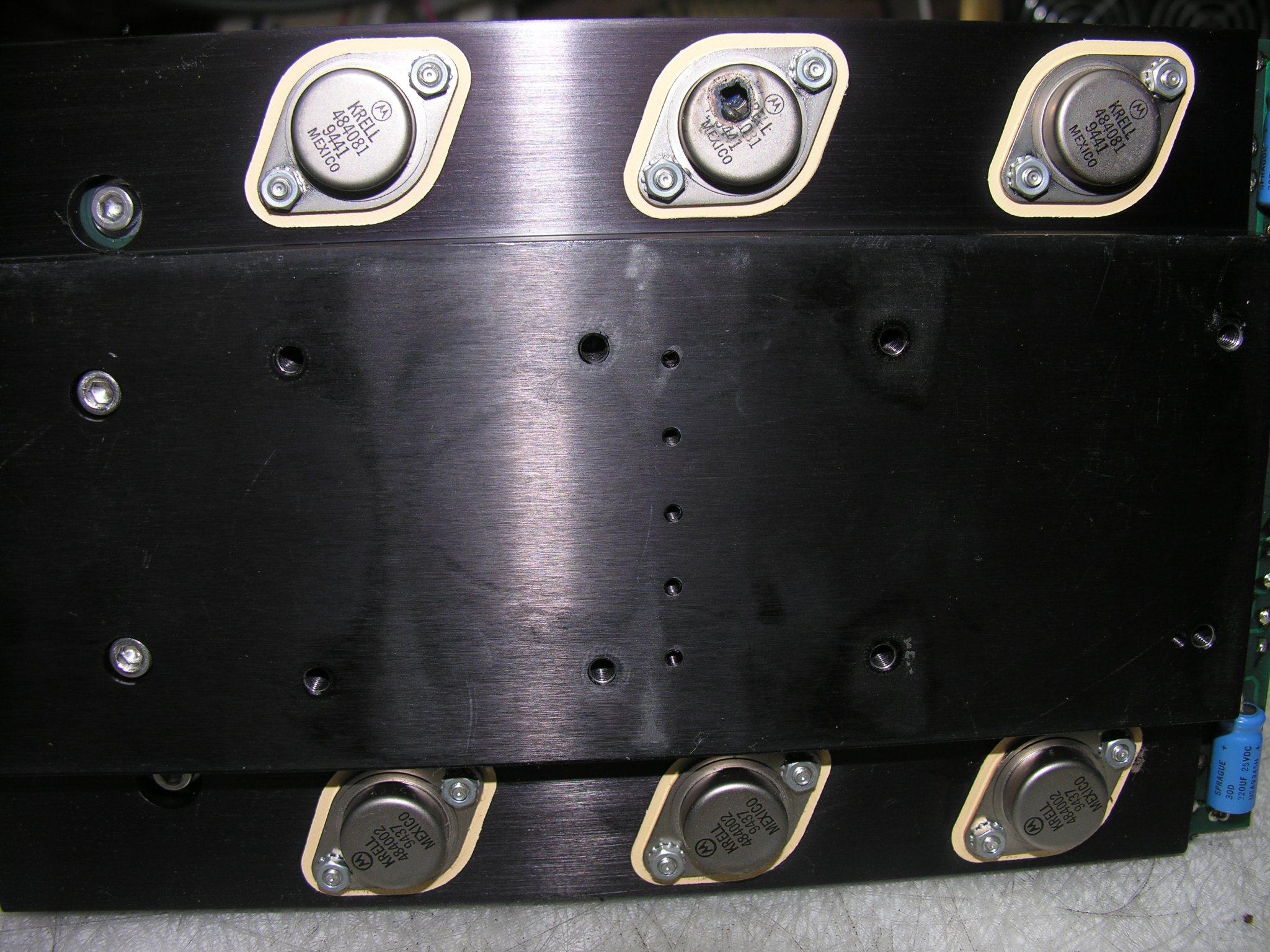

Krell KSA50S
Anyone got a schem for this critter - the one on my bench "has issues". Also need generic numbers for the house numbered output devices (484081 and 484002)
cheers

Many information in this thread
https://www.diyaudio.com/community/threads/help-repair-krell-ksa-50s.180314/
I know a few people in France who have worked with this amp.
It suffers from several design flaws and tends to set itself on fire very often upon startup.
In addition the S has a particular bias circuit, but otherwise the rest of the diagram is almost identical to the mk2.
For the finals, you should go for MJ 150XX or 2119X.
Personally, I don't touch these things unless I have a fire extinguisher handy, lack of protection, no soft start, DC coupled, gas plant.
You should find help here but think twice before investing money in this if you don't know exactly what you are doing, it could be very expensive and potentially catastrophic.
Good luck
