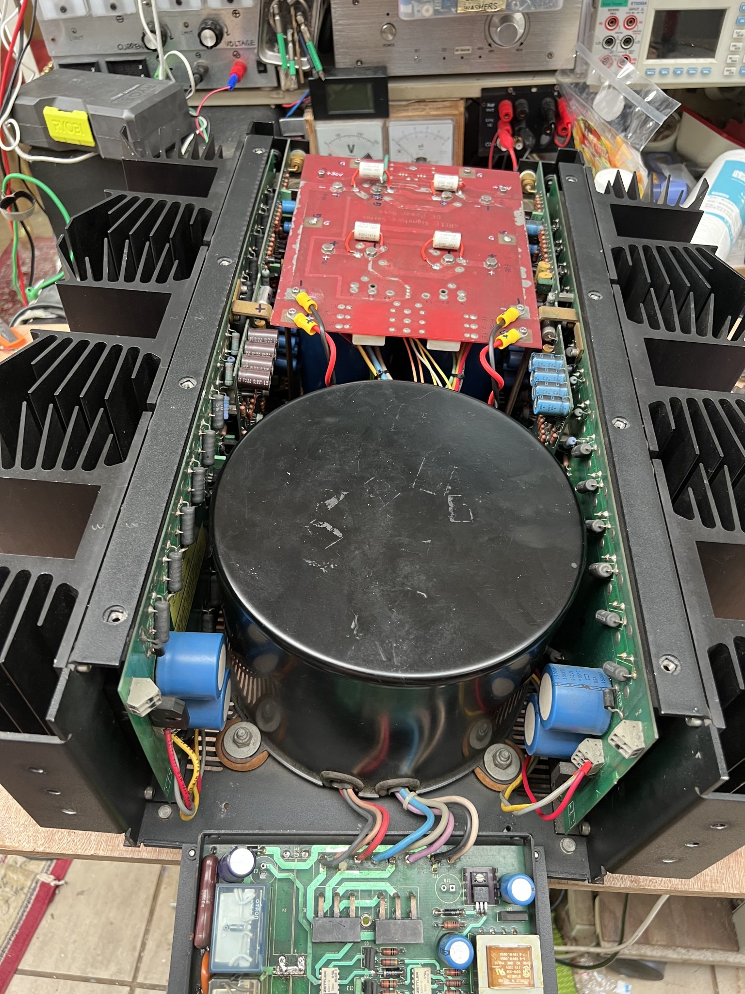

Tested ok. Problem fixed. What a challenging experience. Took me several days before I nailed the problem. I called this episode as “hunting for gremlins”. Haha. Overall very satisfying. So I thought I should share this as this amp is a collectible item and there are many of these amps still in operations.

I have....... more than once. As soon as the PCB turns into a carbon/coal-like substance, it starts conducting. I have actually seenThroughout my more than 50years of amplifier building and repair I have never encountered such a failed mechanism.
circuits, where the PCB-material has been constantlly glowing red before the fuse finally gave up.
Nice, thorough repair. Well done. Congratulation with the result. A fully working Krell is one of the good things in life 👍 🙂
I've seen similar faults on some Arcam equipment. The failure mechanism on those was that the capacitors leaked electrolyte onto the multi-layer PCB, which then over time caused corrosion. This corrosion on multi-layer boards can cause internal leakage which then starts to get warm due to the resistance. With heat the board starts to become conductive which can then also affect the traces. Once they short, they can catch fire in spectacular fashion.I wired a jumper to bypass this defective PCB trace. Re-solder the capacitors. The short has been located and isolated.
Subsequent test of the repaired channel after reassembly showed that the problem is fixed.
Would like to hear if anyone else has encountered such an incident.

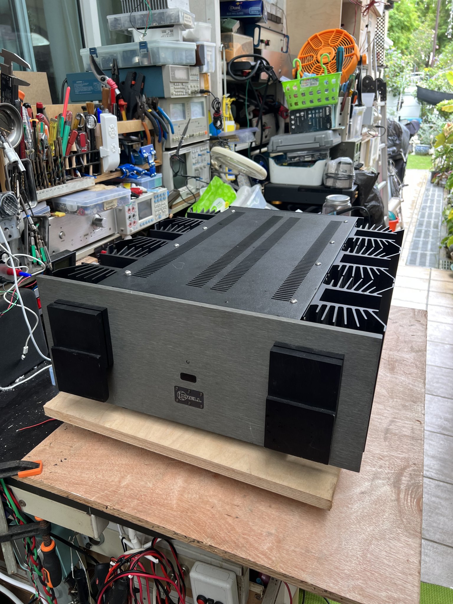

The Malaysian friend of your friend in doesn’t happen to have the first name Najib? 🤣Received a Krell KSA 250 for repair from Kuala Lumpur Malaysia. The owner is a friend of my friend in Singapore. The owner couldn’t find anyone to repair his amp.
One day he turned on the amp, the relays clicked and then he saw spark coming from the left channel and then relay clicked off. Subsequently couldn’t be turned on again.
It was a September 1991 date of manufacture so it’s 32 years old. View attachment 1206260
