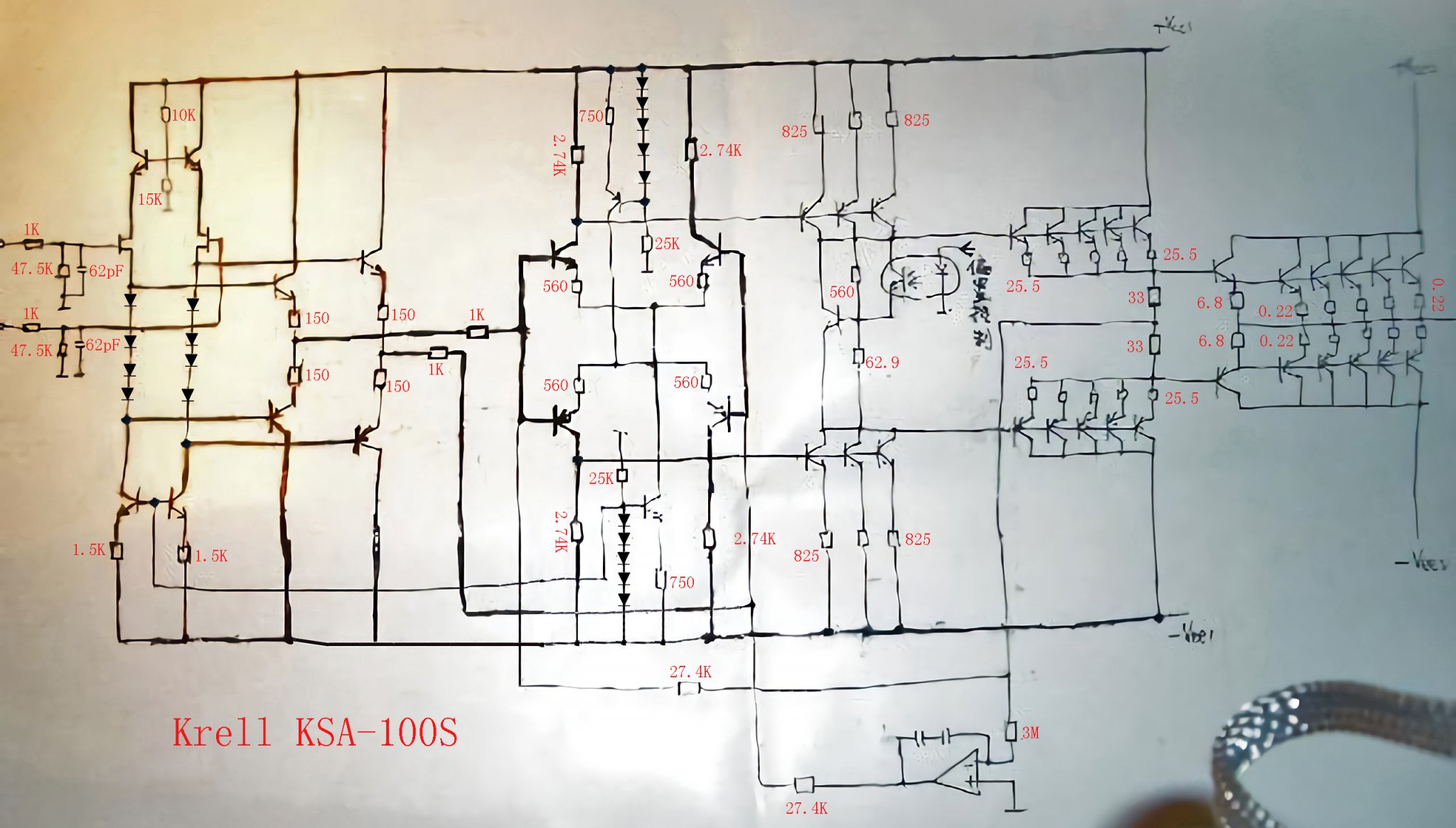

Krell KSA-50S schematics
The amp works perfectly, but occasionally the left channel does not turn on and I read that both the relay and the electrolytic of the soft-start circuit are prone to fail.
Being an amplifier of almost 25 years, I think that in addition to repairing the soft-start board could change all the electrolytics and probably other components that do not look good.
But despite having searched a lot, I have been unable to find the schemes.
If someone has them, can give a clue as to where to find them, or can share any experience on this particular model, I would be very grateful.
Thanks,
Rod
Krell KSA 100S

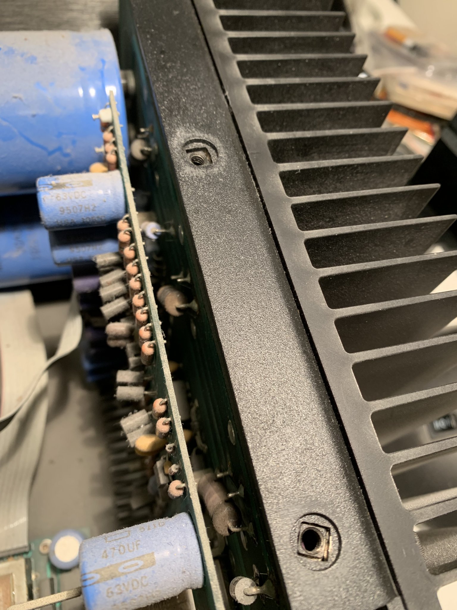

Picking up this thread. I'm also looking for a KSA-50S schematic. Does anyone have one they could share?

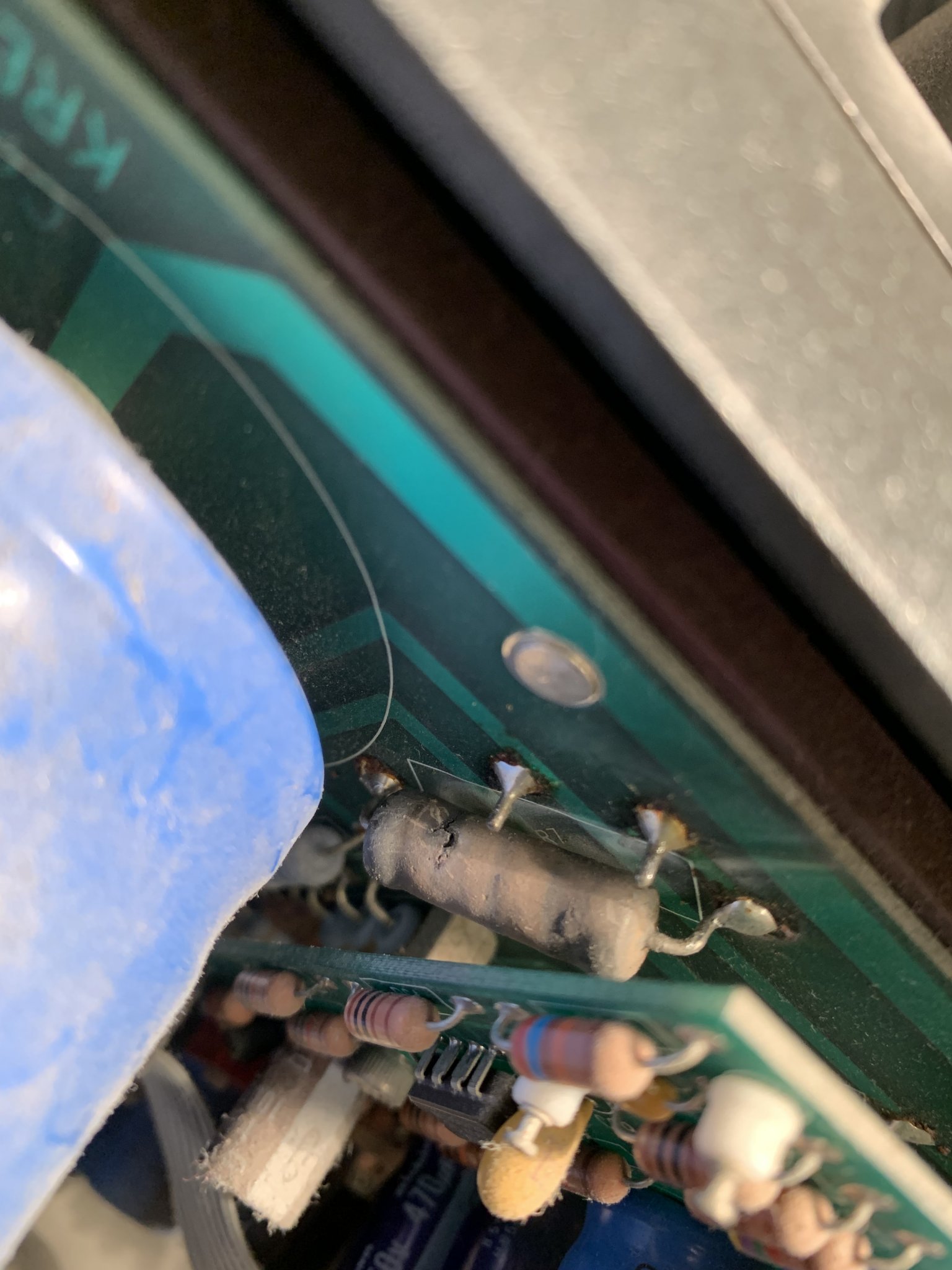

I'm helping a friend deal with their recently-deceased amp; it powers up for a second and then shuts down. A quick check of what I could get to without major dismantling shows that 2 of the 3 output emitter resistors visible at the top of the left channel board are open circuit and burned. The companion TO-3 transistors appear to have shorted, which explains the resistor failure. I suspect there will be a similar problem with the other half of the circuit, but I won't know until I get it apart and can access the bottom of the board.
Before I take the surgery any further it would be great to have a schematic as a guide.
Thanks,
Peter
