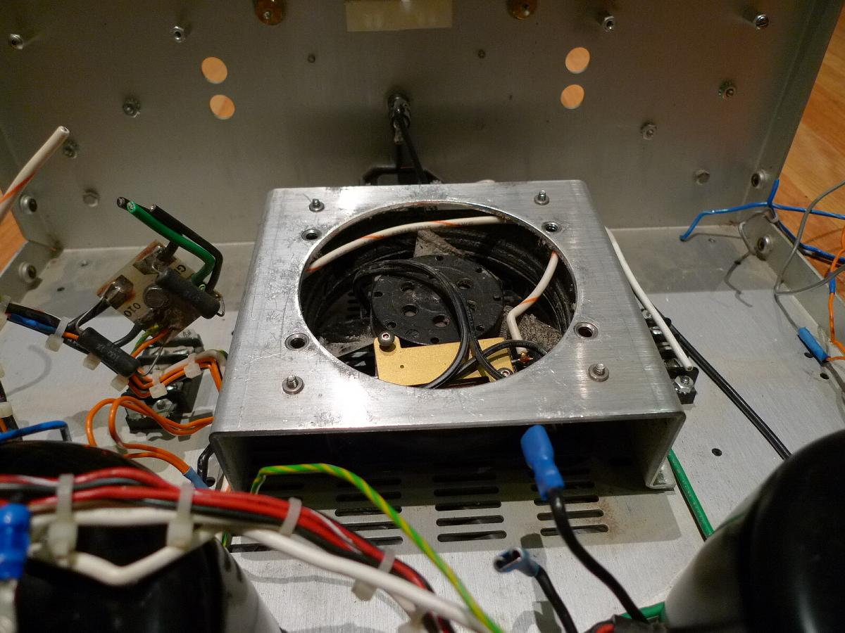

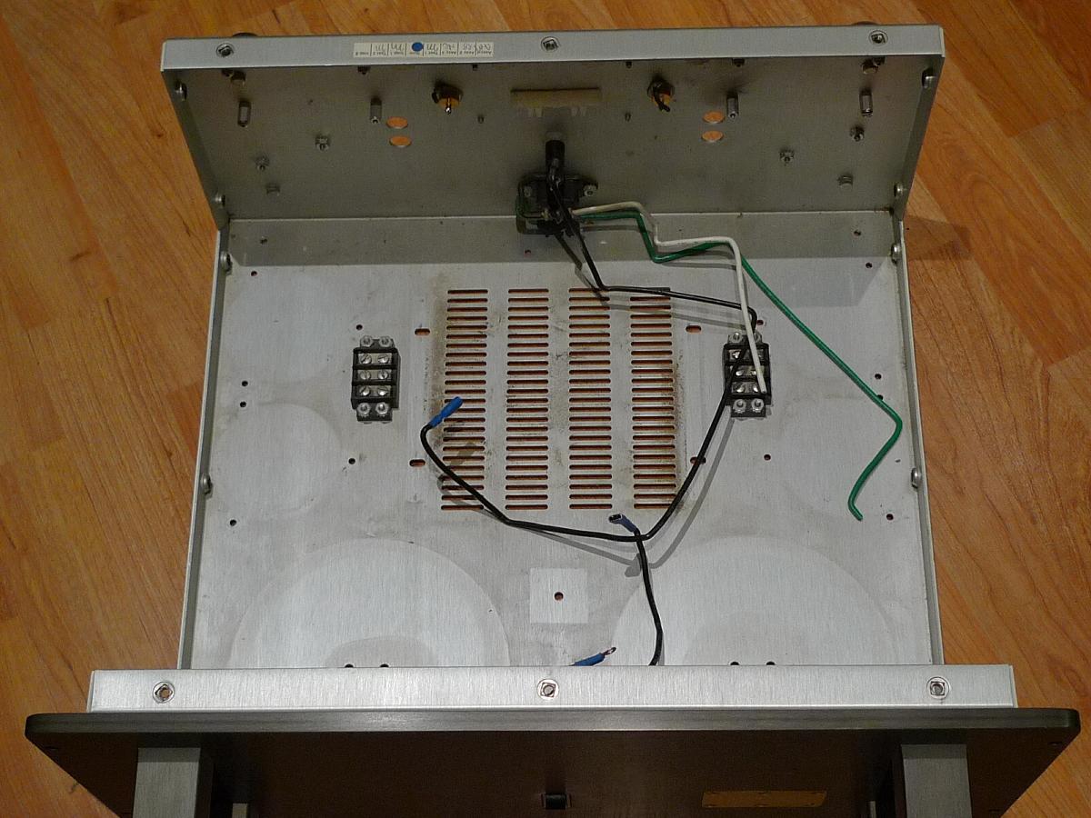

Hi Doc, thanks for the photos, very useful.
Can you read the values of the two resistors in your first photo ? The ones between the two trafos? I believe they're the ground connection to the chassis and safety earth.
I've just checked the remnants of the wiring loom, that is the earthing point and the resistors are still there, 100R, 5W. This is what mine looks like.
