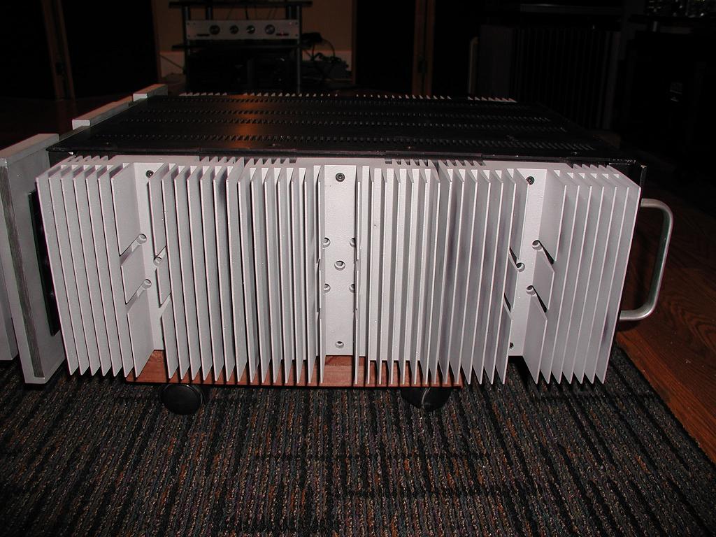

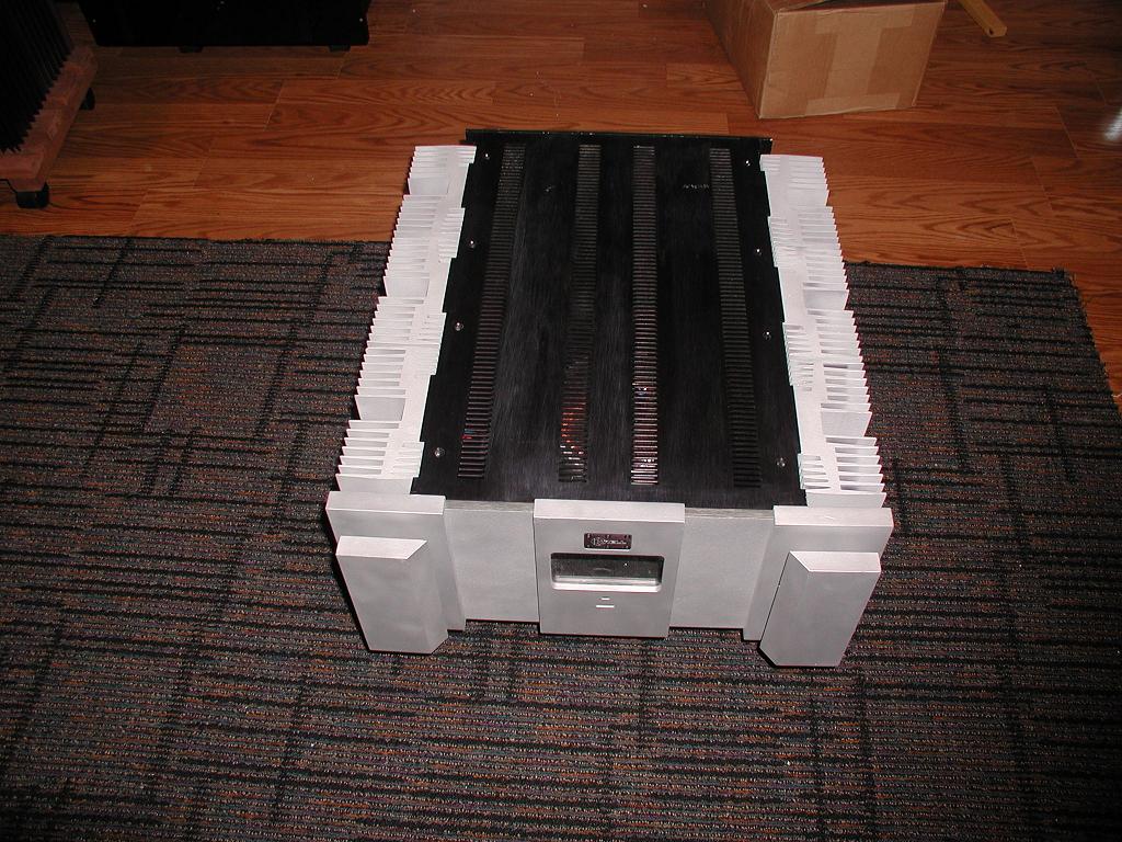

Yea... I have the gerber data to make those boards if you don't have it. Lots of complicated transistor matching to do for that amp and the fets are also hard to get. PCB's would be fairly costly per set... Modding an existing amp would be far easier... Typically 1200.00 to 1800.00 to buy and oh that nice metal work Krell did for those amps that would cost as much as a complete used amp to duplicate. Making a KSA 160 out of a KSA-80 is very easy and KSA-80's are more common.

There are a pair of KSA-160s on Agon now. $3900 (ouch)

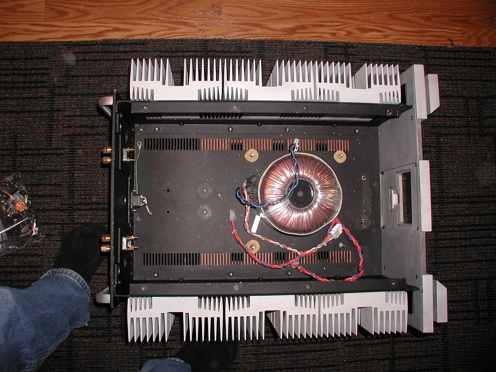

I have a gutted KSA-300 chassis that I am planning to put a pair of KSA-50 amps into, or a ICEPower module with the KSA-50 for biamping. That chassis went thru hell and back when I got it (amp literally burst into flames with previous owner) - sandblasted it and anodized it black a year ago...

I was fortunate to have a nice KSA 80 fall into my lap a few years ago. It sat neglected for a while, after it started popping and thumping loudly in one channel. After letting it lay idle for a year or more, I brought it into the factory with me one day, and had one of my techs look it over (I am too lazy to get in there myself…). When he opened it up, a bunch of micas came falling out like discarded termite wings. All the plastic fasteners holding the driver and bias transistors to the common heat sink had crumbled, and some of the parts were leaking to the blue metal strip that serves as a heat sink.
We replaced the errant hardware and insulators, and the noise was gone. I haven't reset the bias- the amp is running a little cool at the moment, and one channel is slightly cooler than the other. But it still sounds excellent!
