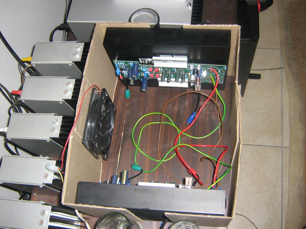

I am going to order the metal for the enclosure in the net week. I had a tube phono riaa circuit i needed to finish before getting back to the ksa 50.
I also bought 2 toroidals at a good price on the swap forum about 5 weeks ago , these where only shipped on the 20th from the UK ,so i am waiting for them.
Most of the metal cutting and bending places close around the 15th of December until 10 Jan so I need to place my order in the net week to get it before closing time 15 Dec.
The attached picture shows you an idea of my enclosure design tested. And also the pdf is the autocad drawing i am busy with for the metal house. I will use 3mm brushed aluminium natural anodized.
with my +-35V and 120mm 12v fan running at around 70 % speed i got a nice 41C heatsinks. With no fan they krept up and up hitting 60C in about 10 to 20 minutes.
The autocad drawing shows the two heat sinks in green and also the two toroidals en 4 capacitors i will be using. Size of enclosure 470mmx220mmx280mm.
I will use 6mm threaded bar to hold everything together as i have been using with all my other enclosures.
