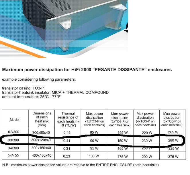

Hello all,
I am quite familiar with this thread, but new to post. I got the bug up my *** to build a Krell clone and purchased a set of Pinkmouse boards and BrianGT Power supply board (don't think I will use the PS board since I have all the separate components)...I should have read a little deeper into the WIKI before purchasing the enclosure (wasn't cheap with shipping to the states)
Anyway, I wanted to put the amp in a nice chassis and purchased a 3U Pesante Dissapante chassis from hifi-2000.
Anyway, I just received the attached data (with pic of nice looking chassis) regarding the heatsinks and their documented cooling rating and think i may need a beefer heatsink.
Before I change direction and buy a new chassis/heatsink, I thought I would post here for a final opinion...The data sheet does say the ability of dissipating 280 watts both heatsinks with six T03-P on each heatsink - Each heatsink is .41C/W -
Planning on dissipating 140W per channel to be within the 280W total.
When I work backward from the 25C ambient, the .41C/W cooling rating, and the planned 140W dissipated, I get 57C change, which is way hotter than I have been reading here - am I calculating this correctly?
Why would they post a possibility of 280W if the six TO3-P transistors had to run at 82C? Is this an error on their assumption of a transistor reliably running this hot?
BTW - I am leaning toward the 2SA1943/2SC5200 as transistors, single 25-0-25 500VA - 700VA Tranny and (hopefully) driving 4 ohm Magnapan MGIIIa - maybe 50W class A not enough power, but maybe planning a different set of speakers if the maggies don't work out)
Sorry for the tyro-ish question, but just want an opinion before I render this beautiful chassis to a 6 channel Gainclone amp.

They do look a bit underwhelming for that rating. I see two options, run the amp with lower bias, or see if you can get hold of some meatier heatsinks that will fit that chassis.
