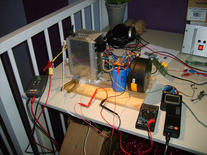

So, now I've finally placed an order for the small signaltransistors and hopfully I'll be able to pick them up later today. Tomorrow begins the not-so-funny work of desoldering the old ones from the board. I just hope that I'ts only the MPSA-transistors that are at fault.

I've spent the afternoon dismantleing my klone and placing all components on a bit piece of wood to make the troubleshooting a bit easier. Later I looked at a bookmark and noticed a thing in Post 6120 by pinkmouse.
To specify:
main board power ground AND main board signal ground. I must have seen wrong because I thought that those two where connected on the board and because of that I only have one groundwire running from the powerground to starground. The signal ground runs from the RCA-socket to the board but it ends there.
To specify:
PSU grounds, bridge grounds, speaker grounds, driver board ground, main board power ground, main board signal ground.
