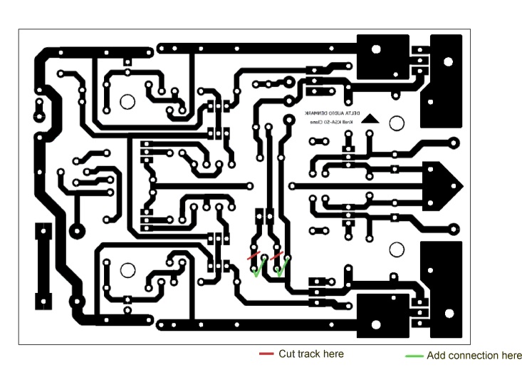

Sadly I have to admit that you're right in your observation
I had two 10-turns pot in my lib. and have obvious chosen the one with "wrong" pin-configuration 😡
On Jan's schematic one endpin from a pot is connected to the wiper of that pot, the other endpin goes to Q108.
On the PCB layout the two endpins from each pot are connected and the wiper goes to Q108.
I looked at the datasheet from the cermet bourns pot, and the middle pin is the wiper.

A short note on the fix please.

Thanks for the fix! I was looking at it thinking it didn't look right, but let it slide as i'm not to the stage of setting it up yet! haha

Thank you for the super fast updat on the fix!

Hey Jan-
You drew the schematics and designed the PCB's.
Then you POSTED for ALL to critique.
If anything is wrong, it is ALL of our fault for not catching it. And anyone can suggest fixes to problems found. It is NOT just your responsibility!
This was/is a GROUP design and purchase. We all have responsibilities.
But thanks anyway for the quick suggestion on the fix!

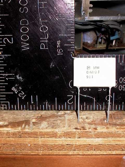

I have hundreds of panasonic 10w, 0.68 resistors, they are about the size of a stamp, and maybe 3mm thick, about 1/4oz each. If you want a sane number, like 4/8/12 whatever, send me an email, I'll give you my address, then you send me a postage paid envelope, to wherever you want them delivered. You can do the math to get the weight, packaging, postage right etc, other than that they are free for the asking, assuming you bought boards for the ksa50...or contributed to the thread, before this posting of course...
