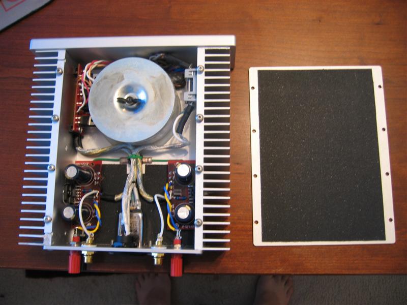

I would like to use the TO-3 style but I know the TO-220 will be easier so I will most likely go that way. Also I will be having a chassis built for mine. It will be a vertical chassis similar to the ML #33 but heat sinks only on one side. I will draw the chassis and get an estimate from my machinist next week hopefully. If anyone is interested it will be VERY easy for him to do a run of more than one.

Do you have the estimated cost of your chassis now?

I would like to use the TO-3 style but I know the TO-220 will be easier so I will most likely go that way. Also I will be having a chassis built for mine. It will be a vertical chassis similar to the ML #33 but heat sinks only on one side. I will draw the chassis and get an estimate from my machinist next week hopefully. If anyone is interested it will be VERY easy for him to do a run of more than one. [/B]
Hi rabstg,
yep, I am talking about using mjl21193 and mjl21194.
They are in TO-3 package, right?
I just wonder how much your chassis cost.
