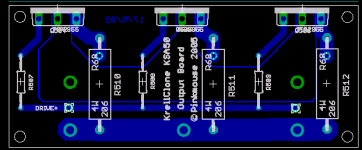

lgreen said:
WHOA! I see that the feedback circuit connects to a number of circ componets. I think you need to use the feedback circ even with no protection (300 series numbered components) installed.
Have I got this right or is FB not necessary with no protection components installed?
I don't think I got an answer-- do you need to connect the output to the FB point on the driver board if you don't use any of the protection components?
Of course you do !
This point is not only the feedback connection from the output, it is also the output of the drivers.
The driver emitter resistors are 25 Ohms, this is a low value for drivers.
The drivers deliver part of the music signal too, and they are better at it than the output devices, one of the reasons why Dan the Man picked such low values.
The other half of the entrance of the amplifier needs a reference voltage from the output.
If there is 1 volt on the input of the amplifier there is 1 volt on Q101/Q102.
If the amplification works ideal there is 1 volt on Q103/Q104 too , coming from the voltage feedback.
Suppose the amplifying job is bad, then there will be a higher or lower voltage on the base of Q103/Q104, again because of the feedback.
This leads to Q103/Q104 opening/closing, because of it Q101/Q102 will have more/less current, and amplification changes, in result the output signal is forced to follow the right path.
Without making the connection there wil be no feedback, without feedback the Krell will be a true alien ! :clown:
Al, have a look at the picture. Isn't that plane not a bit to close to the transistor pins?
