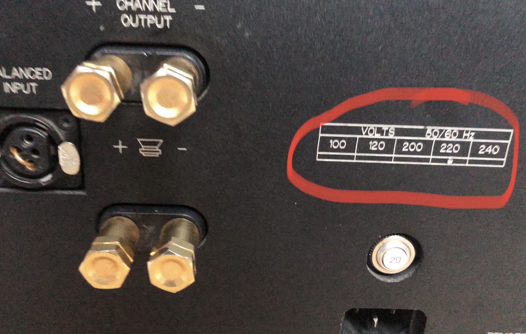

This one is clear and i thought i explained it already: the amp was imported from the US and in order to make it compatible with 50Hz mains the micro was replaced with an emulation. It does only basic housekeeping inside the amp and checks the frequency. If the amp powers up and the front indication works the Atmel does its job. Apart from impossible to replace, there is also no need. And yes, the Atmel clearly does not check the frequency anymore 🙂

I do not know where this amplifier comes from, but it is from the factory 220V 50-60Hz. I repeat, this chip works, but I want to remove this hand-made chip and put the native chip or its analog to solder it into the native circuit, and remove this red one. If you find a new chip or an analog, do you need to program it?
