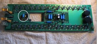

I am making a list of caps needed to order for my version 2 KSA-250, but cannot see the value of one that is buried between the boards sandwich.
It is located on the driver board towards the rear. It looks smaller in physical size than the other radial caps populating the board so I figured the value might be different than the rest. I circled the cap, wondering if someone can can provide the correct value.
Thanks!
Thanks!
